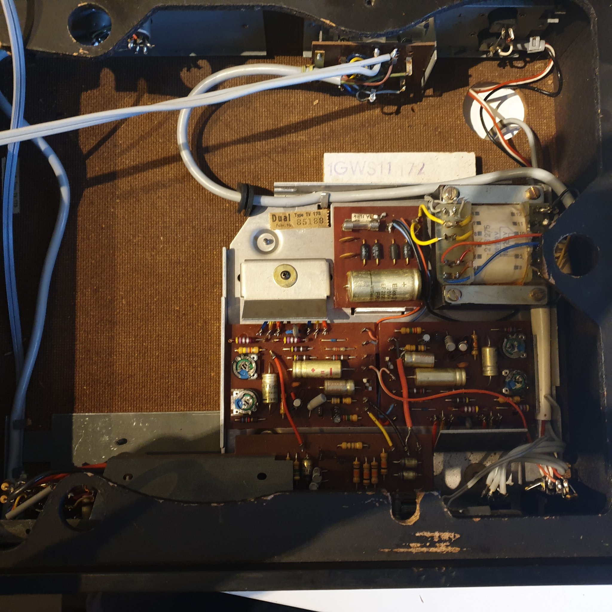

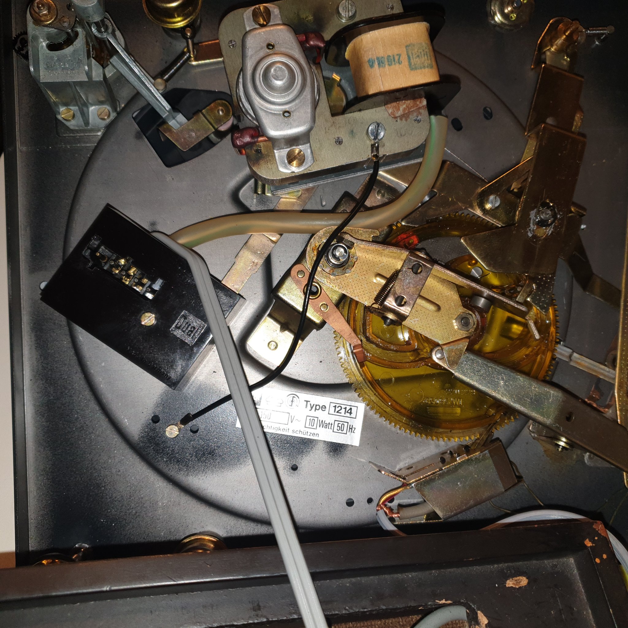

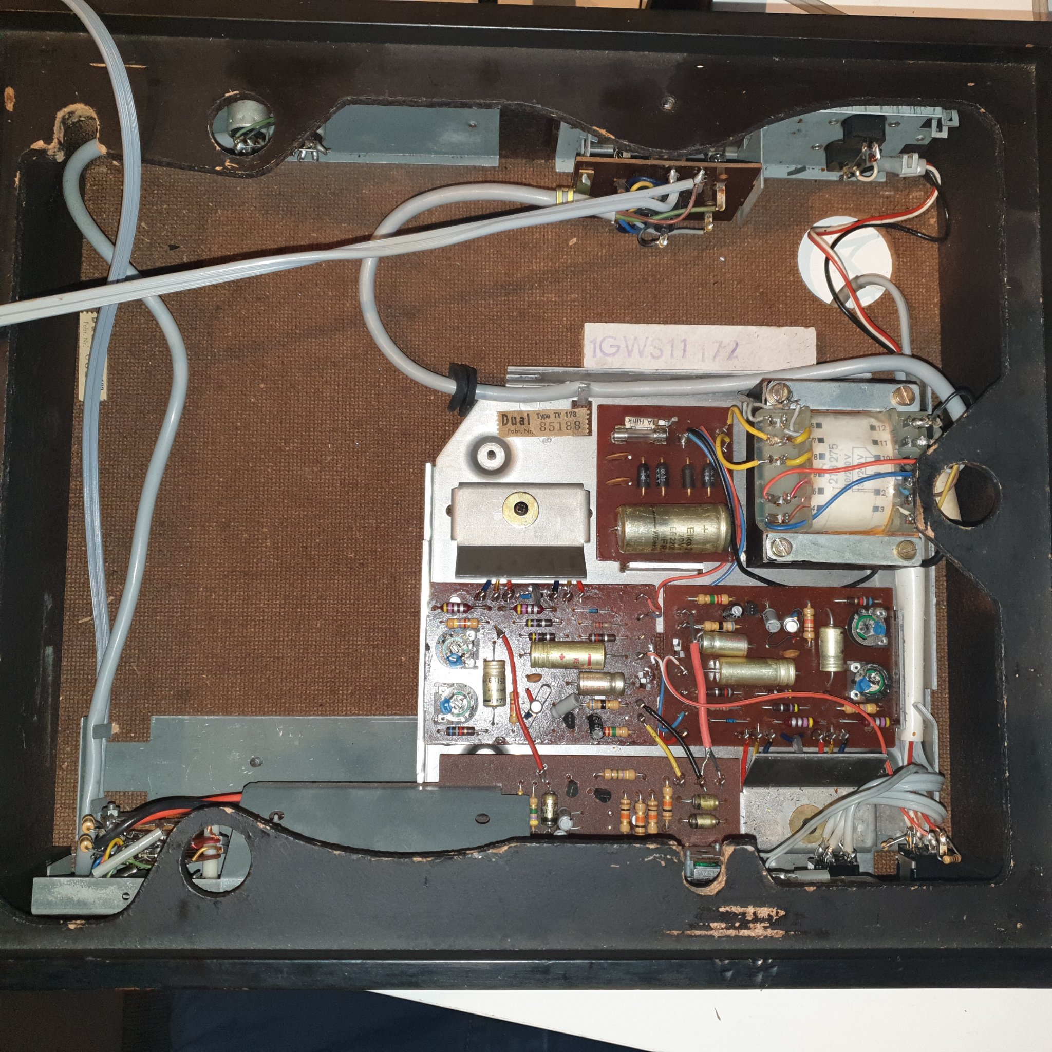

Yesterday I started removing the old hardened lube from my Dual 1214 with some WD40.
At this moment, my dual had power and the red indication light turned red. It was also spinning.
The next morning when i was planning to relube the components, my dual didnt get any power and obviously it didnt turn around.
I cant see any damaged components and I replaced the correct fuses without any succes. Ill leave some pictures below.

Here's the service manual, albeit in German. Check capacitor C17 (better replace it by a 47 nF 275 Vac class X2 one) next to the mains transformer and the 160 mA slo-blo mains fuse. Or get a mains bulb tester (100 watts incandescent lamp) instead of the fuse first and power the unit on.
Btw, 1214 is just the record changer. The unit is called HS 37.
