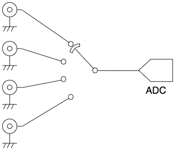

Some extra info on input and filter options. My initial idea was to use an input switch like the one in the picture below. The easiest option would be a mechanical switch but I envisioned relay based switching. I therefor implemented support for logical radio buttons in the RPi-Sidekick but each input pin would also need at-least another output pin driving a relay. It was limiting my other options so I eventually scrapped the code (along with a generic support for rotary encoders)...
Another thing to consider is the type of signal the ADC is supposed to be used with (turntable, tape deck etc.). The current implementation of DSPreamp provides 0 dBFS to CamillaDSP from the ADC @ 88.2 kHz. I wanted to get rid of a separate RIAA amplifier in the sound chain and try to implement the option of digital RIAA filters insted. The filter coefficients for the biquad is for 88.2 kHz (and they are a function of the sample rate) and the RIAA EQ error is as low as 0.008 dB. The filter coefficients produces a bit gained filter, around +12.5 dB, this has been compensated for in the DSPreamp code.
The RIAA filter is intended to be used with a three way (on-off-on) toggle switch (like a lot of the other filters in DSPreamp). One "on" goes to the MM GPIO pin and the other "on" goes to the MC GPIO pin. The switch in "off" state will result in a defeated RIAA filter, e.g. line level in. The same goes for example tone controls. E.g. the on-off-on switch goes to treble turnover fq. One "on" to high fq. turnover, the other "on" to low fq. turnover, the "off" state then defeats treble controls. The same for bass control and you got individual defeats for treble and bass. The same for high and low cut filter and so on. The different input options does not have to be wired this way. Shorting the MM RIAA filter GPIO to ground would make the MM RIAA filter permanent on the analog input for example. I hope you get the idea...

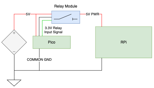

Some extra info on power management. This might be obvious to most but please make sure you got common ground between the RPi and the Pico, and also make sure not to draw too much current from the GPIO pins (for relay or status LED). This is how power is intended to be wired between the Pico and the RPi.
The Pico is switching the RPi power on and off and is also signalling to the RPi to shutdown via the gpio-poweroff overlay and sensing when the RPi has shutdown via the gpio-shutdown overlay. Serial communication wires, wires for gpio-overlays, power switch and status LED has been omitted in the picture. For documentation of wiring please refer to RPi-Sidekick.
As of the GPIO output load - have you considered using mosfets instead of relays? E.g. https://hackaday.com/2015/09/16/learn-and-build-a-high-side-switch/ Typically it's also cheaper and higher reliability. Also for switching analog inputs integrated analog mosfet switches are usually cheaper and easier to operate, unless absolutely top-performance is required (like in audio measurement devices).
But hats off to your project!
Yes I have, many times, but I always end up with a bunch of micro relays because of the performance benefits (but I doubt I would be able to hear the difference in a blind test). And thanks for the compliment :)
