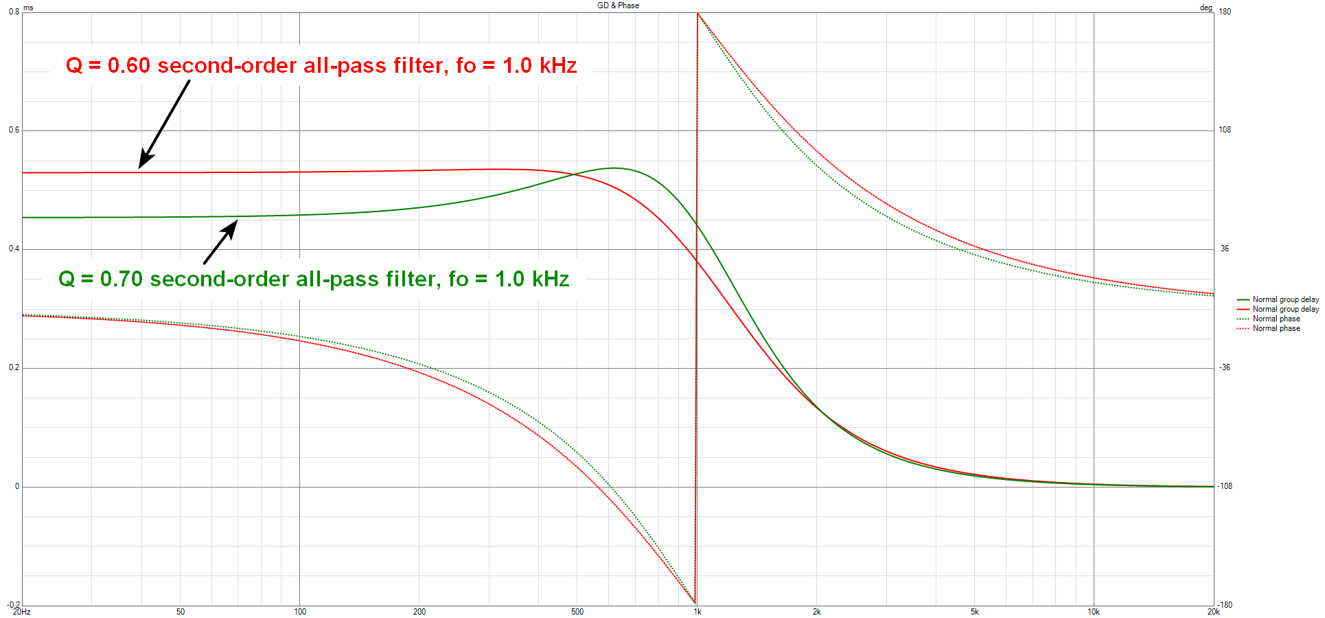

To illustrate the above, the group delay and phase response curves for a 2nd-order all-pass filter with its frequency set to fo = 1.0 kHz are plotted below. Here fo is the frequency where the output is 180° out of phase with the input. The red curves corresponds to Q = 0.60, while the green curves correspond to Q = 0.70.One way to think about all-pass filters is this: they produce frequency dependent delay, with the "shape" of the delay being sort of like a lowpass filter is for amplitude. First and second order all-pass filters behave WRT delay just like their LP cousins behave with amplitude, such that the second order AP has a Q factor and this impacts what happens at the "knee". This is how I like to explain AP filters 101. There is some more to it but IMO it helps people understand what the filter is doing more than e.g. talking about the phase response of an AP filter.
It is evident that the Q = 0.70 setting produces significant peaking in the group delay curve. The group delay results for Q = 0.60 are much flatter, with just a minimal amount of peaking.
From the above results, if one requires a nominally constant group delay over a 1-octave-wide frequency range, it will be necessary to ensure that the tuning frequency fo of the all-pass filter is set significantly higher than the centre of the frequency range of interest.

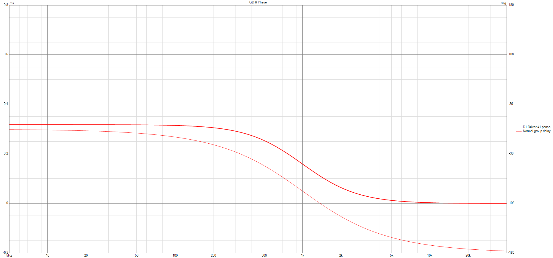

Below is a first-order all-pass filter's group delay and phase response with fo = 1.0kHz. Here the phase shift at fo is only −90°. The group delay at low frequencies is about half of that which was produced by the second-order all-pass filter.
