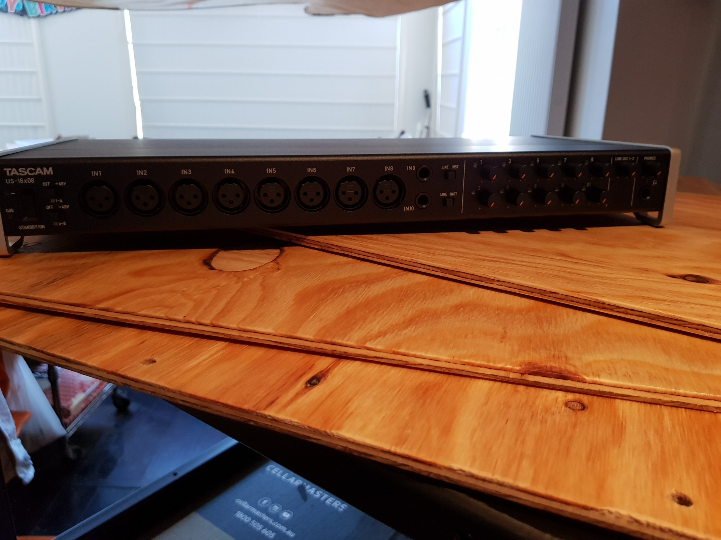

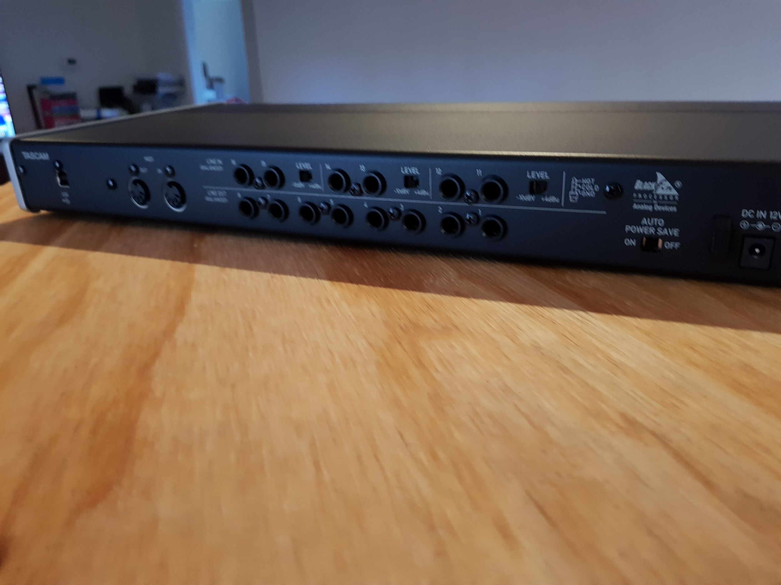

Hi Guys
Saturday 7:30am and the Tanscam US-16x08 is here....yippie. As for most things it is made in China, but what surprised me was it is a Teac product.
If I may ask Smaz for some help with the software.
I am feeling very relieved, as, I got this message from a musician:
“Use this as your audio interface (Digital to Analog converter) and since you were wanting multiple outputs, I don't think you could have bought anything else that would have worked without buying 6 items or so.
So, the software that the unit comes with is all you need. You will want to use that software to assign which signal goes to which output. In windows, you would just want to make the TASCAM your primary audio interface.
All cables should be analogue, not digital. I would use 1/4" TRS to XLR M for the signal from Tascam to preamp. If not going with a snake I would use the forte or the lyric hg from evidence audio.”
