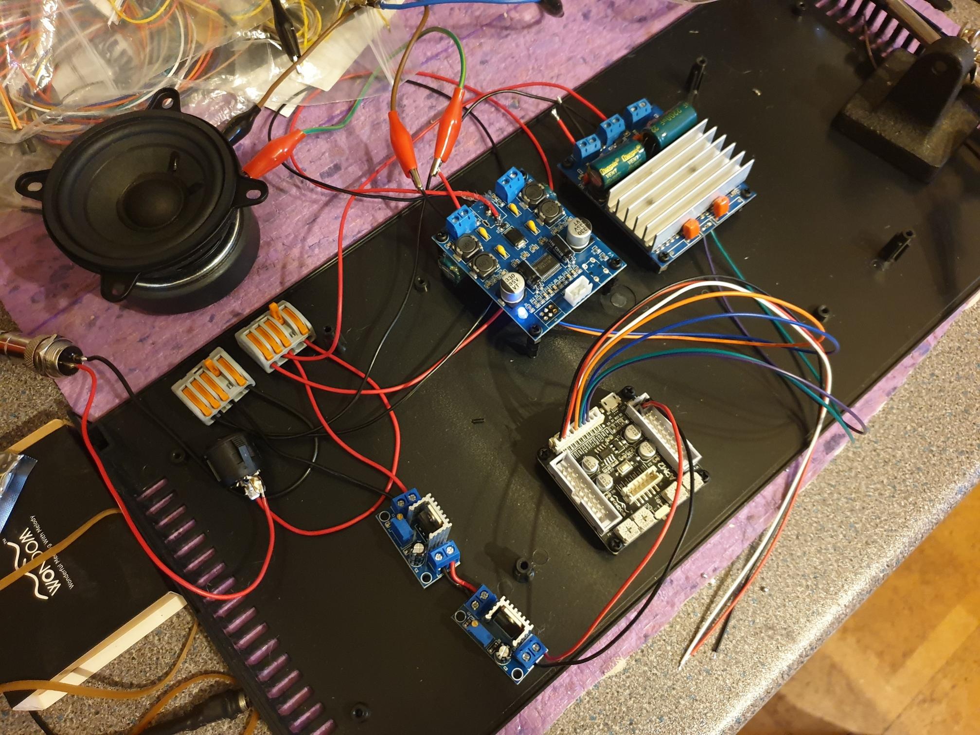

I wonder if you guys might be able to help and guide me to getting this system working properly, please?
I am trying to put together a bi-amp crossover for a pair of two-way speakers using one PSU with the following:
It functions but is terrifically noisey. There is a high pitched tone and lots of hiss. I have used both of these boards succesfully before and have used this actual TDA7492 board for my kitchen speakers so I know it should be quiet.
What have I done wrong? I am really hoping to not have two buy a second ADAU1701 to make it a balanced set up but will if needs must.
FauxFrench (who is always very helpful) indicated that using these two amp chips together should not create beat tones as they run at different frequencies but it does sound like that, perhaps these boards have been coincidentally designed in a way that makes them clash?
Perhaps buying another of either and syncing them is a better option? It would be a first for me.
I have drawn a rough diagram of the circuit, apologies for the crudeness, I am not an electronics engineer! Also, I did it on a bumpy train.
Red is voltage
Yellow is audio signal
Please let me know if there is anything else that would help in diagnosing this! 🙂

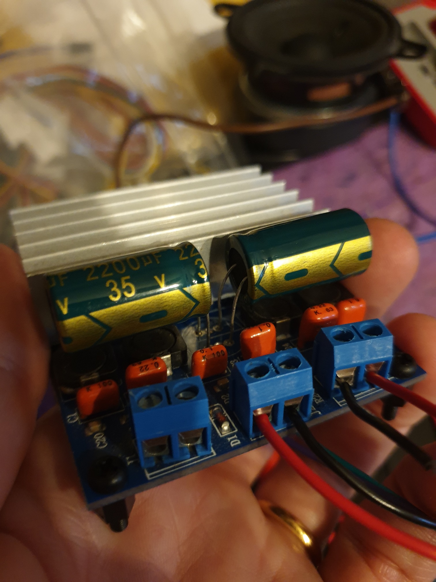

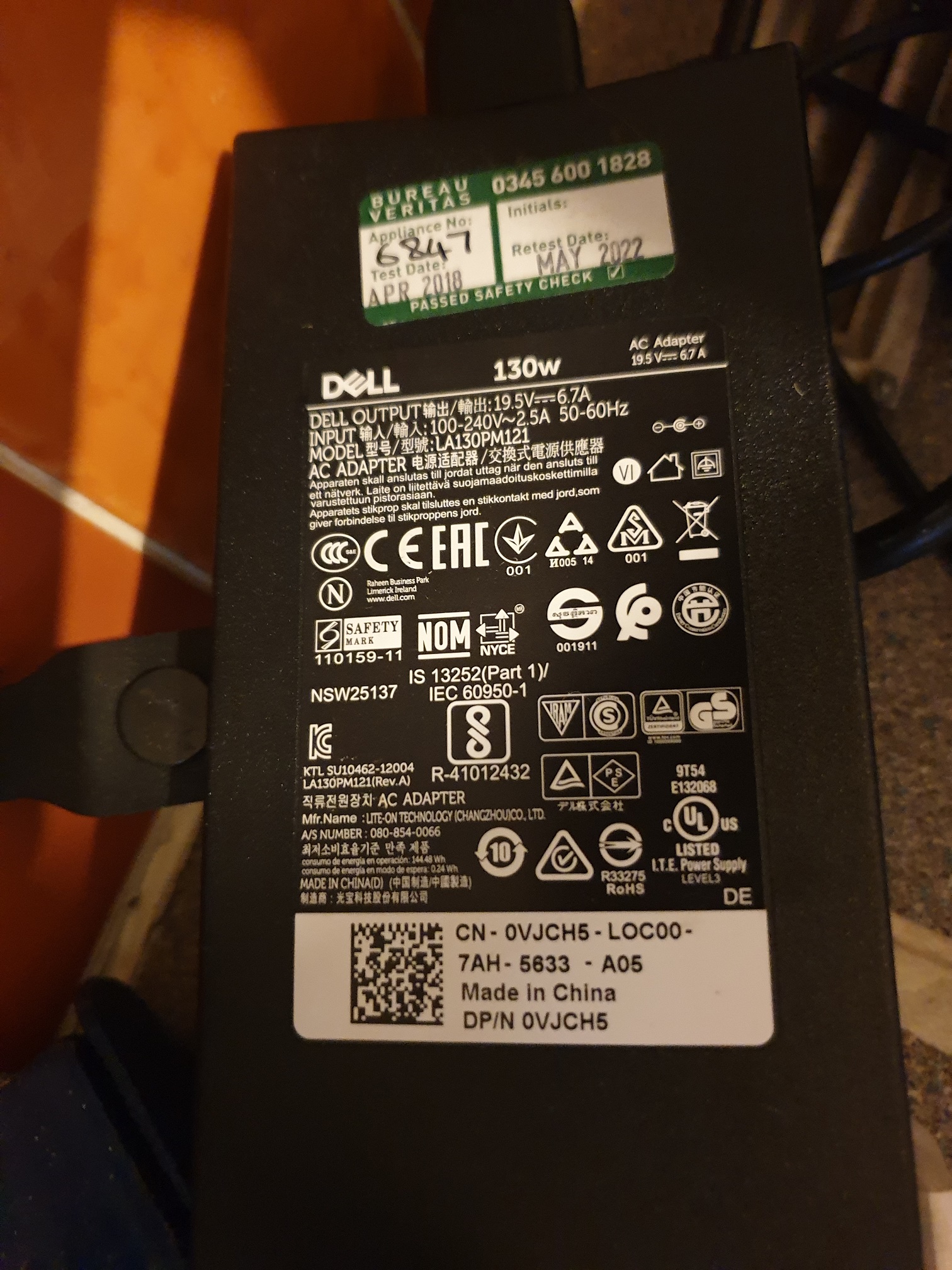

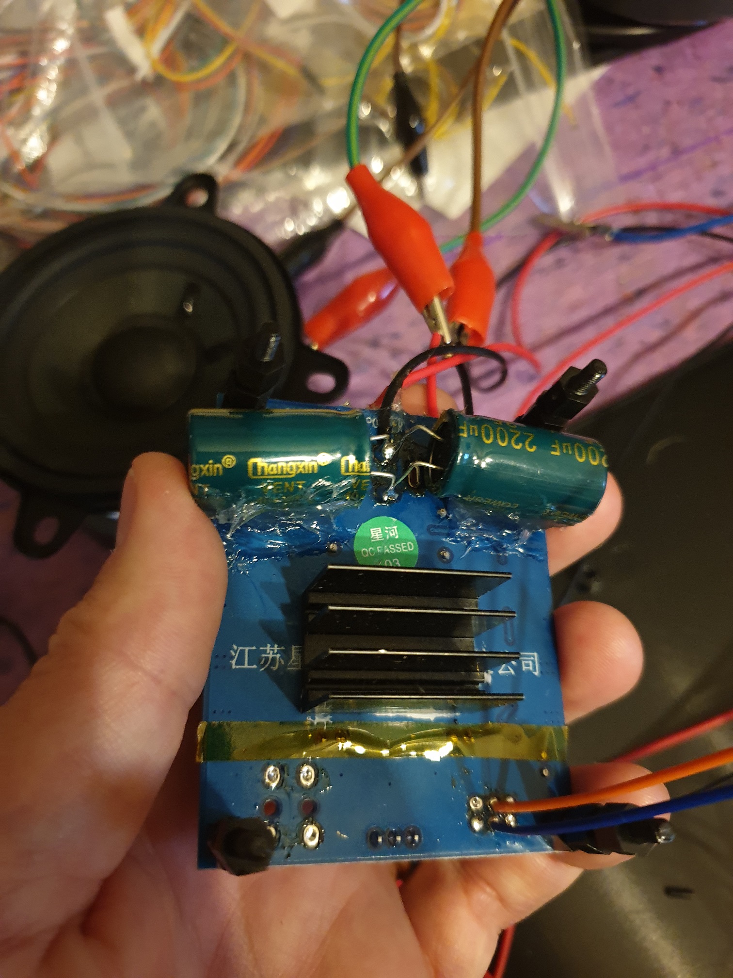

- Sure ADAU1701 DSP board
- TPA3118 board with two 2200uf capacitors across the voltage in and input gain is set to 26db
- TDA7492 board with two 2200uf capacitors across the voltage in and input gain is set to 27.6db
- Dell 19.v / 6.7A laptop PSU
- Two LM317 boards to reduce the 19.5v down to 5v (two to help with heat dissipation)

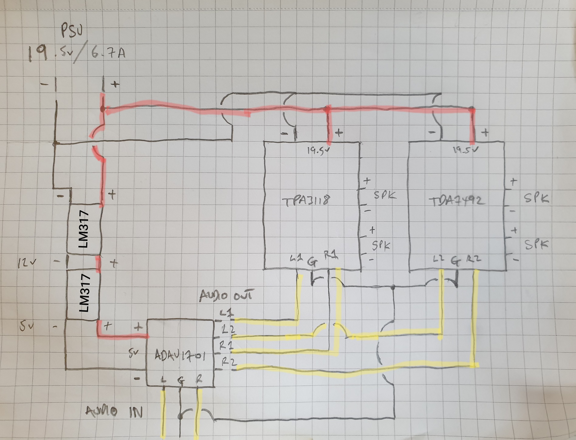

Red is voltage

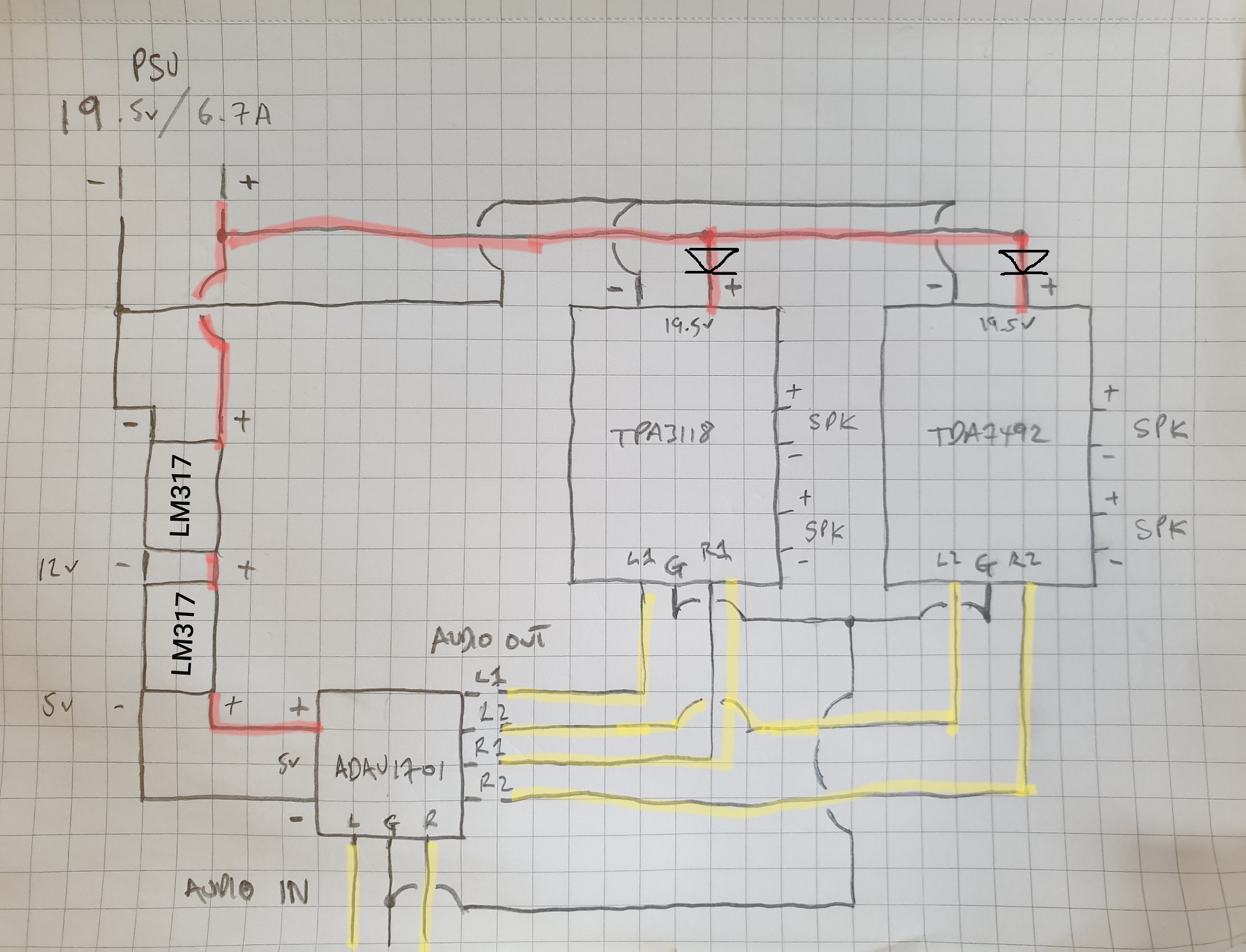

Hmmmm, perhaps separating the boards from each other with a diode on each positive line might help?

Ok, a lot of the noise was stopped by using a separate psu for the dsp so I need to isolate its power supply.

You have constructed the perfect ground loop. Take a fat marker and follow the ground path, you should see it. Cut the ground between the ADAU and the amps, should help a lot!
Brilliant, thanks! I feel so daft!
Just need to locate the faint squealing that remains now! Any thoughts?
As I do not know your whole set-up, basically, no.
I have sometimes experienced funny noises if voltages got too low, which lead to "squealing".
To locate any noise, the only way is to take away and add components, exchange etc. until you find a rule for your acoustical problems. Sometimes moving components gives strange results. In the end, your electronics decide what is right or wrong, if it does not match with theory, so what if it works.

Exactly! I wish Sure published the power requirements of this board, I' not sure it will run on a 1w 5v DC-DC isolator.

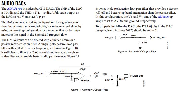

I don't think there is an output low pass filter on the Sure DSP, it may help to add one, passive version should be sufficient. There is one built into their extension boards but not on the DSP itself:
Interesting! When I used it for my bluetooth speaker I ran the 4 outputs as stereo balanced and didn't have this problem. Would that change things when single ended do you think?

It's possible things could change, more likely due to what's in the signal chain, I would approach it as previously mentioned if you haven't already and strip it all down to bare minimum and build the circuit up from there, checking at each stage for any problems.
I will be doing that tonight.
Are there any particular types of capacitor or resistor I should be using to try the output filter?
Polyester or polyproplene film caps are cheap and readily available, avoid ceramics and electrolytic, for resistors, any non wound resistor, I have a selection of 1/4 Watt thin film 1% resistors, but not too critical.

Am I going odd or is 47uf a very large capacitor?
47uF is a huge film capacitor.

That's a dc blocking cap, I think that is on the board already, it's the 5.6nF and the 470 Ohm that you may need to add.
Before you start to build complicated filters, just re-check the wires, they will, to 99%, be the problem.
First, use one point for grounding all boards.
If you use screened wire for the audio line from DSP to amp, only ground one side of the screen.
If there is still noise, connect a wire to the ground points and very carefully try to hold it to round terminals of the components. Sometimes, you need such an additional ground wire, that is NOT simply connected on the board. In other words, some boards MAY need a second wire to the central ground point, which would, on first sight, produce a ground loop.
If we had correct schematic´s of all boards, we could solve such problems in theory. As sad as it is, our Chinese friends are unable to do schematic´s, seems to be some genetic problem in their DNA.
So we have, to some extend, to experiment and waste our time with problems that, in reality, are none.
