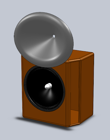

What I'll be trying in a new design will be a WWMTMWW using dipole mids and one W top and bottom cardoid leaving the intermediate W as bass reflex. I'm building a new set of test cabs for woofers now with removable sides to try different vent sizes and patterns.
Has anyone seen Amphions choice of a triangle shaped side vent? I 'assume' they did some extensive research to arrive at that shape.
