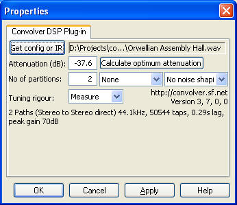

Its been awhile since I used it but the version I used had a user defined value with no limit that I can remember:
Convolver also had a config file setup option where you could specify the number of partitions amongst other things.
