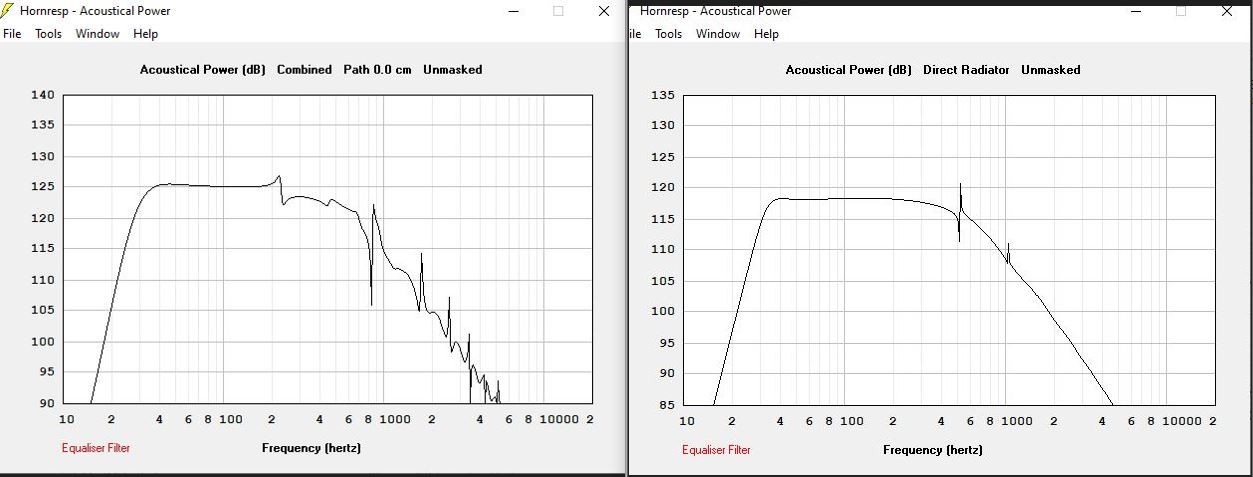

Here's same driver in same size box, but sealed now and using a 19Hz, 2.1Q, -19dB shelf. And is the only filter being used.
It's the power screen on the right. The left is the ported version previously posted, for comparison.
So sealed cost about 7dB for close to the same f-3.

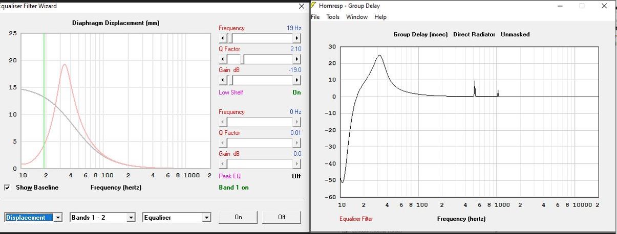

Excursion and group delay for sealed.
I'm getting more and more convinced, that when bottom end acoustic rolloff is the same between sealed vs ported...well, the dang subs are the same.
The size/width of the knee is as important as the rolloff below the knee, I think.
When knees and response below match perfectly, sealed will have no more of an advantage with group delay than ported.

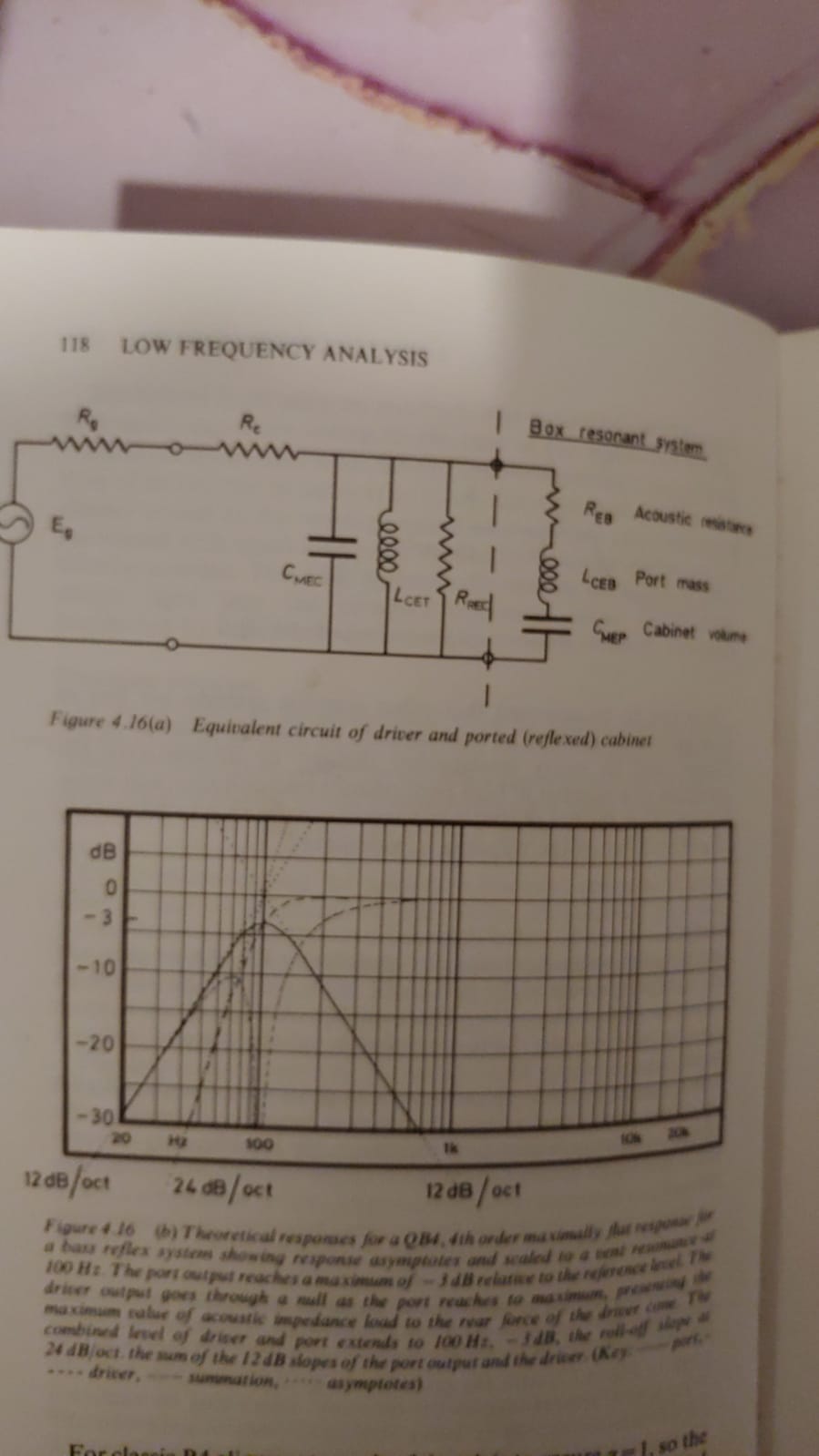

The sum is minimum phase but the no delay?I take sheeple's point that if the port were far away, and the box large enough to be modal then it could change.. of course normally this is not significant. That said...
The driver works on the box straight away, and so does the box on the port. They may be out of phase but there is no delay. They are minimum phase.
The box compliance and port mass behave as bandpass filter working in parallel with the filter representing the driver which are summed external to the box.
Below box tuning the output of the port approaches zero delay, above tuning the box compliance and port mass invert the phase.
To achieve this the box first has to compress to then get the mass moving which takes time, once moving the box has to decompress before it can act on the mass to reverse its direction of movement. The output of the port is therefore delayed.
So at and above port tuning and starting at t=0, the first half cycle is output from the driver only, the port has not had time to get moving.
The implication is that the initial half cycle will produce less SPL overall at and above port tuning than the following cycles (steady state signal).

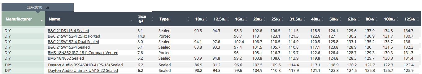

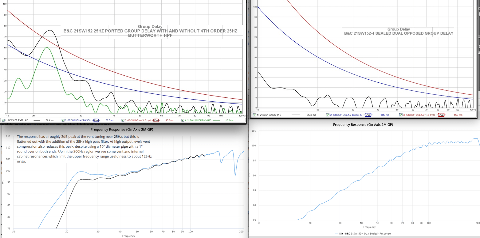

https://data-bass.com/#/systems/5b11bfe651412e00047d6693?_k=re5awp
By 50 Hz the group delay of the BR has dropped to near that of the sealed box.
Adding a 25Hz BW24 filter then adds another 15ms at Fb, the group delay still dropping to that of the sealed system by ~ 50Hz.
You say that the virtue of the shelf filter is it has 25-33% of the phase shift the BW24 filter adds at Fb , so could reduce the 15ms delay to ~ 3.75ms.
So, using the “least compromised” shelf filter (which won’t provide the out of band protection of a BW24…) the 75ms group delay could perhaps be dropped to 63.75ms, “a different date” .
I’m glad that a tiny fraction of one cycle difference at 25 Hz does not sound like a “a different date” to me, though do wish my hearing and sense of timing was better...

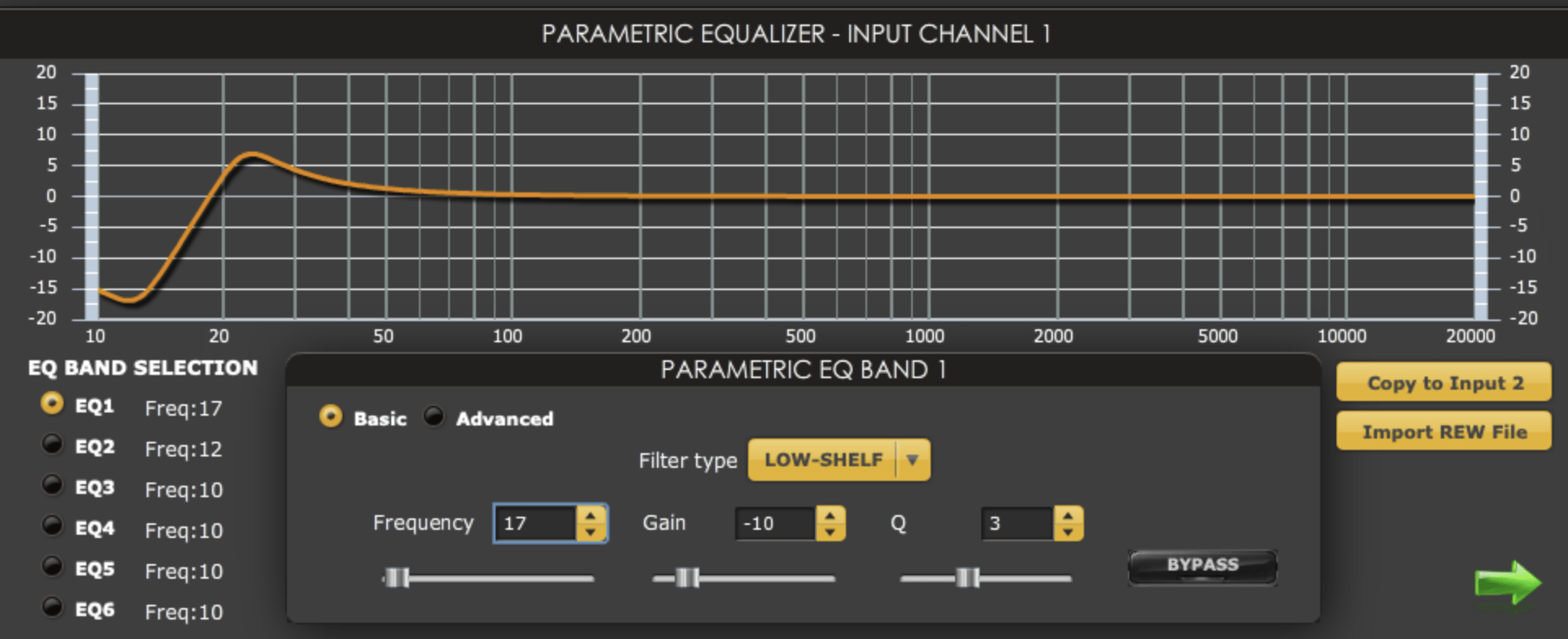

This is a 10dB shelf, Q = 3, notice the drop between 25Hz and 13Hz is 24dB, and flattening out at -10dB at 5Hz and below is just enough to do the job. In a home stereo there's no music material that low. Probably much different in a PA system, where microphone pops might go down to DC :^>
