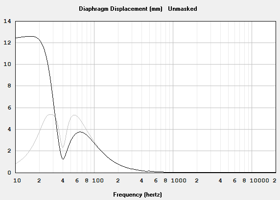

I tried to make some simulations in Hornresp and using this kind of EQ seems to do what I need for the SPL levels I need. I especially like the excursion control without using a real high order subbas filter.
The article mentions using a shelf filter in MiniDSP (I actually happen to have one), but AFAIK, there is no shelving filter in Hornresp. So I used two peaking filters, one to boost and one to cut plus a first order highpass to approximate the high Q shelf filter. Is that equivalent, or is the shelf filter better in some regard?
I would like to first see in Hornresp what is possible before I start cutting wood, the final filter would be of course based on measurements. Am I on the right track?

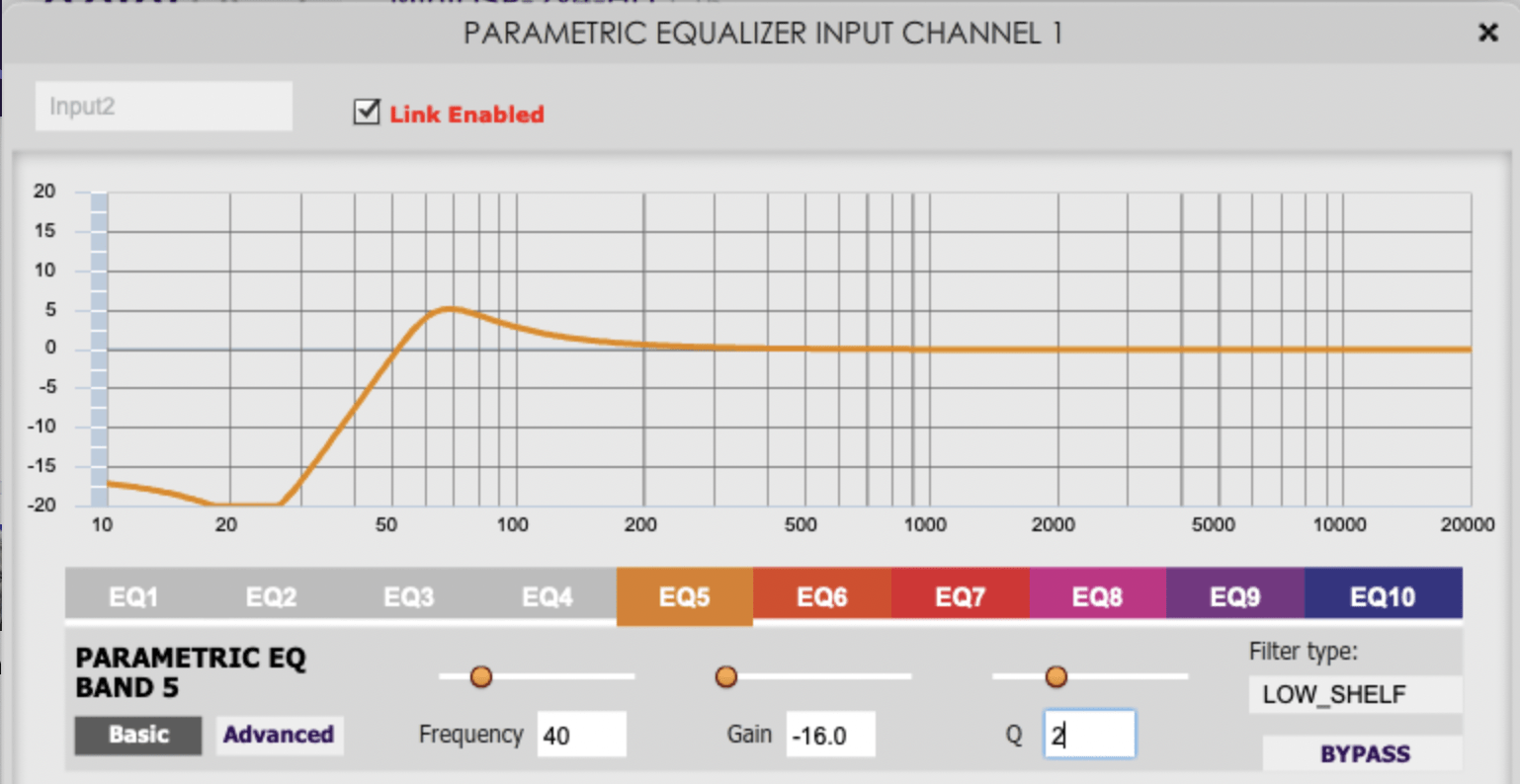

I have just checked and it does - Q adjustable from 0.5 to 2.0. It also does have 4th order with the same Q adjustment range.
Above is a MiniDSP 2x4HD 40Hz shelf filter, -16dB, Q=2.
This curve is VERY similar to a 70Hz 2nd order high pass filter with a Q of 2. Each gives you a peak of +6dB at 70Hz, and they're pretty much identical above 40Hz. They're mostly different below 40, where the shelf has that symmetry you see and the 2nd order just keeps rolling off.
I prefer shelf filters to 2nd order filters because they have less phase shift and you don't need 50dB of protection below system cutoff; 15-20dB is more than enough. Also, MiniDSP doesn't have a Q setting on their 2nd order filters.
I think the 2nd order filter will be close enough for your HornResp modeling. Run your model, then when you bild, play with the DSP shelf until the peaks align. @pelanj

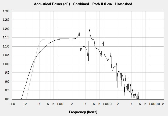

So it seems I have a practical example / test box to build. I have this woofer: https://www.thomann.de/cz/the_box_speaker_122808a.htm Maximum available volume is 75 l including the vent. I ended up with 60 l tuned to 40 Hz, with port area of 200 cm2 (a little more than 1/3 Sd). By applying the EQ, I can get solid 40 Hz at 114 dB with ca 80 W at Xmax, which is already too loud for the room. Or am I way off?

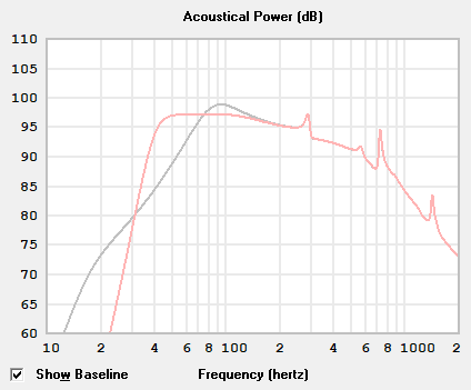

Instead of using the 12", I might actually try 15OB350 in an even smaller box. This is what Hornresp says (50l, tuned to 40 Hz and EQ):

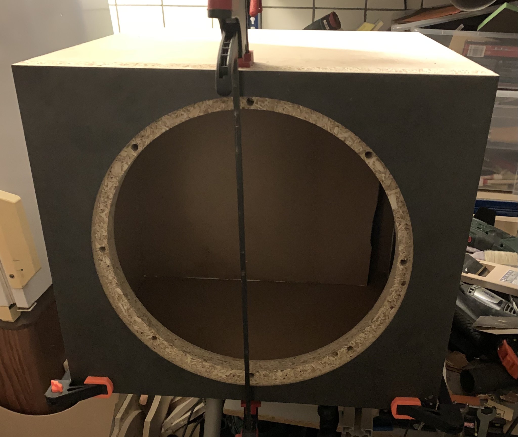

The test box is now WIP. The front panel is CNC cut from kitchen board leftover, the rest from 18 mm MDF. The 15OB350 is not the best woofer for traditional bass reflex alignments, so I am really curious how this turns out. It seems I should have bass down to 40 Hz with less EQ than with a closed box.

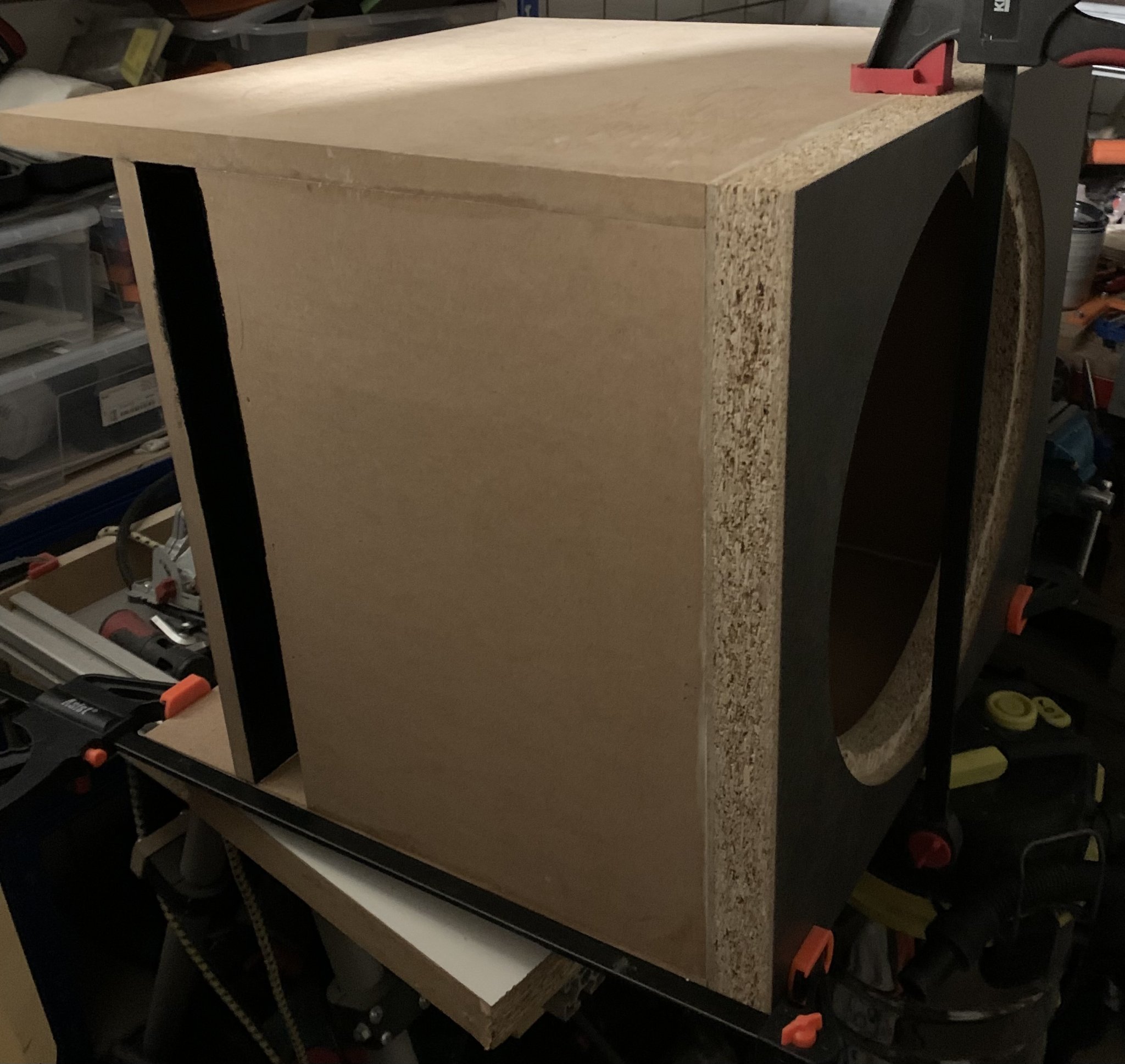

It starts to look like a box. This is the second build using a track saw. I need to practice a bit more, but a track saw is definitely a way to go.
Since it is just a test box, it will get a test finish only. I tried a small roller for the inside black painted panels and it looks better than with a brush.
