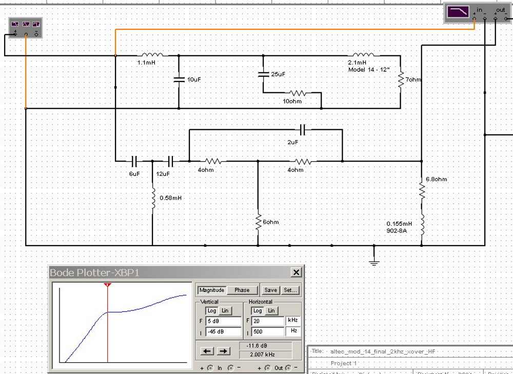

- crossover circuit below:
Thank you for any and all advice, suggestions or comments!

Changing a fourth-order Linkwitz-Riley filter made with second-order Sallen and Key sections into a second order Linkwitz-Riley filter involves cutting out one section and changing a few component values in the other section.
Third-order Linkwitz-Riley filters don't exist, but I've been told you can approximate them anyway.
If you want to make a peak at 1500 Hz, it is probably handiest to build a separate circuit for that. What kind of peak do you need? How high, how wide, or what pole and zero locations or polynomial coefficients if you happen to know those?
I would expect an all-pass filter in a three-way Linkwitz-Riley crossover to make the phase shifts equal, but maybe that's taken care of by the woofer's phase alignment thing.

For the CD equalisation you might find adding a passive 1st order xo (probably somewhere between 5kHz - 10kHz) to the horn may give enough tilt to get into the range of the Kenwood EQ.

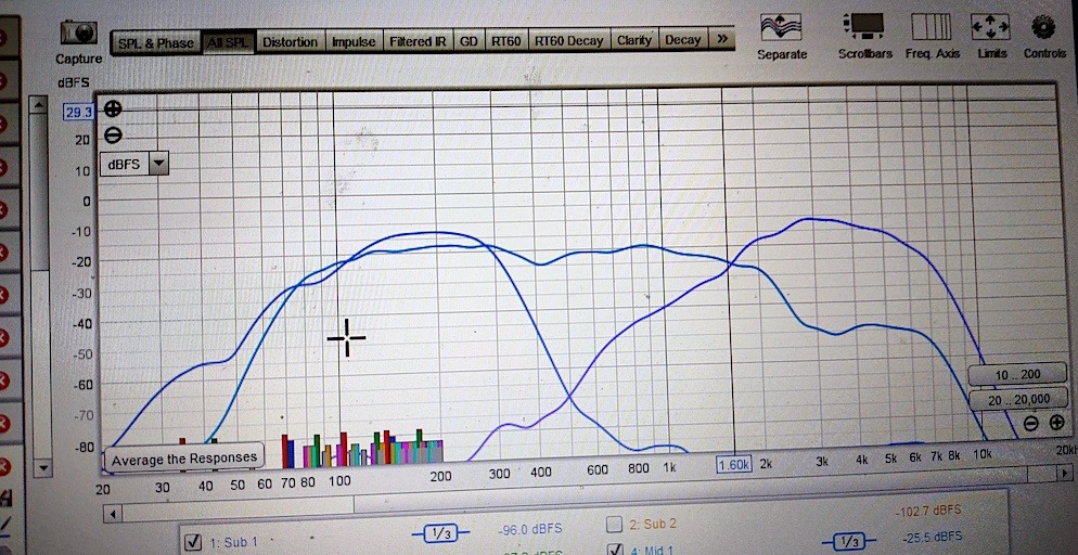

From the REW measurement it's about 8-9db (without EQ) spanning from 1k to 3k (with a 2-3db bump in the middle-ish). About 4-5db equalized. Thinking I should address the uneq'd measurement.
I don't know about the pole and, zero and polynomic coeefficents, unfortunately. Pretty new to REW as well, but will try and figure that out, if that info is there.

I think I do, if I understand what you mean.Do you have any measurements of the raw, unfiltered drivers in the enclosure?
Initially, I measured each driver individually with the only the corresponding amps activated on one channel with the mic a few inches from the center of each driver. (no EQ, not yet level matched when I did these)
Is that what you mean? (sorry for the crappy pic, haven't figured out how to export REW from one computer to another yet)
Or do you mean, sending measuring each driver w/o the crossover? That I didn't do, but there may be some measurements online, I'll see what I can find.

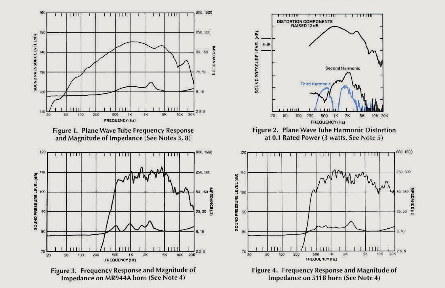

Tweeter specs: https://greatplainsaudio.com/wp-content/uploads/2017/07/902-8B-16B-01.pdf
Here's the frequency response of the horn from the above document. The MR944A on the bottom left is the model I have.
Perhaps the tweeter section can cross over at a below 1500 and the mids staying the same? Don't know enough about xover circuits to know if this is possible.
A passive crossover design for the Model 14, in case it help to have the stock-ish setup. (the person who created this, Richard Saunders added a zobel network, seems to have have vanished online. Hopefully not for bad reasons)

Did find this bit of trivia on the an website from the part 1 of the article via 1st link in post 1...
"Because the CD horn’s high frequencies are more spread out over its coverage pattern, they appear attenuated relative to other horns. The CD horn requires an equalization boost of approximately 6 dB per octave with a filter knee centered between 2 and 4 kHz (depending on horn design) in order to sound neutral and balanced. Most manufacturers of active electronic audio crossovers responded to this requirement by adding an optional CD EQ boost filter or high frequency shelf filter. Further refinements of the filtering process are available in DSP-based crossovers such as the dbx DriveRack PA2."
