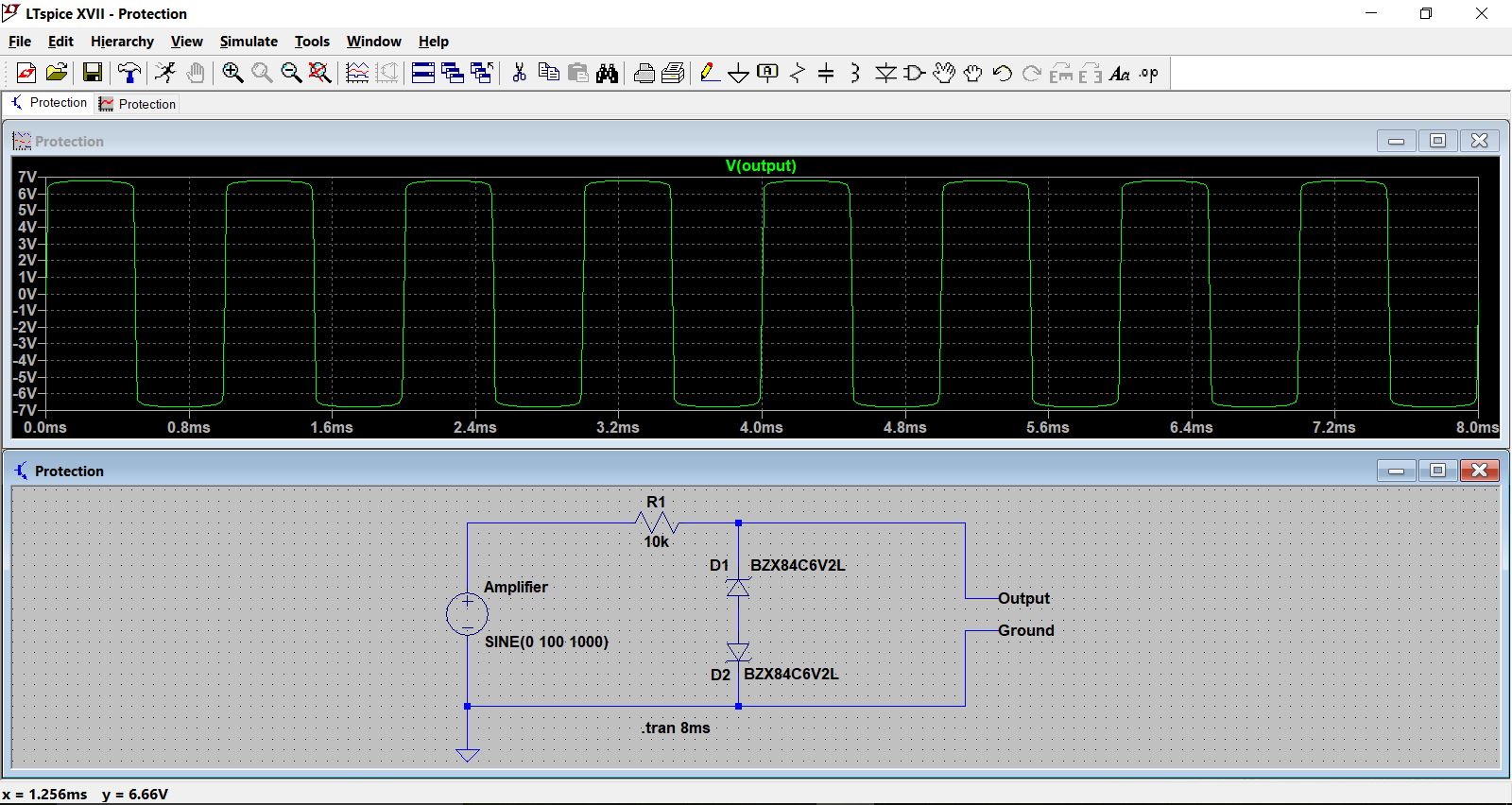

A resistor and couple of Zener diodes will protect your PC from excess voltage as shown here. The voltage is limited to the value of the zeners chosen, 6.2 volts here. The amplifier is producing a 100 volt peak sinewave. The signal is unaffected at voltages below the Zener value.
