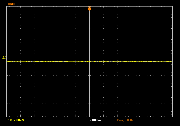

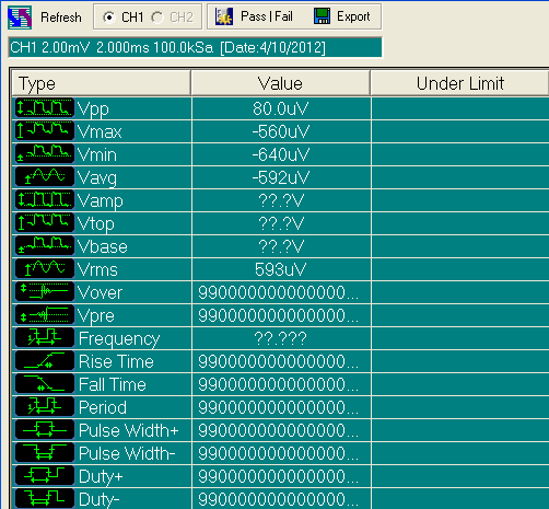

Hello zombie thread.🙂 Should post a conclusion I guess.
Got one 1052E in last year's summer anyway, and this on the pics is what it can show with probe X1 BW20MHz and 32X averaging. BW limit at 20MHZ does little compared to averaging, its only a (hacked) 100MHZ DSO. At X10 probe setting, hopeless at 4mV RMS trace noise with all the above aids. Otherwise it has good construction and parts, is very portable, used to be Agilent's OEM 1000 series. The screen is low analysis which I can't do anything about it, looks like a Sinclair ZX Spectrum video game, the other thing is its fan's annoying noise level, which I did something about. Very handy for many things due to modern automation and measuring, looks better screen wise if fed to the PC, I kept my old German CRT scope anyway.

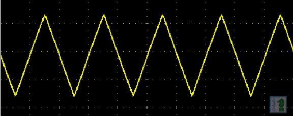

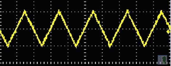

As stated above, most DSOs are 8-bit which actually provides a display with characteristics very similar to an analog scope's CRT. However with a CRT based analog scope the random noise excursions are infrequently and quickly "hit", therefore they are more dimly displayed, if at all, which masks the noise.
Most higher-end DSOs have "digital phosphor" displays which behave like a CRT in this regard, however less expensive units do not and show all components of a signal, including infrequent random noise, at the same intensity.
The worst offenders are those inexpensive toy DSOs (or the grossly overpriced Tek TDS 2000 series 'scopes) with the "QVGA" 320x240 displays that do not have enough pixels to display the signal properly anyway:

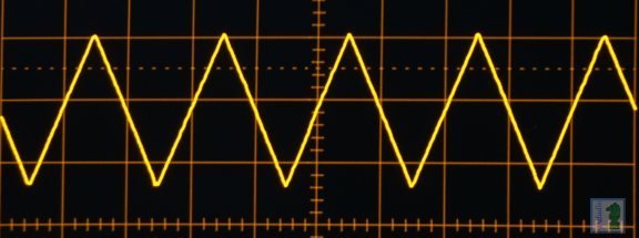

Here is a similar waveform, displayed on a DSO with a 640x480 display:
And, one more time on an 18-year old CRT based DSO with a 4096x4096 vector graphic display:
