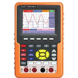

Over the years I have had a half-dozen or more inexpensive DSOs (and before that toy analog scopes), and though most were USB/PC based I have had an opportunity to play with my grandson's Nano V2. They have all been exciting and innovative products, however as tools for any sort of serious work they were no more than frustrating novelties with one common characteristic.
For the first few days you will be amazed by what it can do--after that you will be amazed by how poorly it does what it can do, and by what it cannot do...
My advice to anyone looking for a tool is just bite the bullet and buy a real oscilloscope. In addition to my benchtop instruments I have an Owon HDS1022M-N that is very capable and accurate, has a great FFT mode, and a 640x480 display.
It does cost 2-1/2 times more than a DSO Quad, that is because it's worth it...
