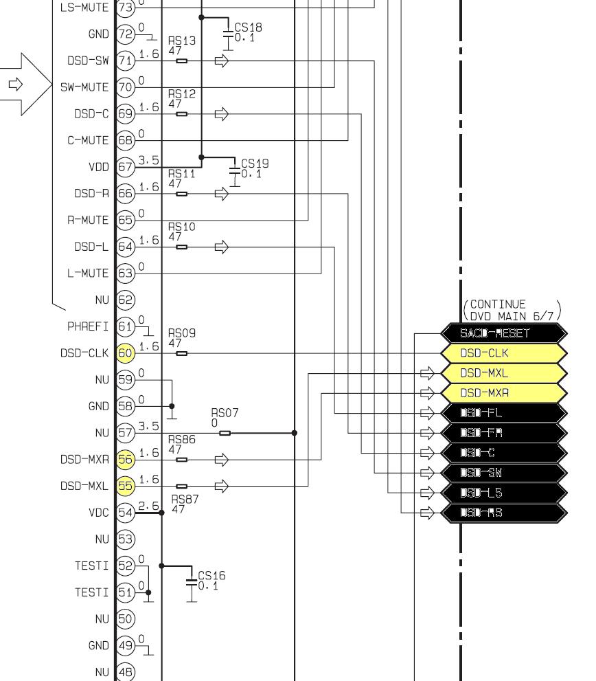

I have just finished this mod yesterday. You have to steal 3 signals and one ground as close as possible to the signals - as shown in the previous post. Signals are DSDMXR, DSDMXL and DSDCLCK which correspond to DSD1, DSD2 and DCLCK on the buffalo input. The first image is from Denon 1920 service manual with high-lighted signal pins.

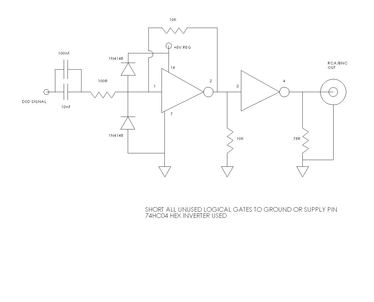

All three signals have to pass thorugh a hex inverter to bring them to required TTL level signal (SPDIF3 or DSD is a 75ohm terminated TTL level signal). They are too weak as taken from the chip. The circuit that I used is also attached. In addition to this you would need a regulated 5V PSU for the hex inverters. You can run all three of them from a single supply. I hope this helps

Decky999,
Nice info for someone without much electronics knowledge, yet wishing to mod a SACD CDP for Twisted Pear's Buffalo DAC application. May I ask about your experience with the posted 74HC04 driver circuit ? Are you still using it and time tested to work (Buffalo locks in the DSD signals). Reading, the digital signal from the Sony DSD decoder chip is too low in level ~.5v, and the 74HC04 driver circuit will bring the signal to ~ 5v ttl level. This ttl level would make the DSD signals compatible with the Buffalo DAC input requirements. Just thinking out loud.
Thank, Henry

All of the Denon universal DVD players use the same Sony DSD decoder, so that mod is possible in any of them.
