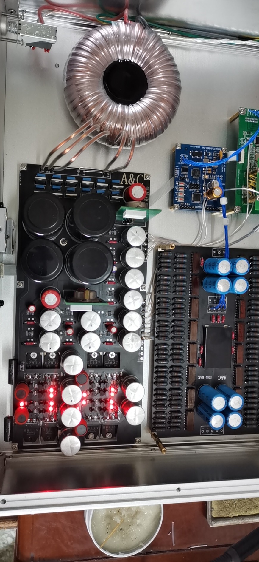

This DAC must sound truly awful. It doesn't have anywhere near enough electrolytic capacitors.

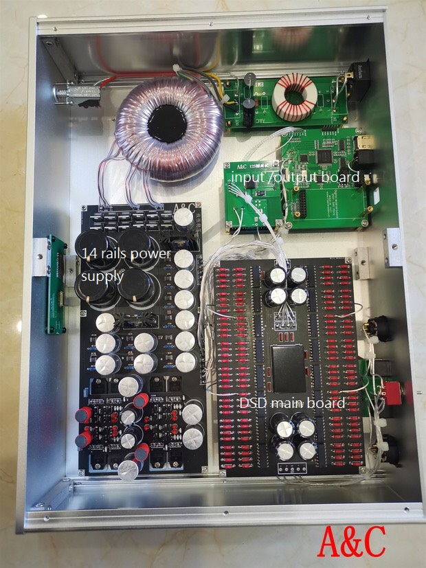

iiuc the op mainly claims that his dac is better "architecturally", not the objective performance or subjective sq, hence no measurements whatsoever
dac with good architecture does not necessarily mean good implementation or performance or good sound
so without any numbers to backup this product is not for me as objective performance is my top priority

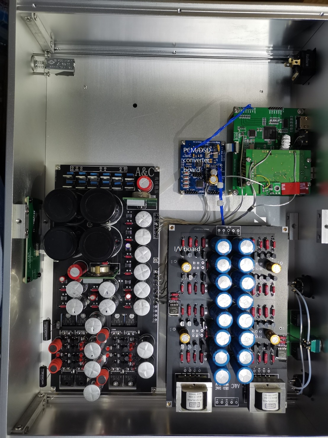

Actually, there is a USB board, and there is an FPGA board for PCM2DSD. Those things can make a fair bit of electrical noise and of course some jitter. So, we just have to deal with those things somehow. If we wanted to consolidate everything onto one board we probably could and still get good results. Cestrian has already consolidated the clock board, the PCM2DSD, and the I2SoverUSB board into one compact composite module. We could also probably put all the power supplies on the same board too. We might need to use 6 or 8-layers, and put the noisy stuff on the bottom side of the board, or otherwise as far away as we can get it from the sensitive stuff. We might also need to put a shielding can over some of the circuitry. But I think it could probably be done pretty well if mass production was being considered. OTOH, a less rigorously designed 2 or 4-layer dac board with MCU/CPLD might have some SQ problems.
This is no-mcu/cpld DAC.
Yes but these things are from pure Digital domain. They are necessary and far away from point of the conversion in another module of DA...Actually, there is a USB board, and there is an FPGA board for PCM2DSD. Those things can make a fair bit of electrical noise and of course some jitter.
But the DAC is from DA segment. And it is not the same if we have cpld/fpga just 3 points before the conversion happening. I gave my notion based on listening tests and measurements confirmed higher amout of HF noise in the audio BW.

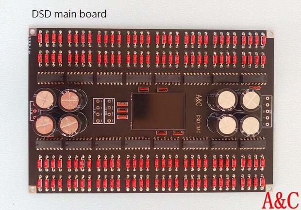

Another thing, most of R2R IC dacs has thermometer code first 3 to 4 MSBits, as a segment before R2R ladder network for other LSBs. THis is 7 and 15 bitts to have non-R2R conversion type - but DSD type with just one R value
