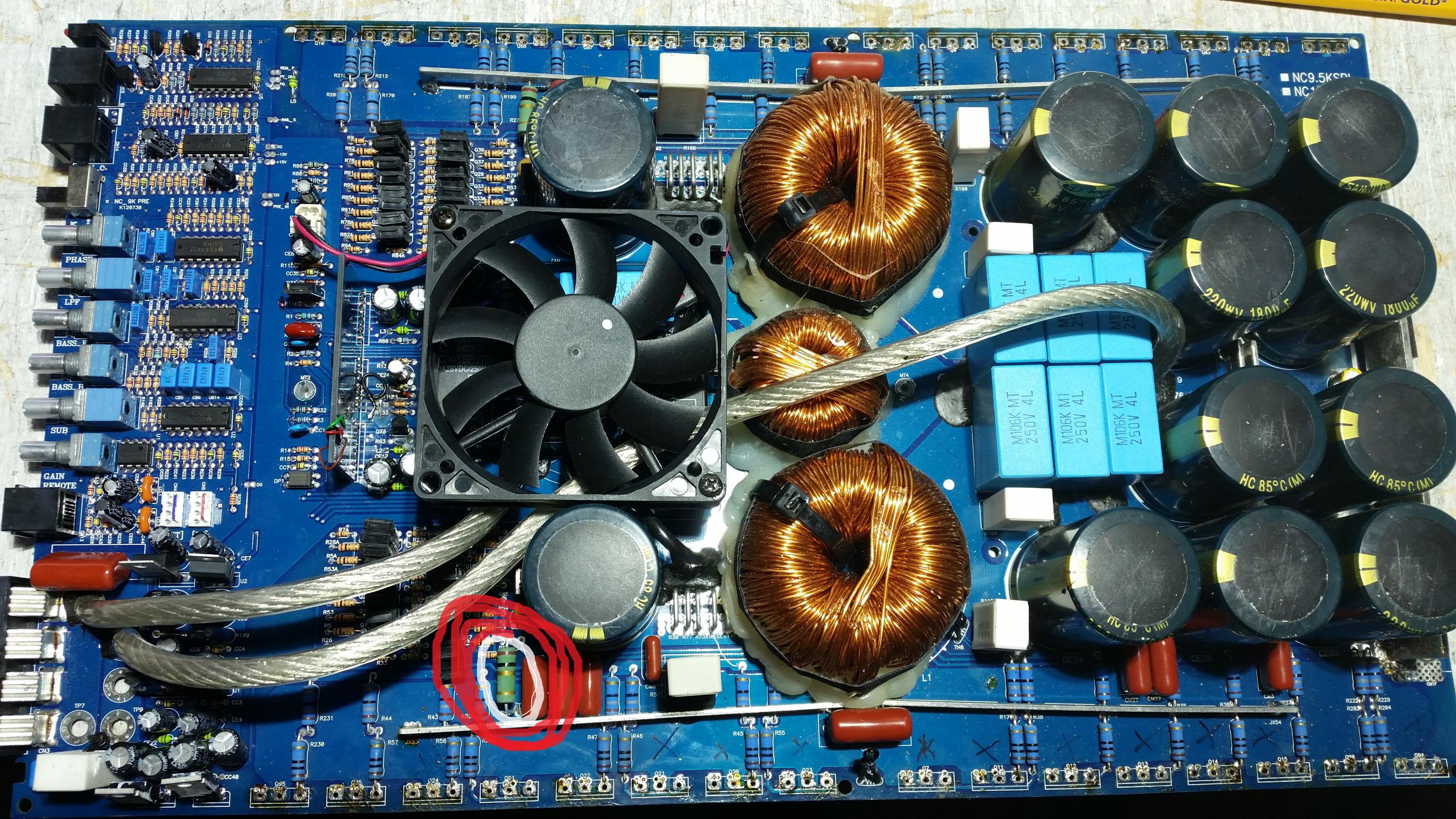

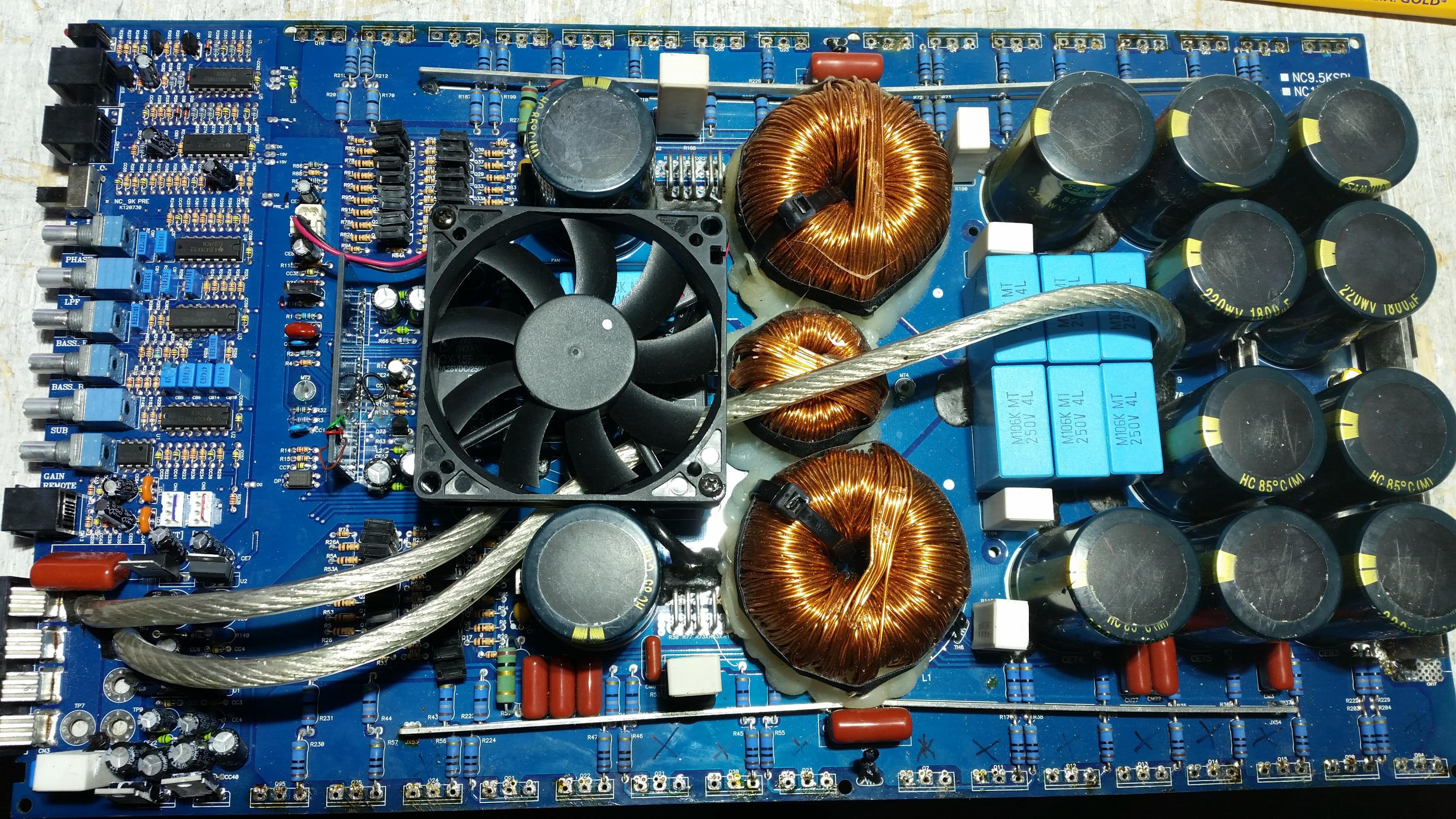

I have a DS18 spl12.5K, this unit has 32 mosfets (4 banks of 24N50) for output fets. With all mosfets removed, I measure the impedance from gate to source on the board, 3 banks read 10K ohm,however 1 bank reads 25K.
Is this a problem?
Is this a problem?
PLEASE, post a good quality photo of the entire board and driver board of audio section.
This, assuming that the ps section is in good working conditions.

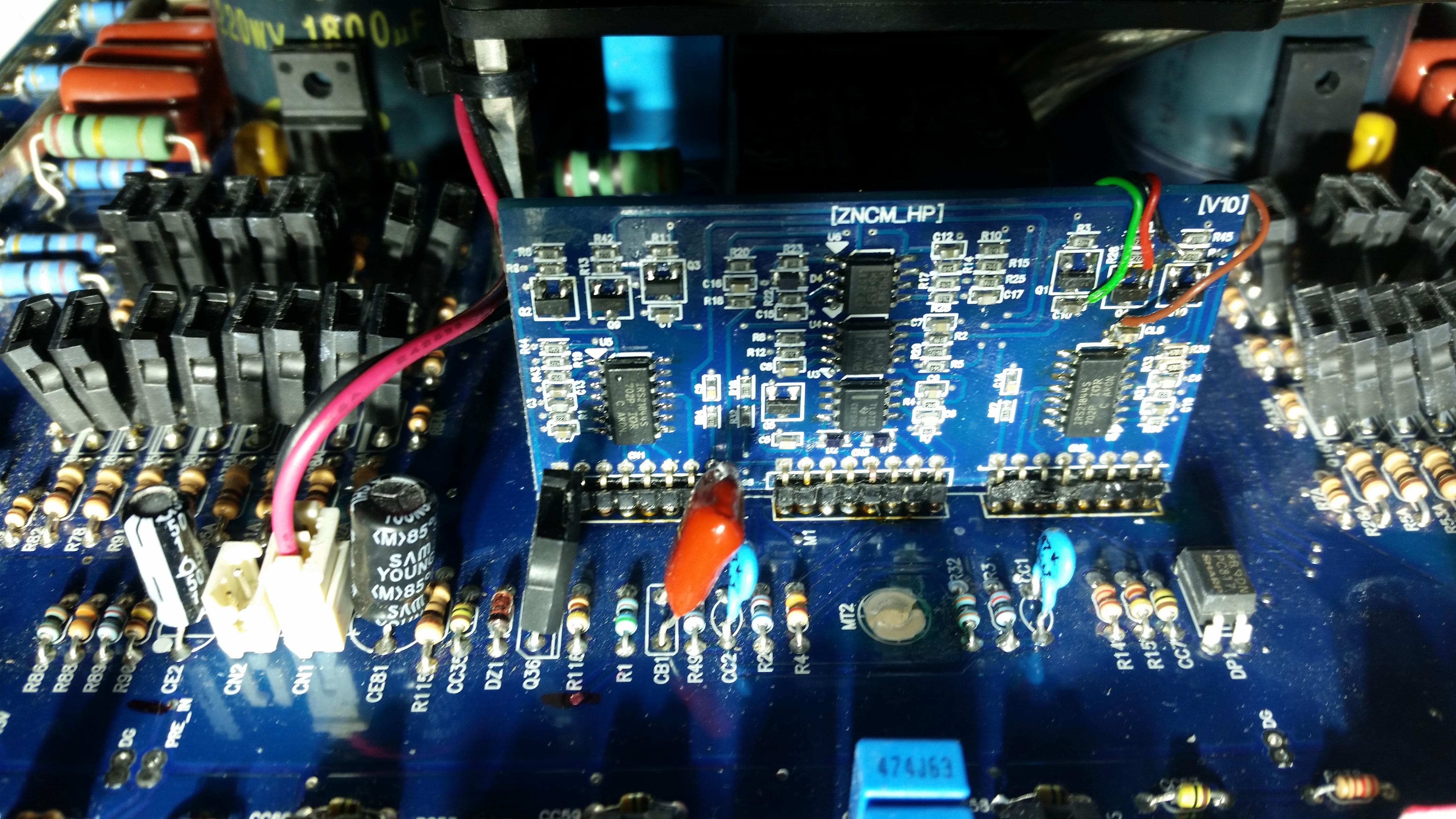

Post a good quality photo of the back of the driver board that shows the wiring that goes to the back of the board.

Both rail voltages are present. I have a square wave signal on all gate inputs hi side and low side.
Should I be seeing oscillation on hi side gate? Can't get a picture of back side of drive board without removing it.

On amps that use a diode on the driver board to supply the high-side B+, you can apply voltage to the high-side with a 9v battery. I'm not sure if that works on the ZNCM boards.
Does the positive high-side supply terminal on the 21844s connect to the corresponding NPN buffer/driver transistors that drive the high-side FETs?

The resistors with a ceramic coating generally don't show much when they fail. They are typically 'flameproof', unlike the resistors with a paint coating.
