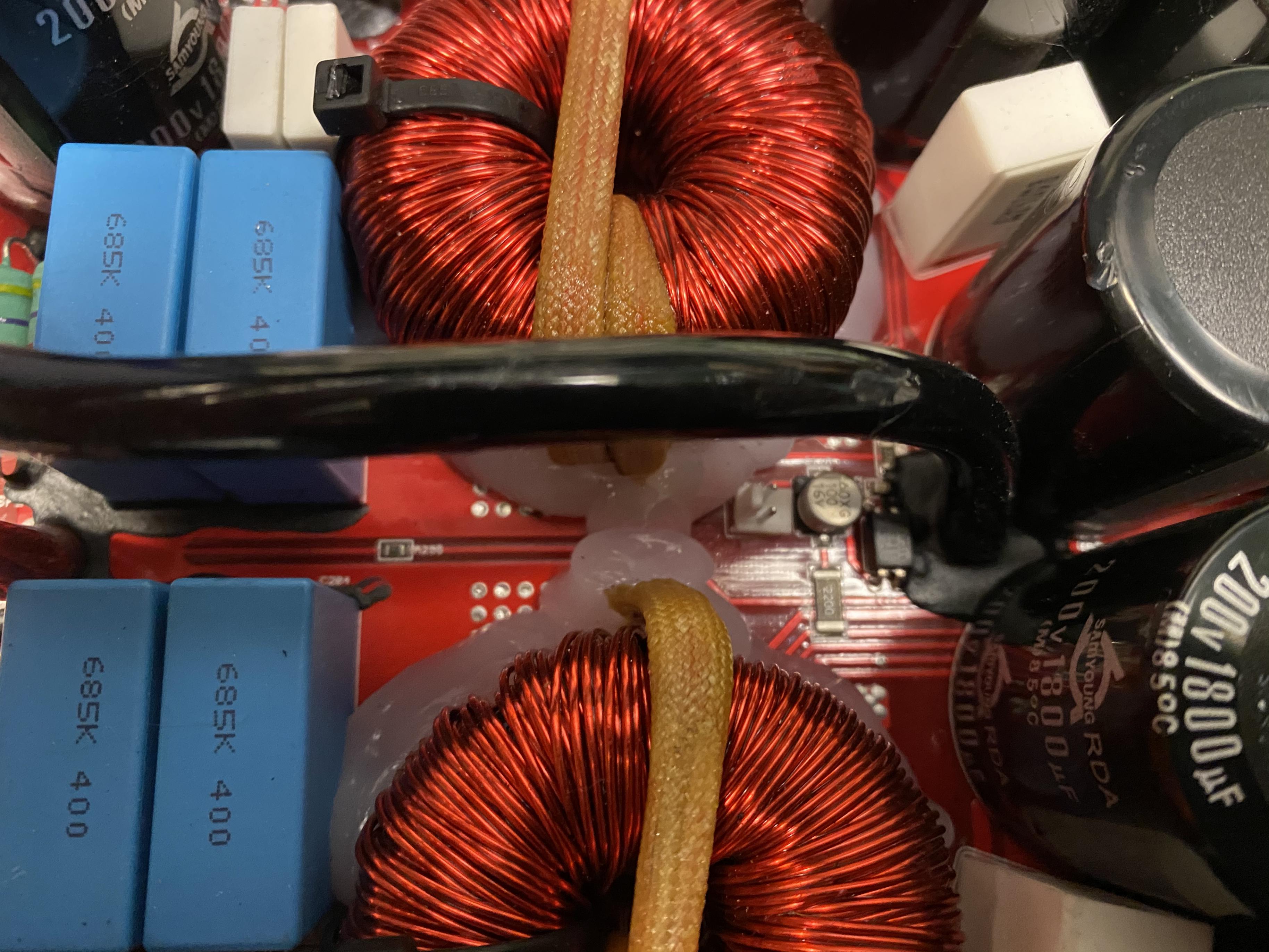

DS18 H-K08
They all
Measure 0.598 K

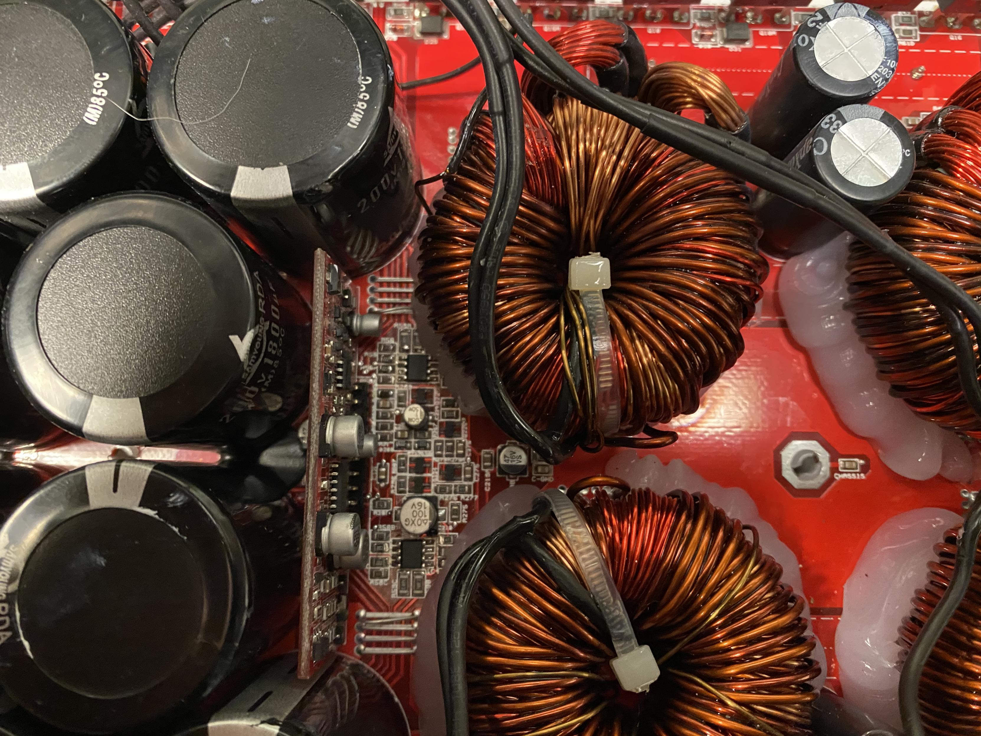

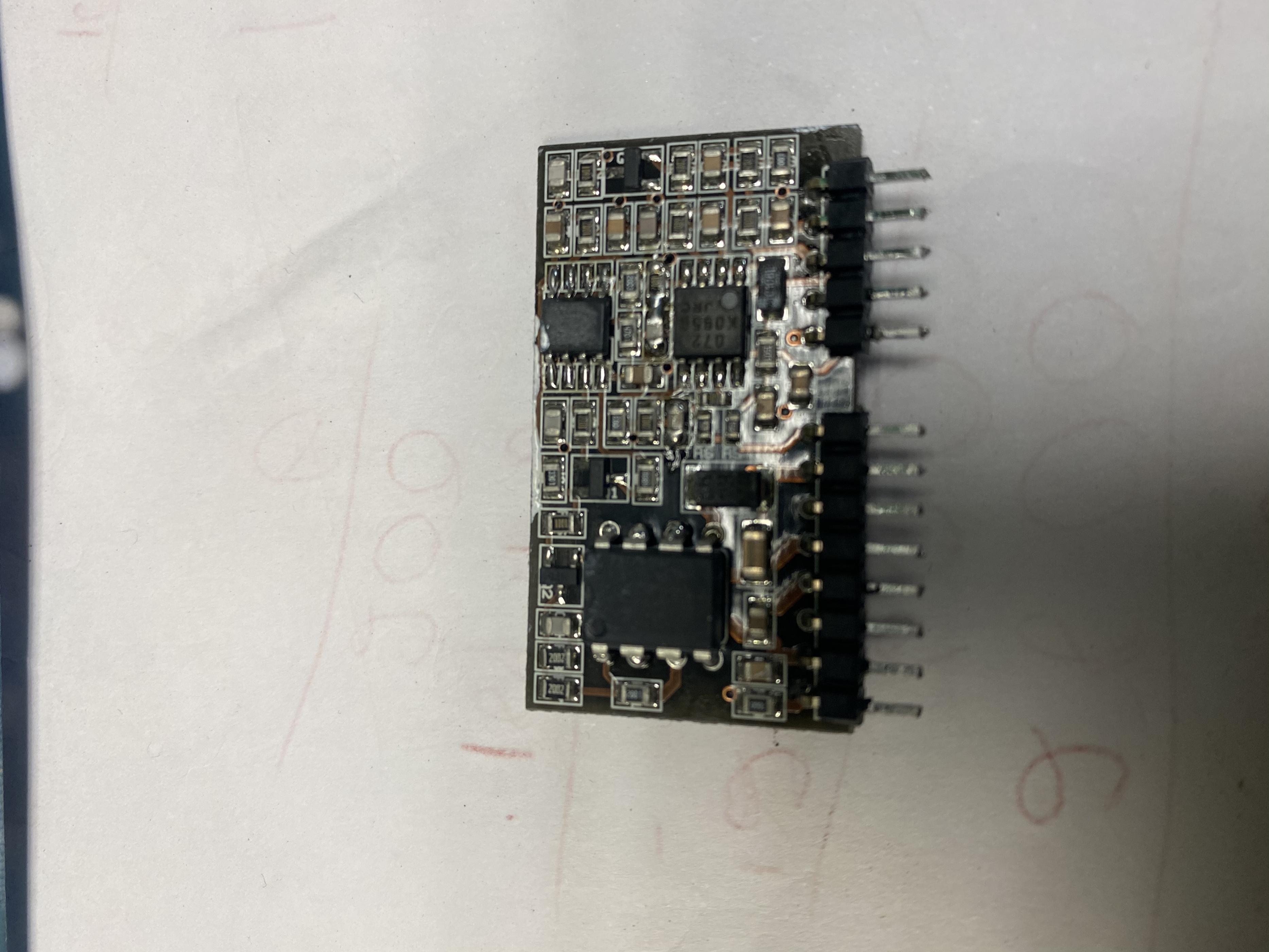

Pic 1 is the bank that has good drive signal and pic 2 is the one that doesn’t have good drive
Scope set to 5us 5 volts div

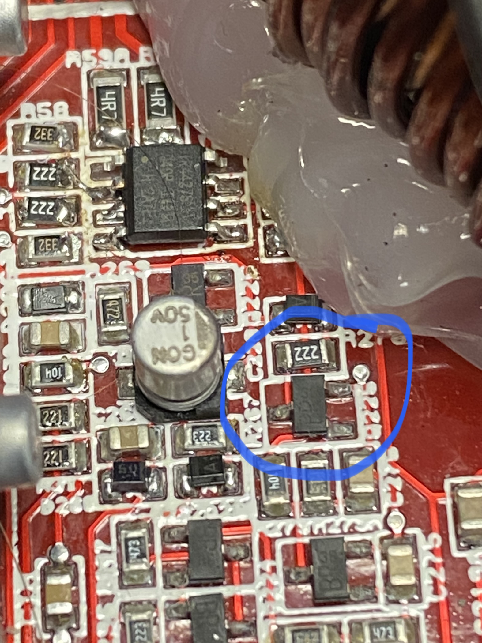

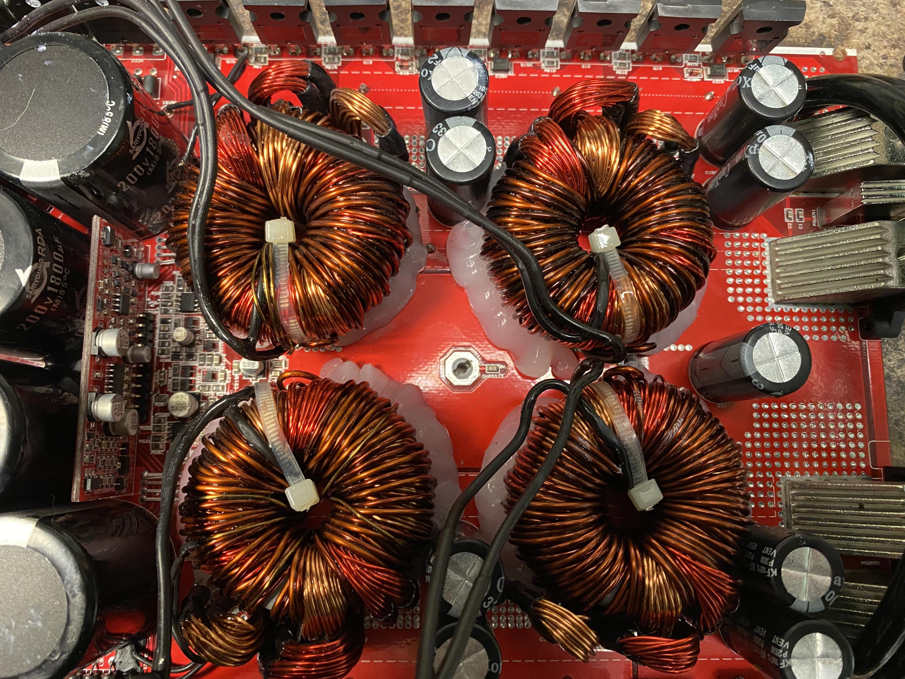

This amp uses 2 IR4427’s
Pic 1 and 2 show the drive on pins 5,7 of 1 4427
Pic 3 and 4 show the drive on pins 5,7 of the other 4427 where I get the bad drive
Ok I figured this amp out finally on to the next one now .
The problem with the amp is when the power supply fets blew it took the driver ic’s with it . Also there are 2 4.7 ohm resistors that connect to pin 6 of the driver ic’s and they open when the power supply blows . It also takes out Q226
Hope this helps others

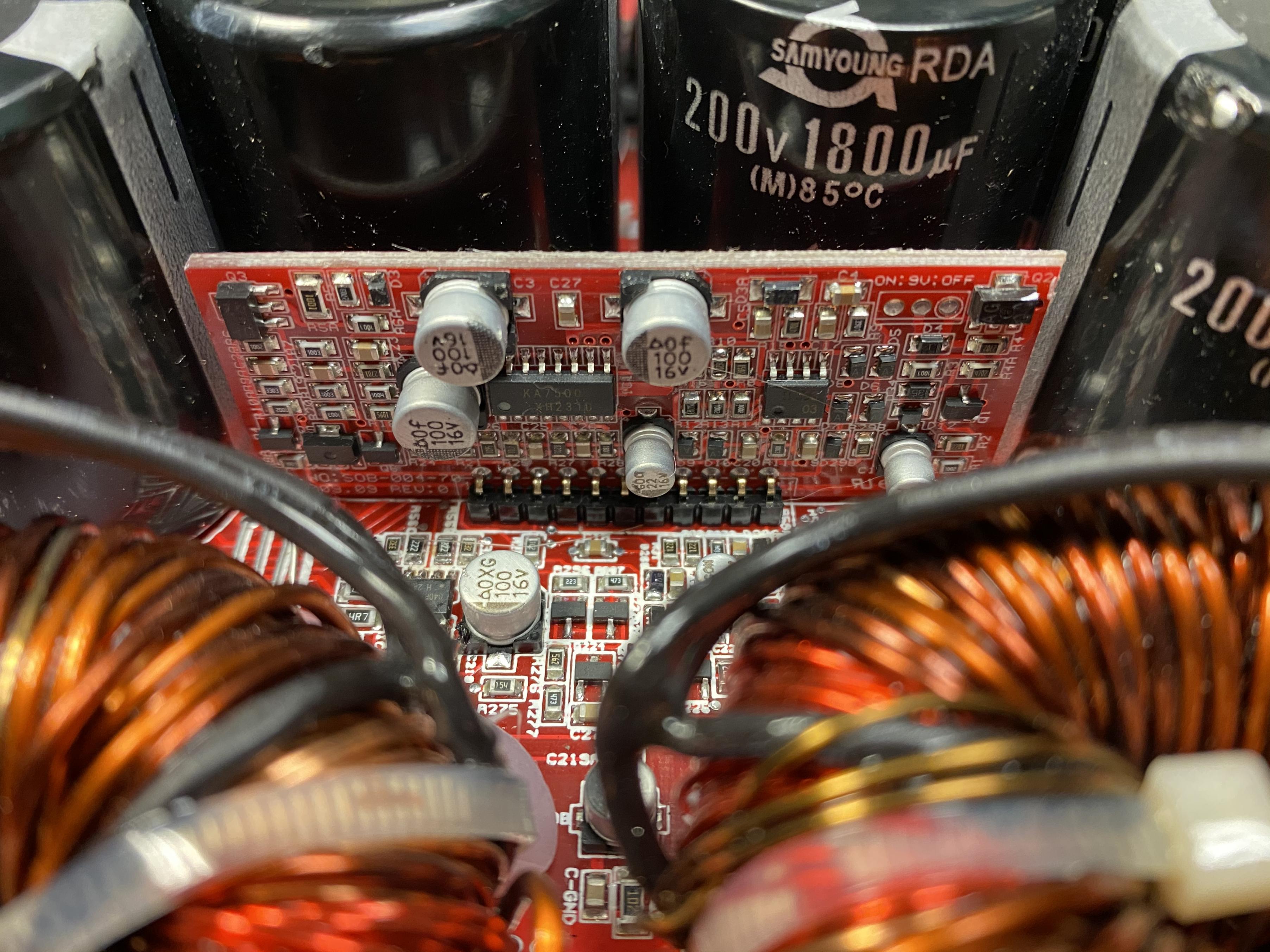

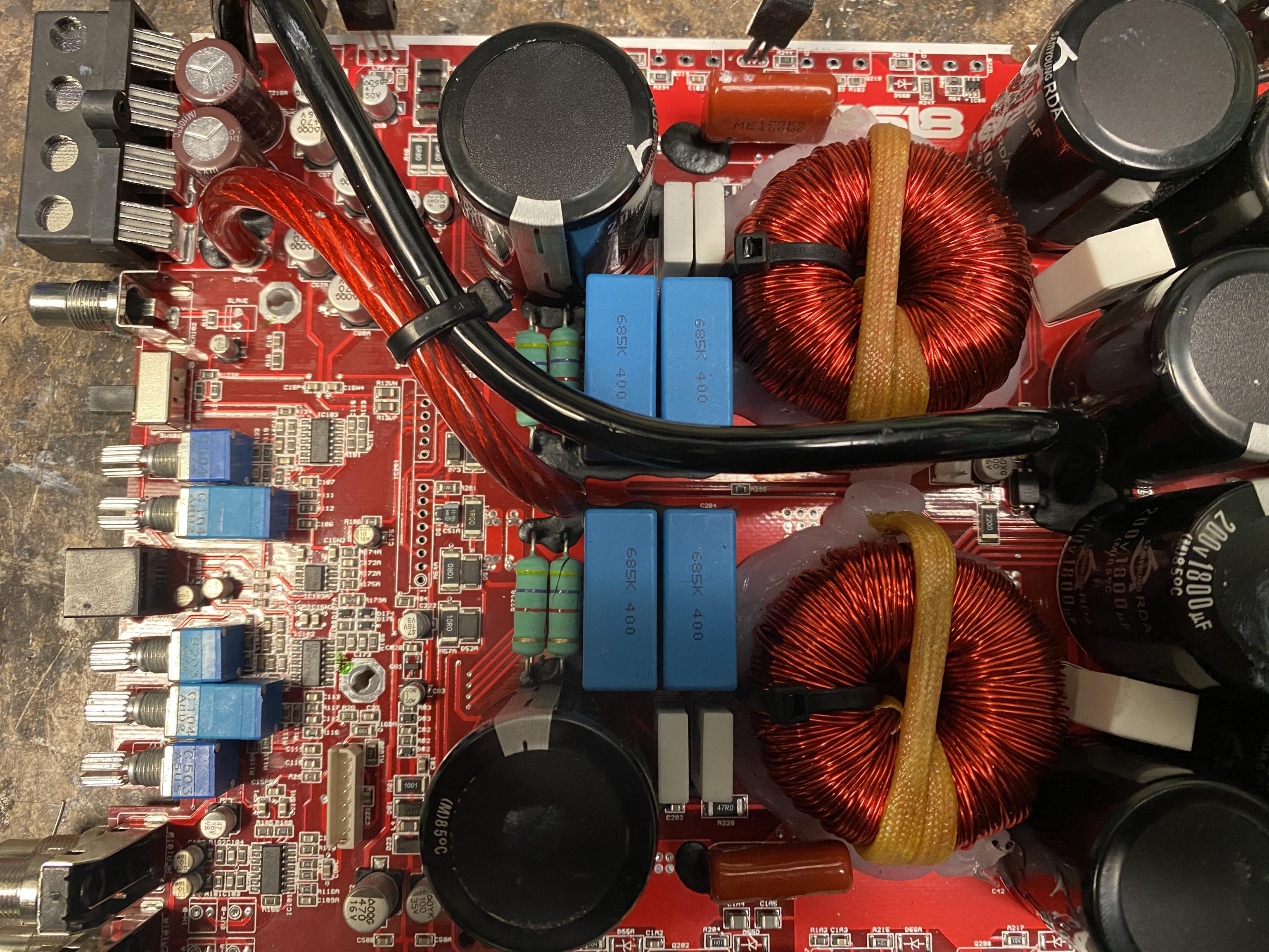

Back to this amp .
The amp worked for awhile and the outputs blew again .
The original outputs are not available right now .
The original outputs are FDH45N50
Wondering if the FDH50N50 might work ?
