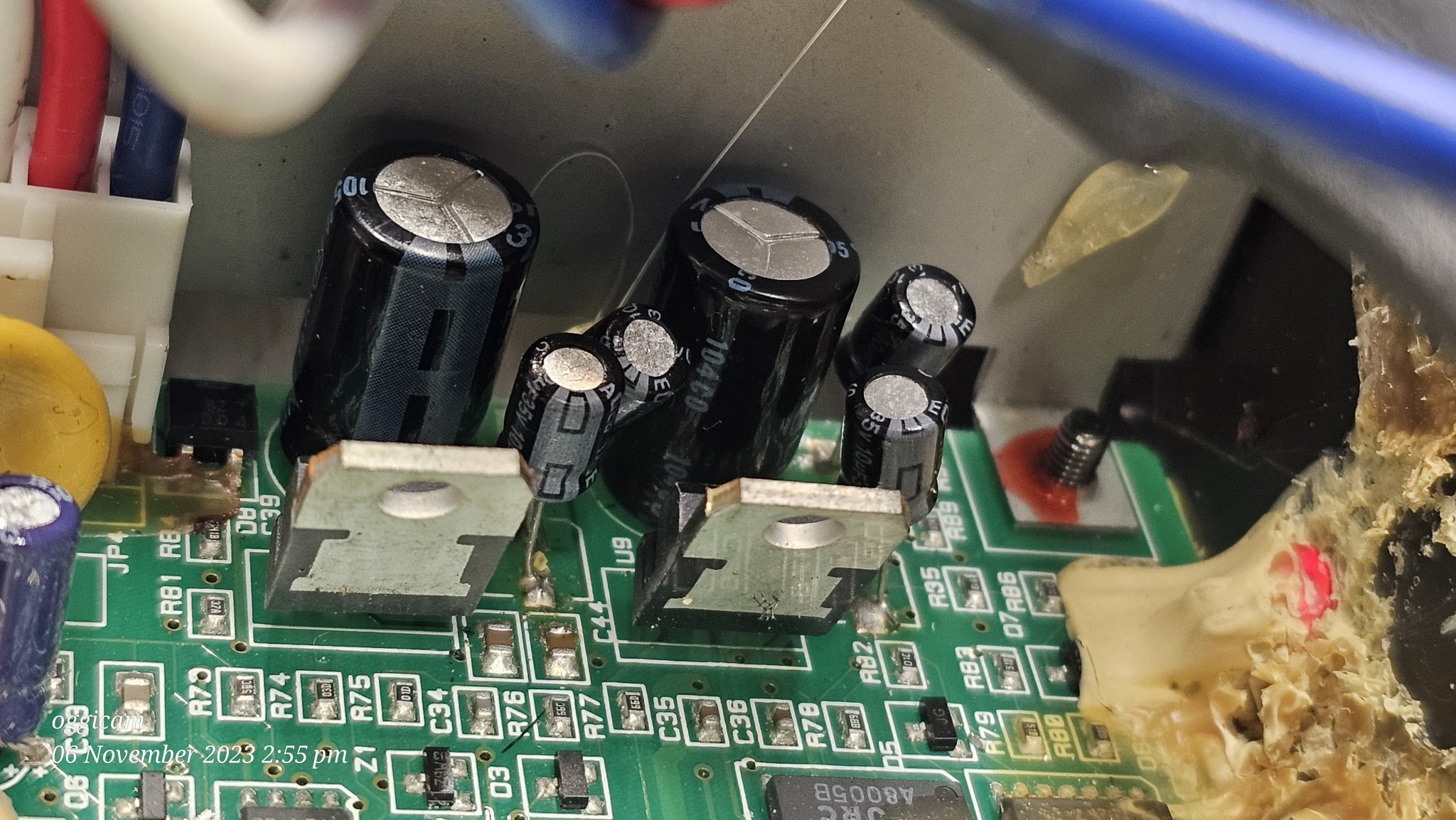

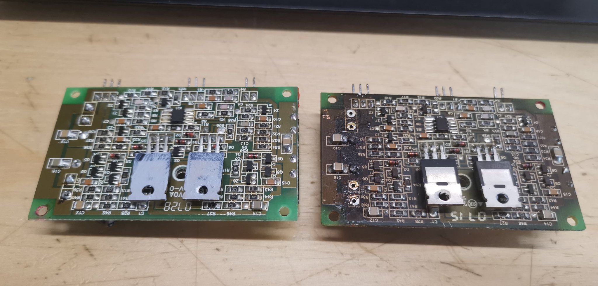

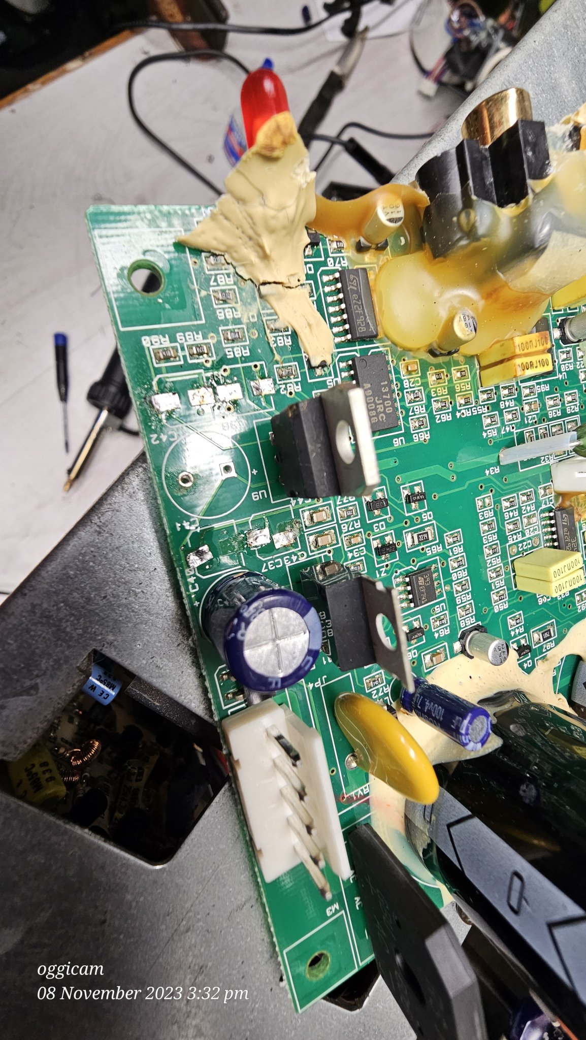

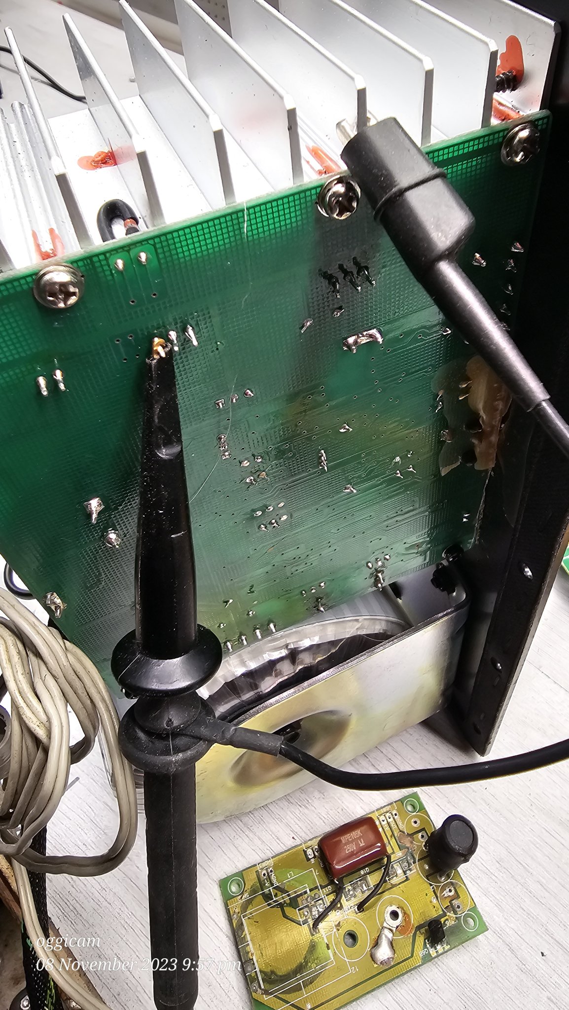

Have a dead D-300 amp in my def tech BP 7004 speakers.
Changed caps and cleaned for old glue.
Still dead, only red led turned on.
No sound. Can't see any burnt parts, changed all caps.
Have audio signal on the sign pin. But no sound.
Have also a working unit, with new caps...
So it seems to be easier to modify with a d amp from Ali express I'll guess...

Guess I'll try hook up a d-amp from Ali, just take power from the original supply, and input signal from the original "pre amp /filter" board.... Only thing that might be a challenge, is that there's a input for a mute signal on the original small D-300 amp board....
Worth a try....
So assume no one have ever managed to repair this small D-300 board?
