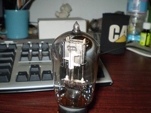

Hallo Martin,
Thanks very much for the reply, i have a picture of the good valve. It may not be a SIF as there are no markings on it. But i bought a pair advertised as made by SIF.
Peter.

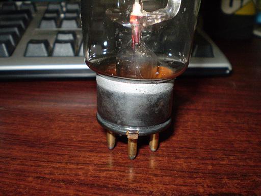

Hello Peter,
That is a PTT2S-sif from France , the coating is removed from the glass, because i can see some silver colour spray on the bass.
I have 8 of these tubes , is your tube new ? are you playing with these tubes in your preamp ? no problems with noise or humm ?
Martin.

I'd just like to point out that silver paint on the base does not necessarily mean it is a SIF tube. I have a tipped envelope Ba with paint intact over the glass branded "Siemens Ba". Also with the Siemens logo and numbered on the other side.
I do think it is a SIF tube but for another reason - in your closeup of the base the paint is sort of thick and rough. The SIF tubes I have seen have paint like that while the Siemens tubes have a smoother, thinner coat. 😉
