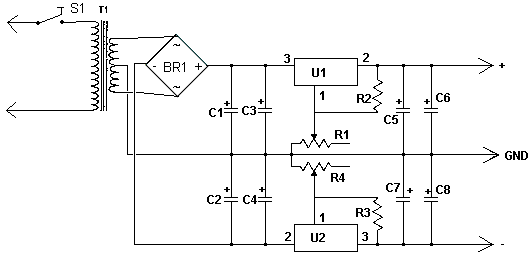

Many tube powered Preamps/pedals/distortion boxes/etc. ask for 12VAC wall warts.
You can NOT repeat NOT again NOT feed them 12V DC (neither 13 or 14V DC to compensate for "now redundant rectifier diodes" and/or "internal regulators".
One famous example is Mesa Boogie V-Twin
https://www.youtube.com/watch?v=h3hz4BxjOio
Which is powered by 12VAC ONLY.
Why?
Because out of 12VAC they get:
1) +12VDC , rectified and filtered to feed tube filaments with no hum.
FWIW they might feed it 12VAC if they wished, which is the standard way to feed filaments.
2) using a back mounted transformer (which of course works on AC only 😉 ) they get some +260V rectified for tube plates.
3) they get raw +16VDC , which become +12V regulated for Op Amps positive rail.
4) they get raw -16VDC , which become regulated -12V for Op Amps negative rail.
I'd LOVE to hear how somebody can plug a single 12VDC (or any other DC voltage, by the way) wall wart and get such a variety of voltage and polarity.
To boot, DC would be shorted by the transformer primary impedance (which would become a low value resistor) .
Obviously, if the Preamp mentioned asks for 6 to 9VAC ... there must be a reason for that 😉
It would have been easier to offer a DC supply if that were not the case.
The V-Twin power supply:
Why?
