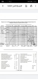

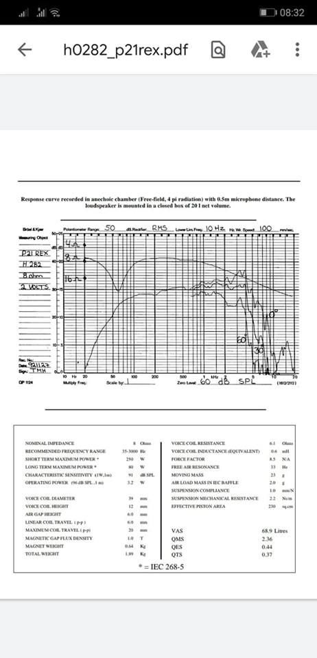

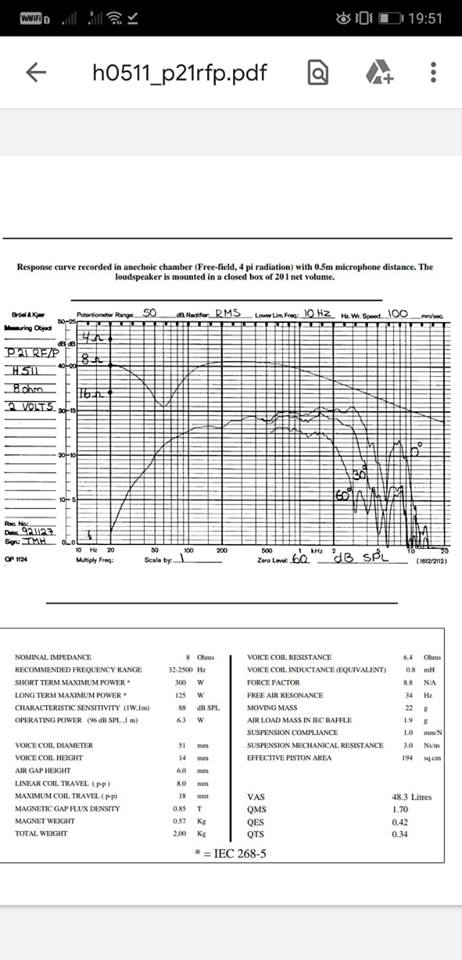

I want to replace a seas p21rf and I already own a p21rex pair (new old stock, never used before) so I am tempted to change the 20 years old drivers for the new one.
Crossover wise, will the new driver work with old crossover? They share many similar specs and Seas states that p21rf is a further development of the p21rex but with 2inch voice coil, also I like the sound of p21rex, it is more sensitive speaker so it works better for me

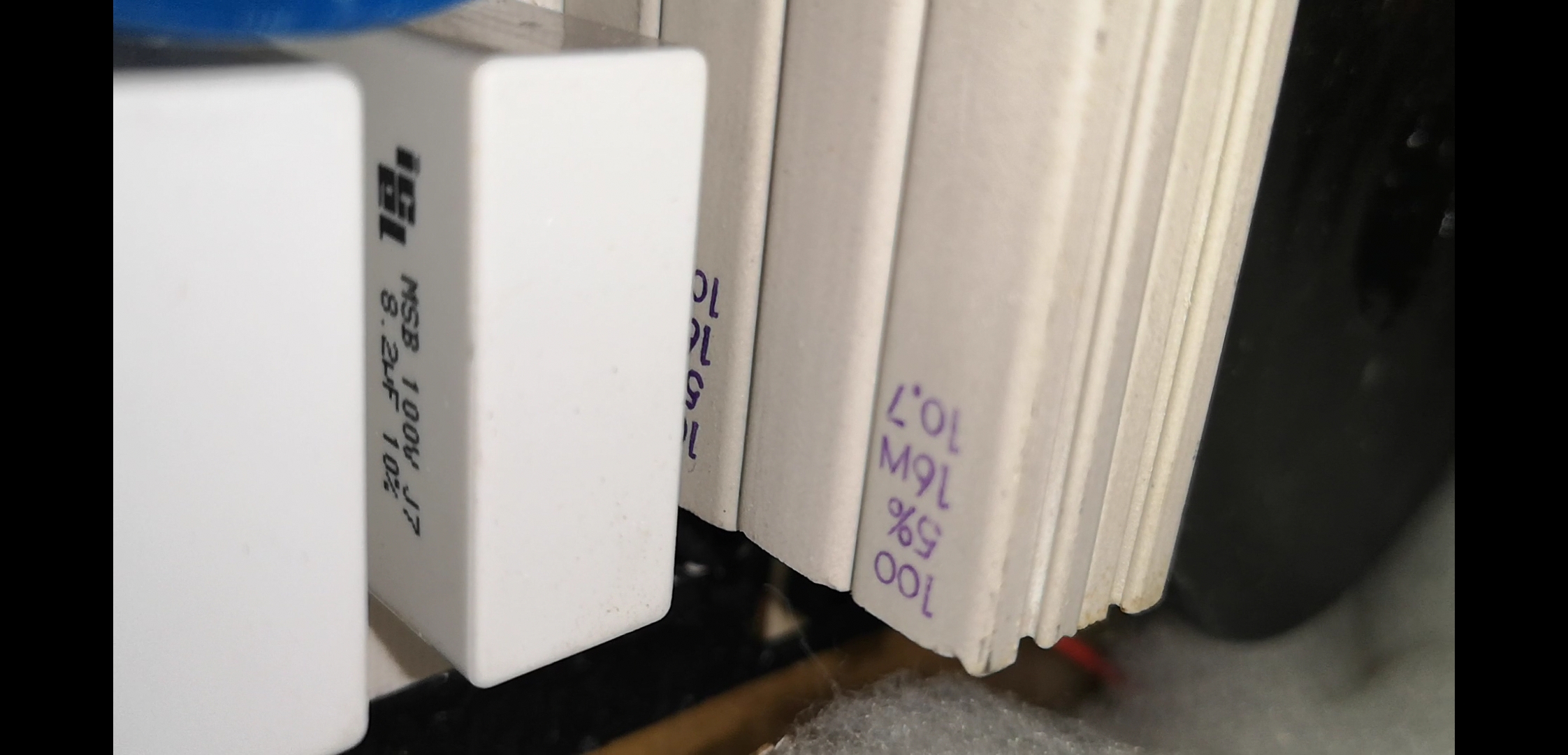

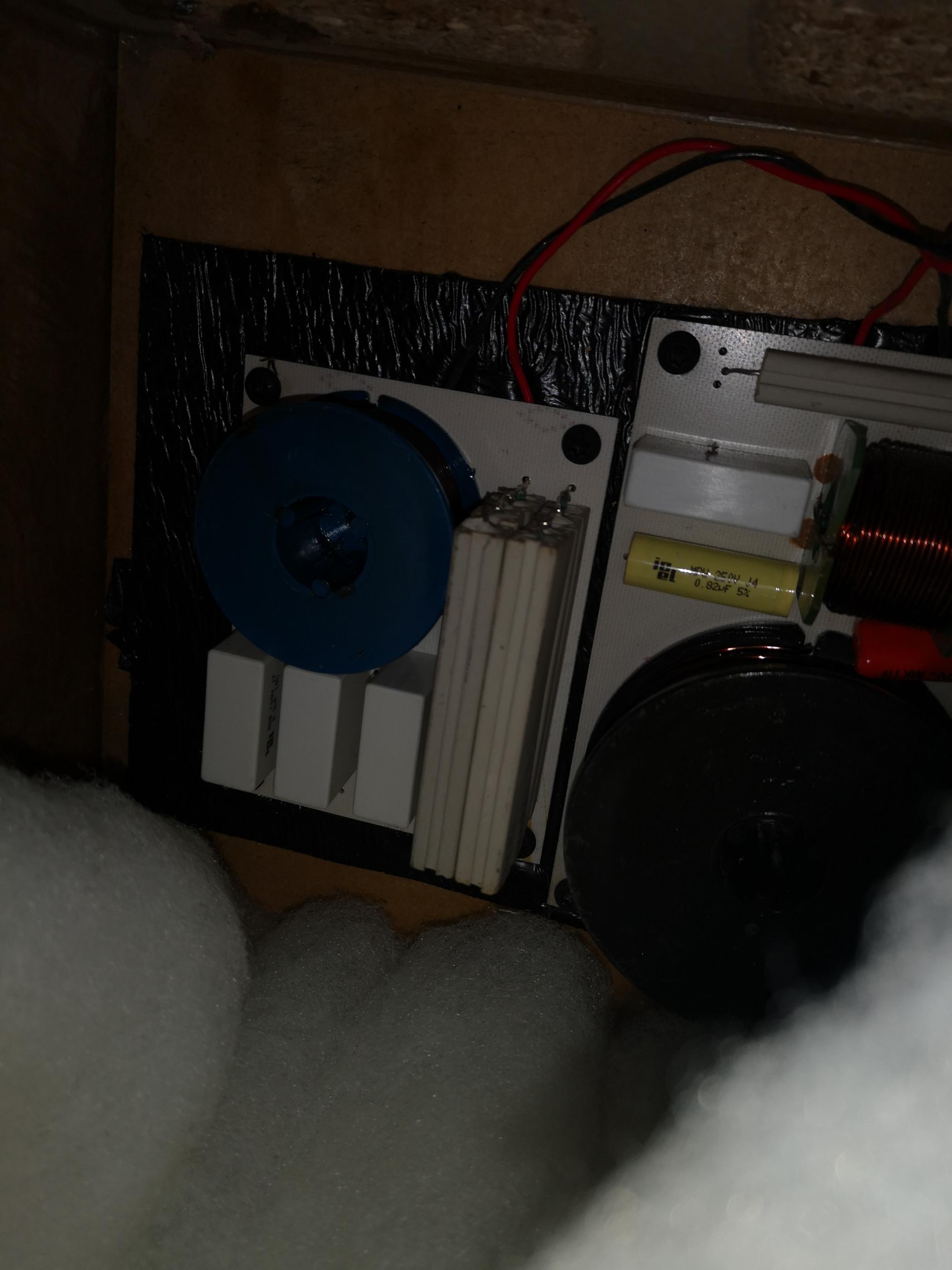

I am a noob at crossover designs, and I've never seen a design like this. This is the Tweeter crossover design. Too many resistors...
Six resistors 10w 10.7ohm

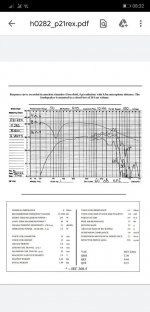

Well you won't do any harm swapping woofers (replacing RFP with REX) as they have very similar impedance profiles.
However, the REX looks to be ~ 2 - 3dB more sensitive? and has cone breakup to deal with?
You might find the midbass / lower midrange a bit bloated and there could be some nasal / forwardness in the lower treble without attenuating the breakup.
I'm guessing the tweeter is probably crossed higher? so the breakup will likely need to be dealt with.

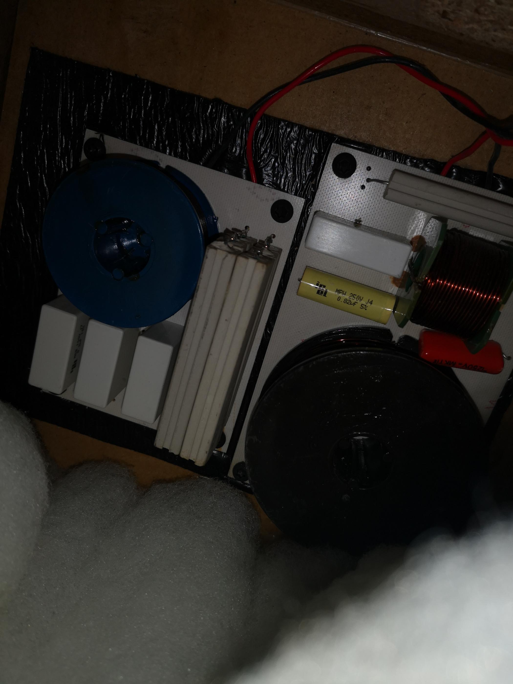

I tried the p21rex without changing anything and I liked the sound a lot. It seems it is crossed at a low frequency point so no cone break up and nothing annoying. The p21rex drivers have more bass than the p21rf, so it sounds better to me. I tried to draw the crossover schematic but the coils didn't have any number on them. So I cannot tell how many mh they are.
Ι uploaded a picture of the cross just for reference.
On the right is the midbass section
Only a small image here, since your original is unnecessarily huge!
808505d1578860234t-drop-replacement-seas-woofer-img_20191113_191754-jpg
Hmm, I only see three ceramic resistors. You'd think the bass section is on the left and is a bass bafflestep coil, with a shunt of ceramic 5.35 ohm (parallel 10W types) and a biggish capacitance consisting of three MKP capacitors.
The tweeter section, on the right, is a bit peculiar. Two coils, three varied capacitors and a level-adjusting resistor. I can't quite make sense of that. Something quite sophisticated conceivably:
714064d1541548033-restoring-monitor-audio-r300-bookshelf-speakers-ma-r300-md-4th-xo-png
714065d1541548033-restoring-monitor-audio-r300-bookshelf-speakers-ma-r300-md-4th-fr-png
714066d1541548033-restoring-monitor-audio-r300-bookshelf-speakers-ma-r300-md-4th-phase-png
The yellow 0.82uF capacitor could only have a use as a bit of very high frequency rolloff on the tweeter. Usually with about 7.5 ohms, aka a Zobel.
But overall, looks like the bass section is quite simple, and hence forgiving of precise details. IMO, 8" woofers are fairly interchangeable! The reason I often mark the input resistor on the tweeter section in red, is it is adjustable to taste.

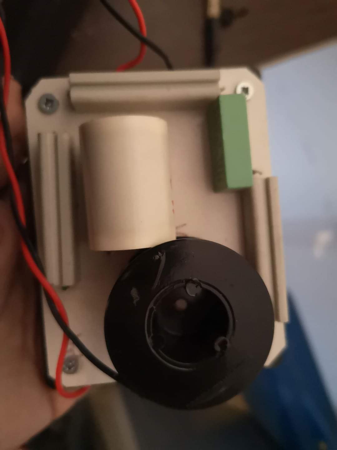

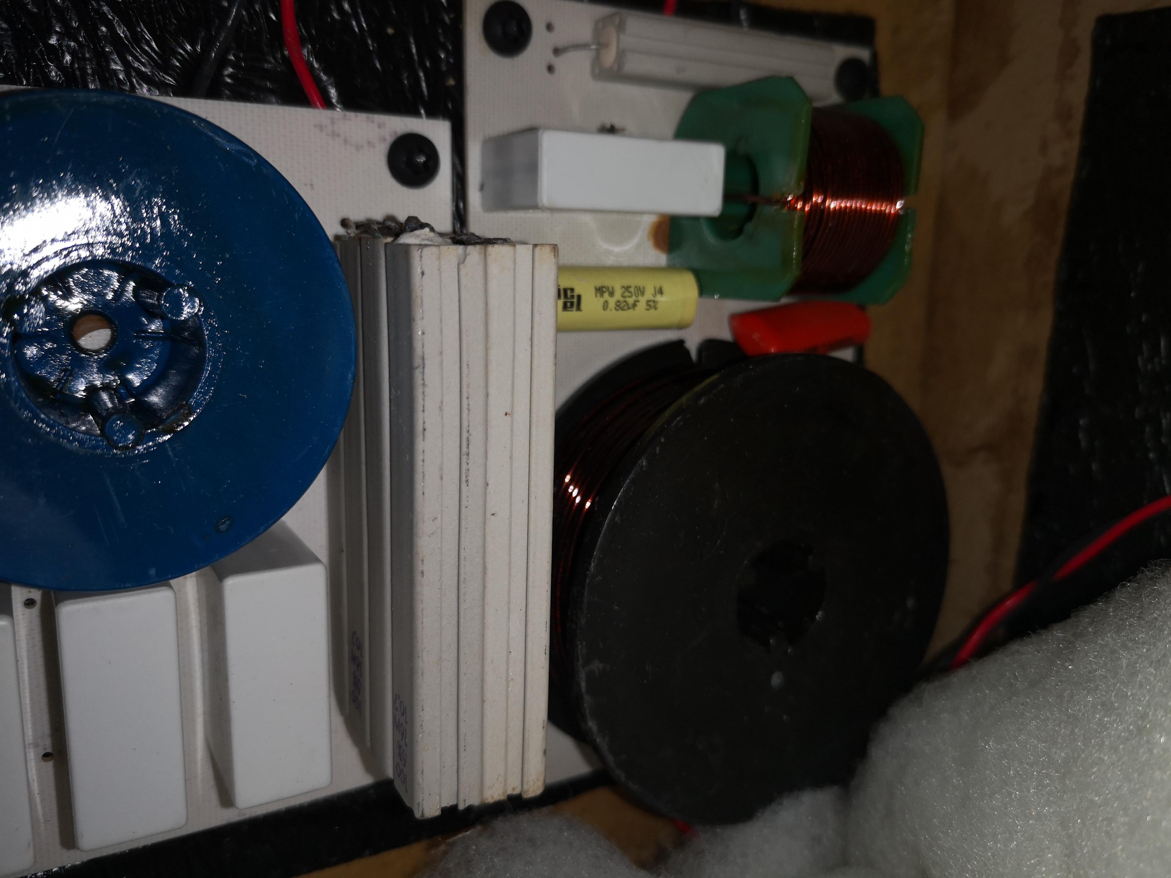

I woke up early this morning and I took another look at the crossover. Both of those boards are for the midbass section. I followed the cables and found another board for the Tweeter!. I felt like a completely fool!
At the midbass section the left board has six resistors and three mkt caps 8.2uf each and the coil. At the right board there is the large coil, a 6.8uf mkt cap, the 0.82uf cap, an orange cap and a resistor!.
At the Tweeter board a murdof 6.8uf and a mkt 2.2uf

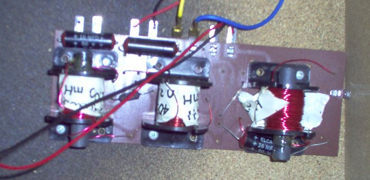

The left board, as you can see at the picture has only one input. The red/black wires are getting in the board but I don't see red/black wire to getting out. I don't know what kind of sorcery this is.
The little board I discovered yesterday is for sure the Tweeter crossover. The other two are the midbass section.

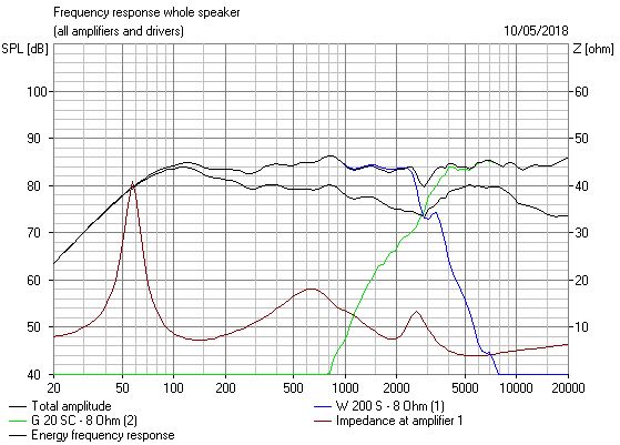

A little update, this is the schematic of the crossover, I guess that I have to remove any phase correction circuit, also the frequency response looks similar, but p21rex has some serious break up.
The resistor at the lcr circuit according to the calculator are 1r7 (six resistors in series)
By the way it sounds good, but as Dave Bullet said there is some nasal / forwardness in the lower treble without attenuating the break up
