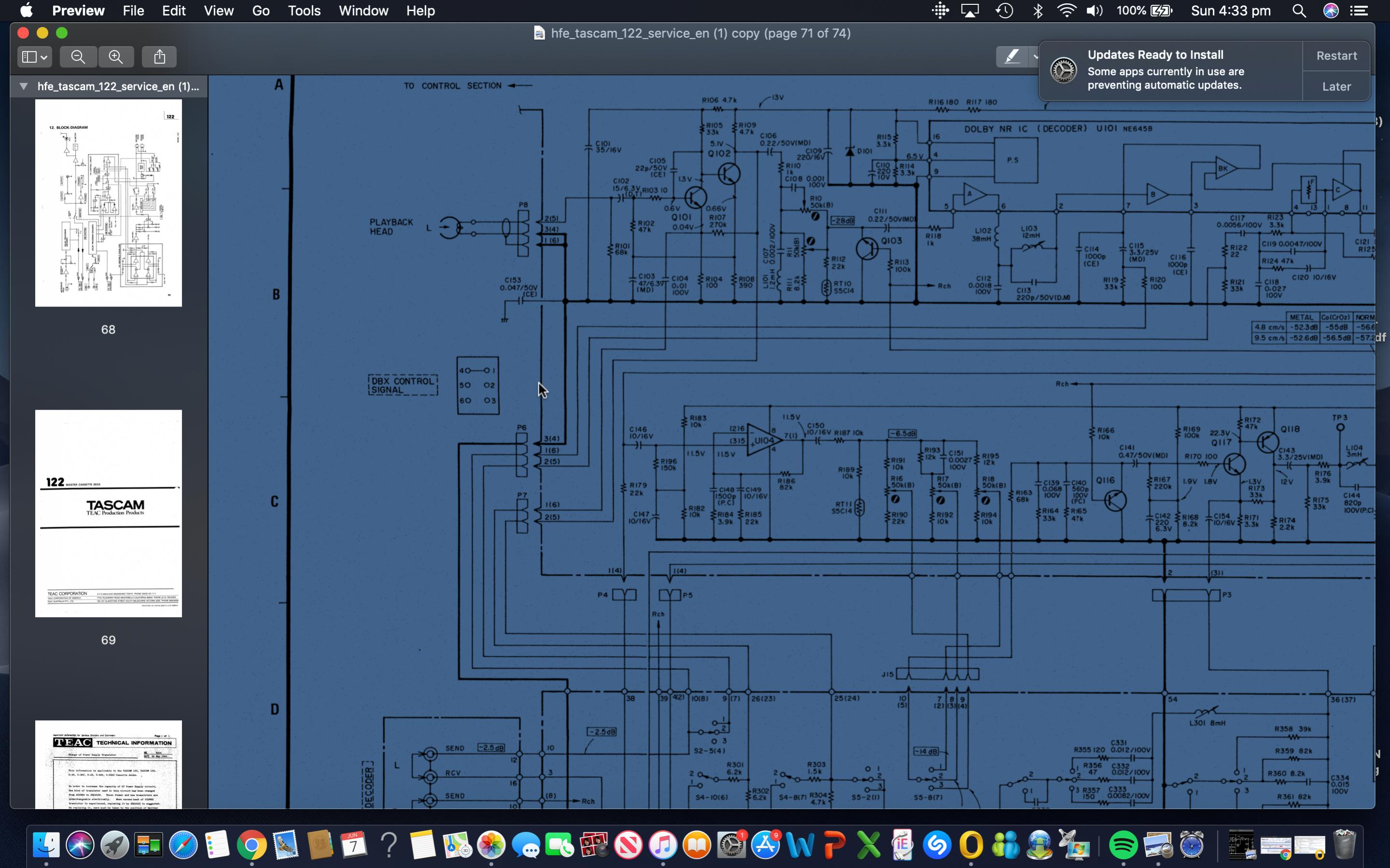

Hi from Australia, I have done what you suggested. Please see below:
Left Channel recording
Pin 1 11.70 volts
Pin 2 11.71 volts

I have tried to attach the circuit diagram, it is from a Tascam 122 which
does not record on the left channel. It is an intermittent fault, actually
the unit records fine for about 10 to 15 minutes and then starts dropping
out. When it drops out you can hear a sound like a lightning strike on the
radio and the needle deflects to the right and then it stops completely.

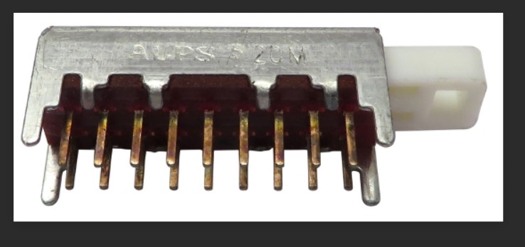

Teac C3X
No the Teac C3X does not have a mechanical switch, it is done electronically.

Hi , I have managed to download the circuit diagram, it is U104 which is the 4558df chip/op amp.
I have discovered something really weird, I have measured one of
the resistors in the feedback circuit of the OP amp, in circuit, power on,
the resistor measures open circuit or infinity. When you check it against
the working side that resistor measures as per specs. When you turn the
power off, the resistor that measures open circuit, measures OK 3.9k. Go
figure. Can a resistor go open circuit if current runs through them? I have
removed the questionable resistor and it measures OK.
Replaced the questionable resistor and it still does the same thing. no power measures fine. turn it on after a while and records OK for 15 minutes and then stops. resistor 148 goes open circuit.
This is very confusing, should I look at the electro's there are 4 x 10uf 16 volt electro's around the op amp C146,147, 149 & C150. I use a ESR meter on them in circuit and they seemed to be OK a couple were down to 8uf, is that within the 20% tolerance?

Measuring resistors in circuit, and particularly high value ones is very unreliable... not only are there other circuit elements in parallel to the part you are measuring but also even slight residual voltage from the PSU can confuse the meter. If you do get the expected reading in circuit then its most likely to be OK, if you don't then isolate one lead of it and try again.
So pin 5 is at correct voltage. It is biased through the 150k from a divider across the rails. That all looks good.
I think your problem will be, in order of most likely suspect...
1/ C148 failing very leaky or short circuit.
2/ C149 failing as above.
3/ The opamp.
4/ R186 failing high in value.
Edit... just looking at the numbers (your voltage readings) a total short on C149 would give your voltage readings or a leak in C148 of about 18k. I still think that little cap is the more likely but its a coincidence that a dead short of the electrolytic would give the voltages you measure. It might be wise to replace both unless you find a definite issue with either simply because the heat from soldering could appear to 'fix' the cap temporarily.

Hi Mooly, I did as you suggested and it managed to get through the whole side of the tape without failing in the record mode. Do I put this down as a success?
If yes I have you and a few other people to thank. I shall continue testing over the next few nights. Once we have established that it is OK, can I ask a big favour, I would like to set the deck up for TDK SA tapes, I assume I can do this by pressing the adjust pre set button. I am just not 100% sure on how to do that, I need advice from the expert.
