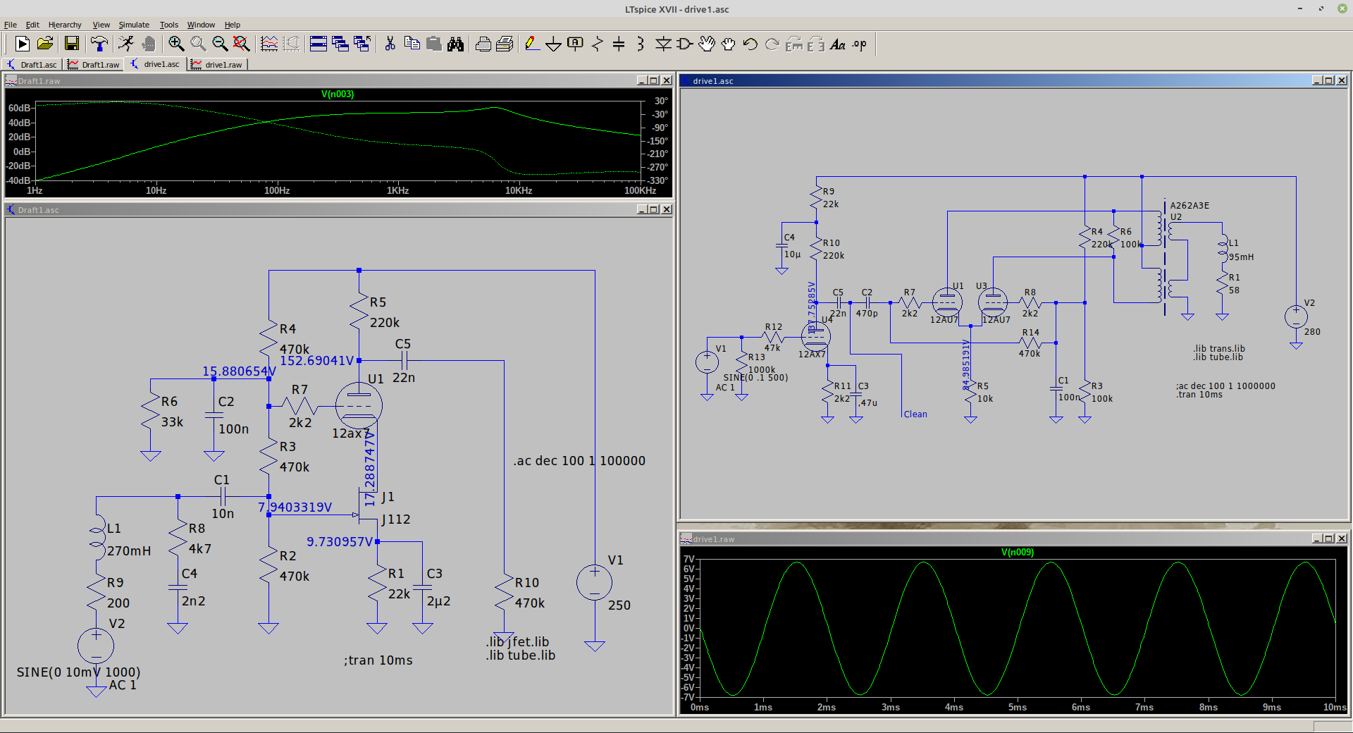

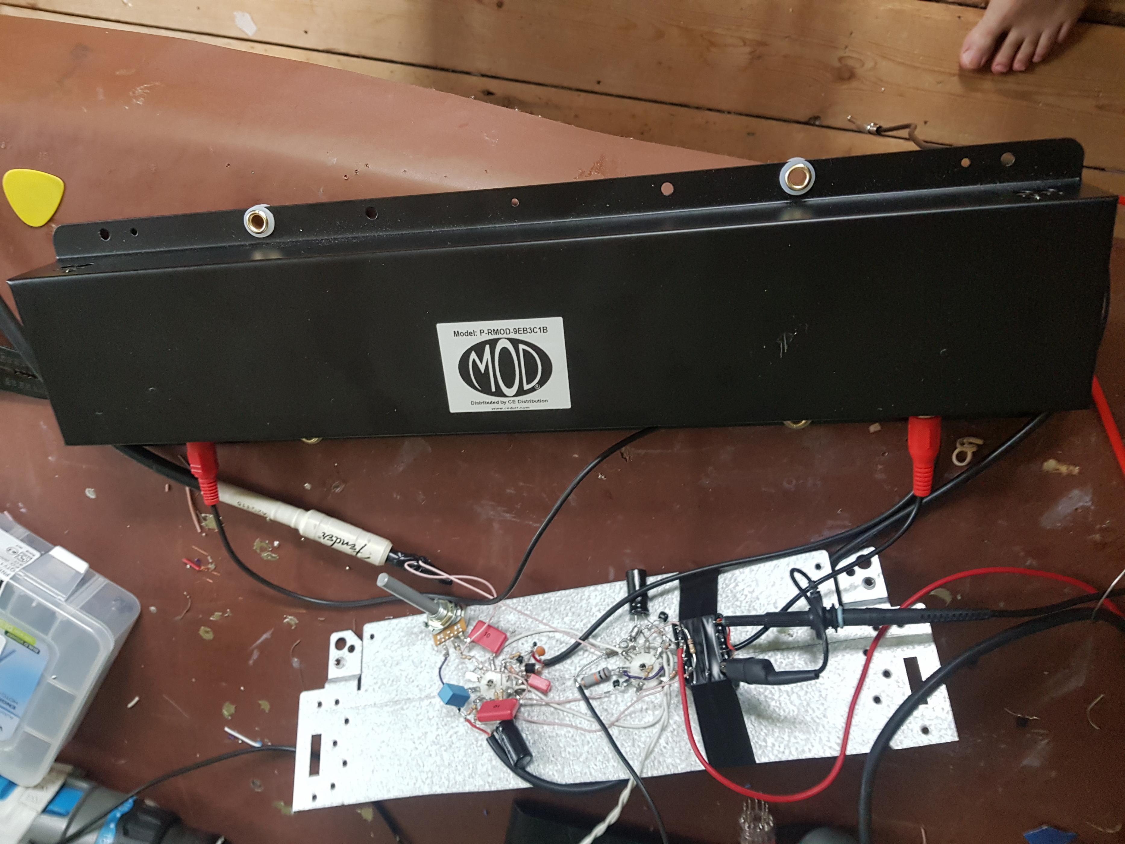

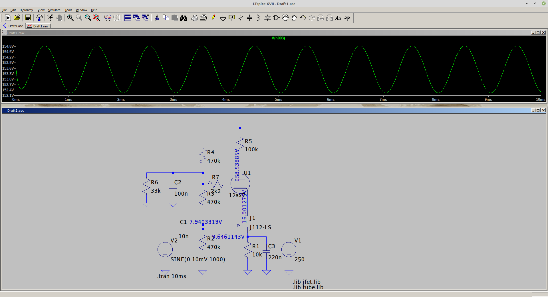

Oddly enough I was not having much trouble with hum at 50Hz even in the input stage and OD. Using a CT transformer and using the half of the 12AX7 away from the heater pins seems to be good. The harmonics from the silicon rectifier get in a little as the HT and heaters share the same mains transformer. I think there is some advantage in not using the same transformer for both. I will try the 12ax7 on the recovery stage. If that is too hissy I may add a JFET first. I will try something loose wired over the weekend and post the schematics for comment.

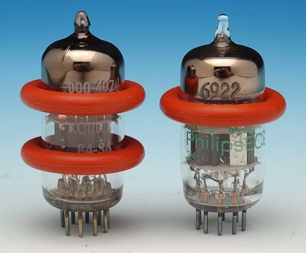

Besides the theoretical analysis, currently available EF86 are almost unusable in a Guitar amp because they are too microphonic.
To tame that, they are mounted on "floating" sockets (not rigidly bolted to chassis but floating on 2 rubber grommets), have "anti feedback" rubber rings around glass bottle (basically O rings made of thermal resistant silicone rubber) or a combination of the above.
I think that was the idea behind the FET>Triode Reverb recovery chain.

Even biggies have their own:
and for deep pocket audiophools you have these solid gold ones:

I guess if I have one 12ax7 half left putting it in parallel with the other (with separate cathode resistors and caps) may help the noise a bit. I would like to stay all valve if possible.
