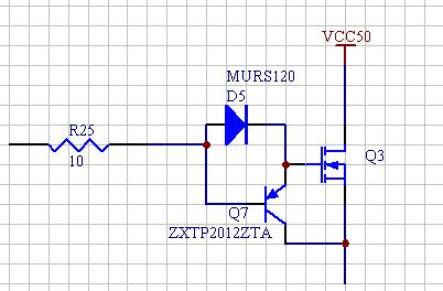

Well, this was my idea of the implementation of active PNP-turn off, is anything wrong with it?
The resistor allows me to control the turn-on current and hence the turn-on speed, directly driven from the IR 211x chip.

Hi Pierre,
some designs do not use this diode. Some people simply would use that 10 Ohms resistor in place of your diode. In that case the PNP transistor would see reverse Ube during MosFet turn ON.... Usually even that is not troublesome, I also played around with that simplified circuit and did not get trouble. As long as the base emitter diode does not break through during MosFet turn ON it would act like your circuit. If the Ube diode would break through, then the turn ON would be slightly faster.
The circuit, which you are using is perfectly correct from my point of view. The diode is limiting the reverse Ube to an uncritical level and the 10 Ohms are defining the turn ON speed ...but of course you spend one diode more...

So what type of results are you getting with this PNP turn-Off scheme....Have you considered using schottky like IN5819 in place of diode...Is the gate driver is cool now and what is the gate charge of mosfet you are using....what are the rise & fall times you are getting with this.

Pierre said:Still waiting for my prototype board to test it... I will report on the results!
Sorry,
Didn't get too much improvement. Have to measure the temperature of the driver chip with and without the PNP active turn off, but I think it is not too different.
Pierre said:Sorry,
I have got an improvement in both driverchip temperature as well as less shoot-through for a given deadtime with active PNP.....😉
