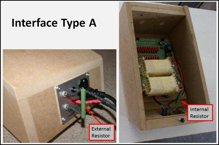

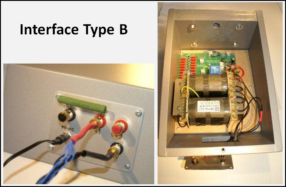

Made some photos for you. Discovered the voltage poti.

Thanks for the photos. Very interesting to see another variation on the Capaciti interface design. Looking at the first photo it struck me how similar the transformer is to the one used by Audio Exklusiv. I recall asking Calvin once if there was a connection between the two companies but he was not aware of one.

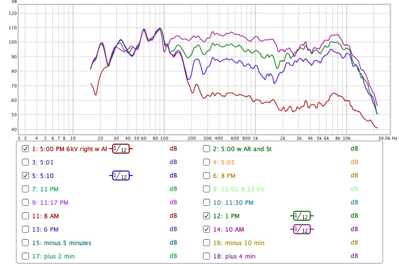

THANk u!!! That explains a lot. I measured with 0.1 volts.
Heres 0.1 and 1 and 3.5 volt. Cant go higher. Does that look good? Still all with the resistor, just had the file in my pocket, sitting in the airport...

Very very similar to Capaciti. Sound wise and optically, even the bars and the silicon fixings.

Yes that looks very good...That explains a lot. I measured with 0.1 volts.
This confirms the primary inductance of the transformer is > 200mH not 5-7mH as was indicated by the first measurement. You can see now why using a 2.2 ohm resistor will mainly affect the impedance at higher frequency. At low frequencies the impedance is dominated by the transformer primary inductance, so adding or subtracting a few ohms of series resistance makes little difference. Based on this, the second circuit shown in post#21 is not really needed.
