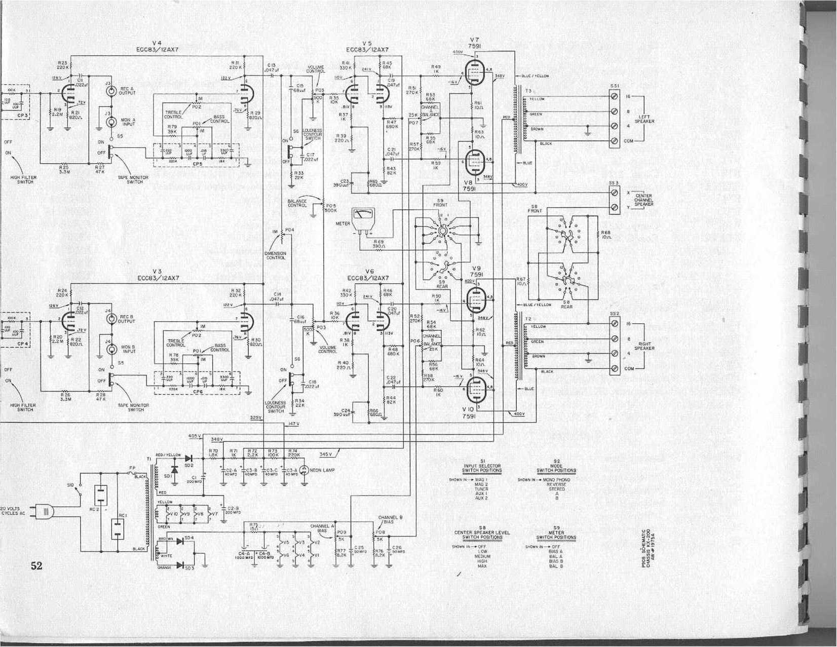

hmmmm...speaking of feedback, how did you connect the HV supply to the amplifier ground?...Lower feedback temporarily....
The reason I ask is that according to the schematic the speaker output "COMMON" terminal is not ground, it is actually the feedback pickoff point. The speaker output "4 ohm" terminal is ground.
Not sure if that could be part of your tube heating problem or not.

I know, but thanks for the reminder. The negative of the bias supply was connected to the 4ohm tap which is tied to the ground.
I believe it may be a weak tube. I'll try to move tubes around to see if it solves the problem. If it does, I know it's the tube. If not, I'll keep looking 🙂

for the schematic.........................only neg feed back used....I have seen pos & neg feedback used...........an pos feedback used..........never just neg.feedback
I think it this setup not a tube..........good luck

I switched the tubes from one channel to the channel I was testing the speaker and all is fine. It looks like one of the tubes was getting weak. I eventually replaced all four with a set of EH 7591 I have and it played beautifully. Loud enough too. Now I'll wire the amp for both channels and install the speakers in my main system.
Any suggestion on how to lower the negative feedback?
I'm pretty rusty on tube amps, but that wire coming off the "com" terminal runs to a resistance divider in the cathode of an early tube. Just increase the value of the resistor leading to the cathode resistor. Shouldn't increase instability when you reduce feedback in an amp like that, but I'd keep an eye on things.

I think you will see that Connection coming off the 16 or 8 ohm tap, not the common ground, all else correct...
John I have never seen feedback setup this way ....but the only feedback is coming of the Neg...well that how it looks...right?........learn something every day...

Whoops - you are referring to the schematic Bolsert posted - yes - feedback from com tap is correct...
Posting from an iphone is crazy....yes, the Com in your example is not ground - the 4 ohm tap is grounded.
Most of the tube amps schematics I see have the feedback from the 16 or 8 ohm output taps...I guess they all work the same way if not from COM ground

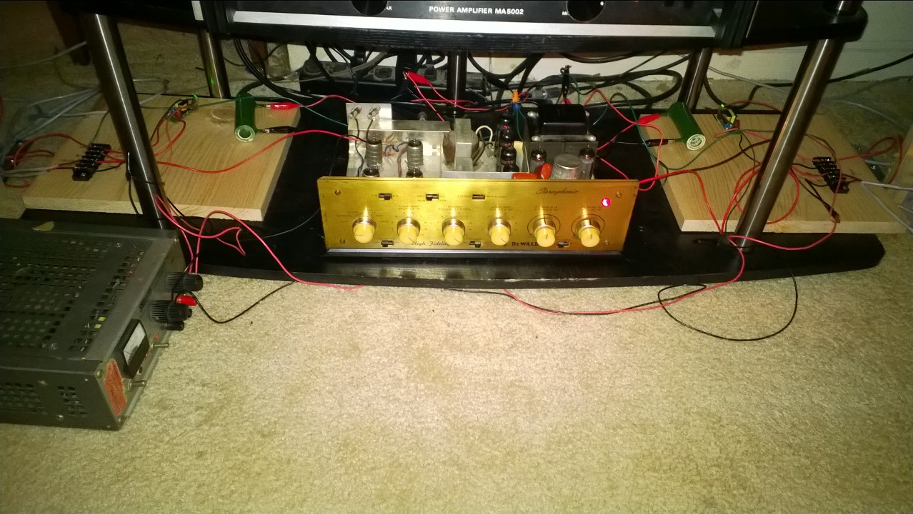

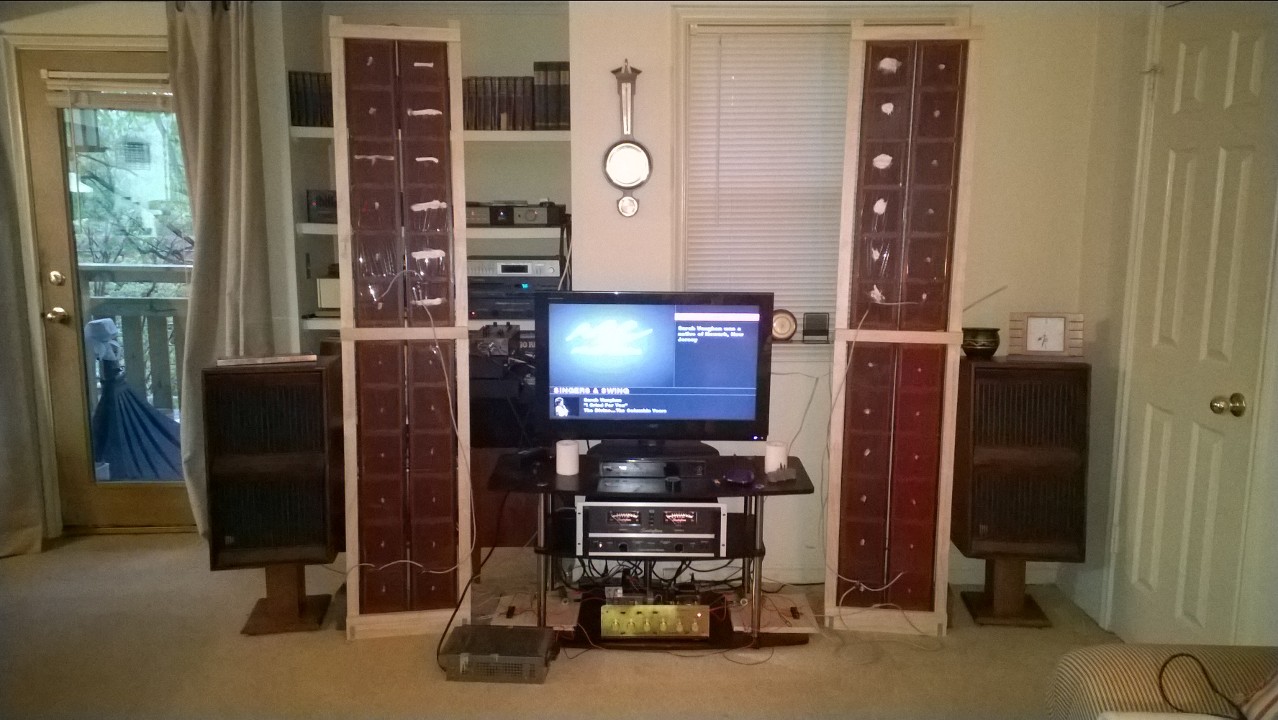

Well, I moved both speakers to my main setup. I was planning to use the KX-200 but I could not find a hole to bring all 4 wires from the plates and I did not want to drill one on the amp. So I decided to try a lowly DeWald amp running EL-84s with about 350V on the plates. Not too far from the KX-200 435V. The DeWald has some holes that I could easily pass the wires from the plates thru. Fired up and the panels sound awesome. Even with only ~350V they are pretty loud for my room. They are active x-overed at 250 Hz. I have a McIntosh ML-1C doing below 250Hz.
These panels have been sitting for almost a decade. At first I could hear some slapping of the diaphragm, but eventually it disappeared. Not sure if the bias voltage tighten it up. I'll play for a few days to see if it improves further. Sounds is incredibly detailed and clear, specially the highs.
I attached a couple of pictures. Next step: build an amp dedicated to driving these... I have a thread on the tube forum on that.

As Tyu mentioned, increasing resistance of the feedback resistors (R65/R66) will reduce the amount of feedback. Generally you will also want to adjust the compensation capacitor(C23/C24) value to optimize high frequency response/stability.Any suggestion on how to lower the negative feedback?
Note also that the parallel combination of the feedback resistors and the cathode resistors(R39/R40) defines the voltage drop from ground that provides the bias voltage and operating point for the phase splitter. So, changing the value of the feedback resistor will slightly change the operating point of the DC coupled phase splitter. To keep the operating point unchanged, you would need to adjust the cathode resistors(R39/R40) down in value slightly as you adjust the feedback resistor up in value to lower feedback.
You would like to have the operating point of the phase splitter set so that the output capability for positive and negative peaks of the audio signal are limited by the output tube clipping, not phase splitter clipper. Looking at the values in the circuit, I don't think the operating point will be dramatically shifted if the feedback resistor is increased. But, it is something to keep in mind when adjusting resistor values around DC coupled phase splitter circuits.

Interesting (but expensive) set of amps. I finally connected my Fisher KX-200 yesterday and it sounded amazing. Even my wife commented on how much better it sounded than my previous system 😱😎 . And my previous setup was pretty nice: a huge Altec 1003b setup with a supertweeter. The KX-200 has about 435V on the plates, so it's almost 900V voltage swing. Sounds pretty loud. Very clear and detailed. The Altec 1003B made drums sound awesome, but these guys driven from the plates brought the drum set to my living room. Amazing.
Overall, I think it was such an easy thing to do, given of course if you have worked with tubes and HV before. If you have a nice tube amp 30 to 60 watts with maybe 400+ VDC on the plates, give it a try.
I'm planning to build a dedicated amp to drive them, much like the ones shown on your link.
Thanks for the suggestions. What improvement do you think I'll get but lowering the NF? My fear is that it will increase the distortion and make it a bit less linear.
