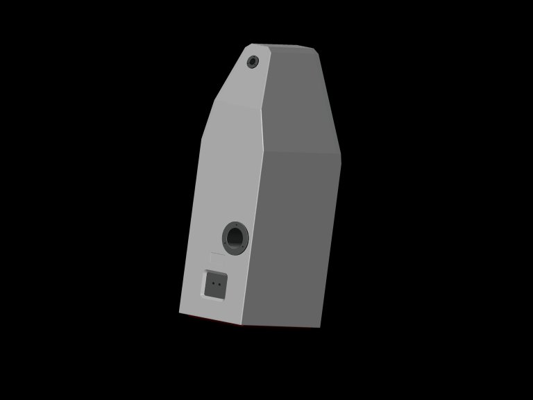

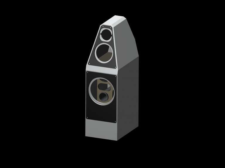

I drew up a complete set of drawings to make a clone of the sophia 2.
All the material is 1/2" solid surface material except the base and woofer baffle which are phenolic resin grade X
My plans differ from the real thing in that the ss 26w driver only needs about 2.5 cu ft. so I don'thave the bass compartment extending into the top half of the speaker the way wilson does. The top cabinet is larger and needs a brace that I didn't draw into the plans. The ports are aluminum pipe ends from mcmaster carr cut down on a lathe and drilled for fasteners. There are no mechanical fasteners. The difraction pad is made from buna-n foam from mcmaster carr. The rear binding post plate is easily made by order from front pannel express.
I have attached a few pics.
let me know if anyone wants the plans.
You will need Alibre Design to view the parts and you will need the mid priced version to view the assembly as pictured.
I think it would be darn near impossible to build these with ordinary wood tools. You would probably need to find someone with a cnc router.
