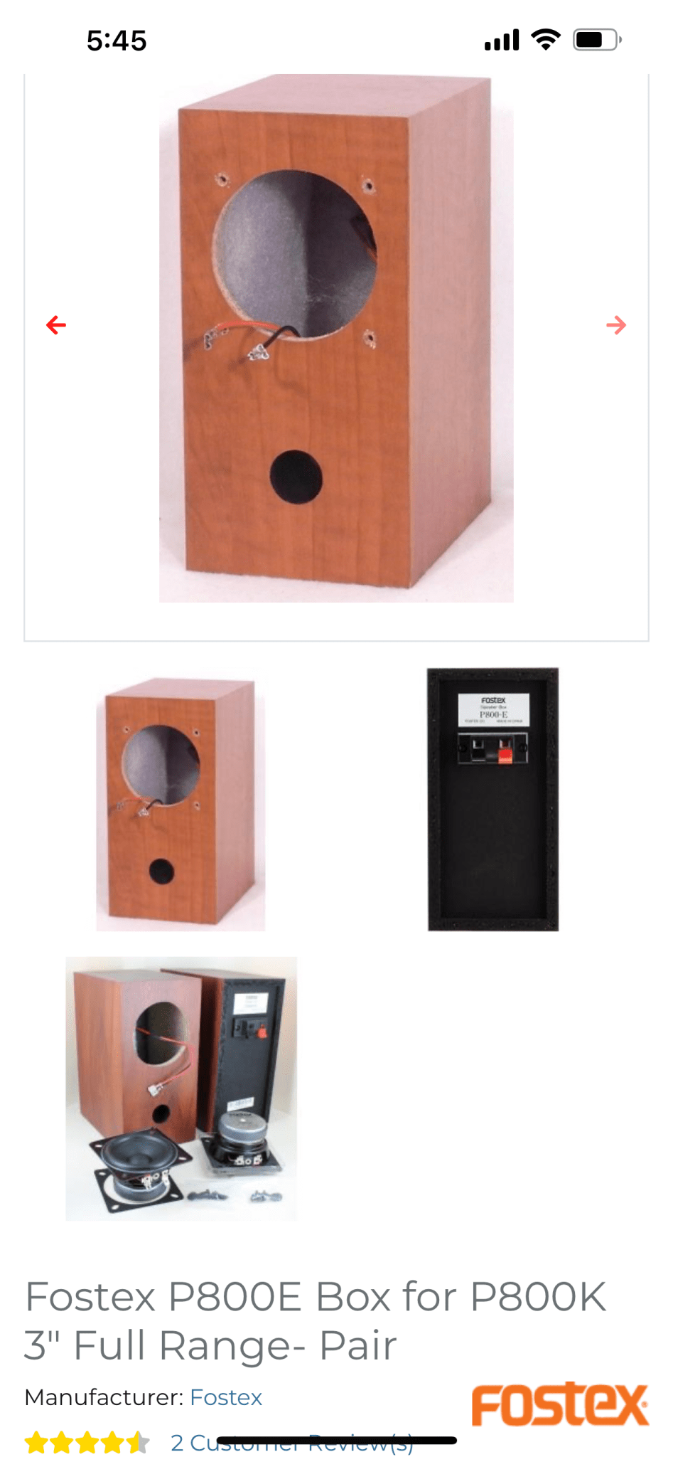

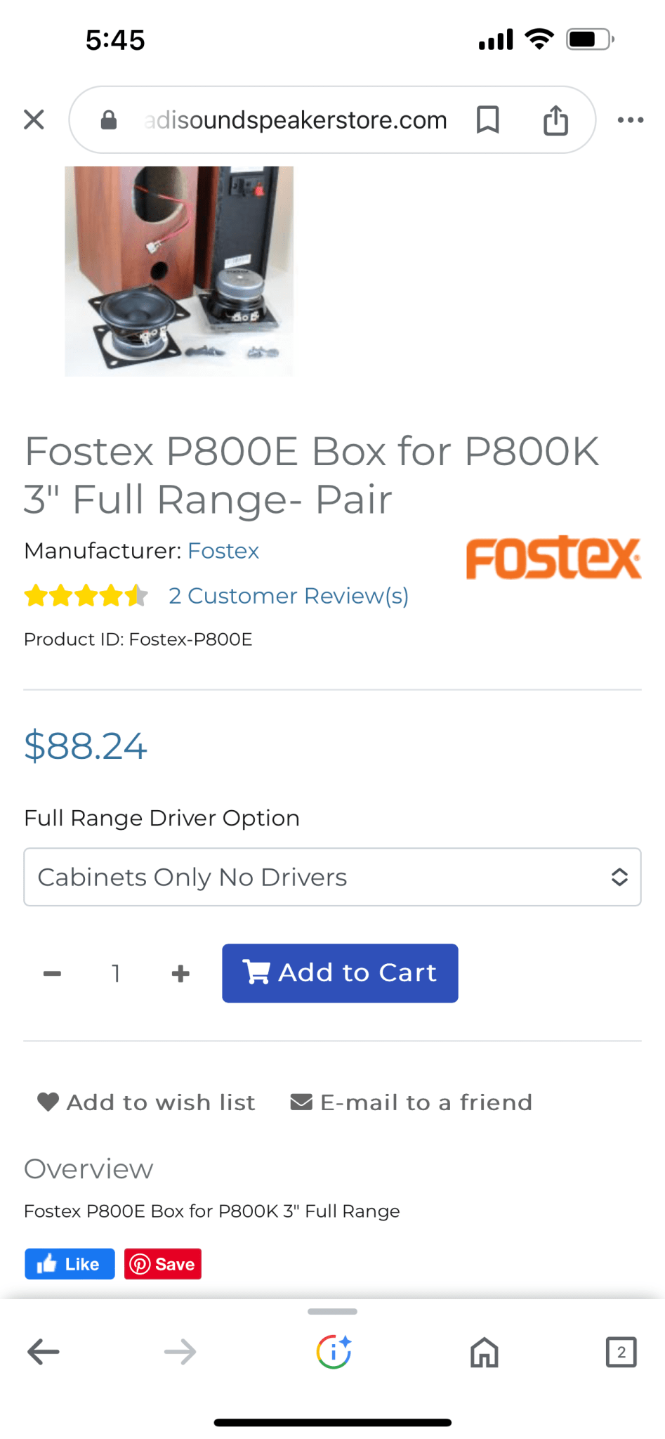

Good evening. Welcome to the forum. 😁. So I bought the cheapest fostex speaker kit from Madisound with the fostex P800E drivers. The drivers were very nice but, the cabinet was very thin and cheaply made. Also the fe series from fostex tends to sound more bright and the letter s is very inhighted in sound. The new series NV I have not heard yet.The Fostex Fe series needs a Horn box to sound their best👍. Ported boxes don’t do them Justice . So here’s a few options for you to get your experience with full-range drivers. So would you be willing to look at another kit from madisound from mark audio? The Tozzi One kit from Mark Audio and it has everything you need. It is a better all around better driver and kit. They are my favorite driver the CHN-50’s driver and best bang for your buck. I posted pictures for you. Again welcome to the forum. Enjoy your start of an awesome path of sound reproduction. Be safe. Jeff
Fostex P1000-E enclosure.
Not a well., thin, unbraced, MDF. built enclosure, but it is best with FF105wk.
If you are interested there are some simple tweaks that smooth out the rough edges.
P800K is 1.86 litre a bit on the small size for FF85wk, A5.3, CHN-50 but workable.
P1000-E is 3.8 litre, smallish for the FF105wk, really to large for the FE103s (haven’t looked at teh FE103NV), but again workable. Ideal volume for Aplair 6.2m, work with A6.2p as well (except the driver cut-out likely too large.

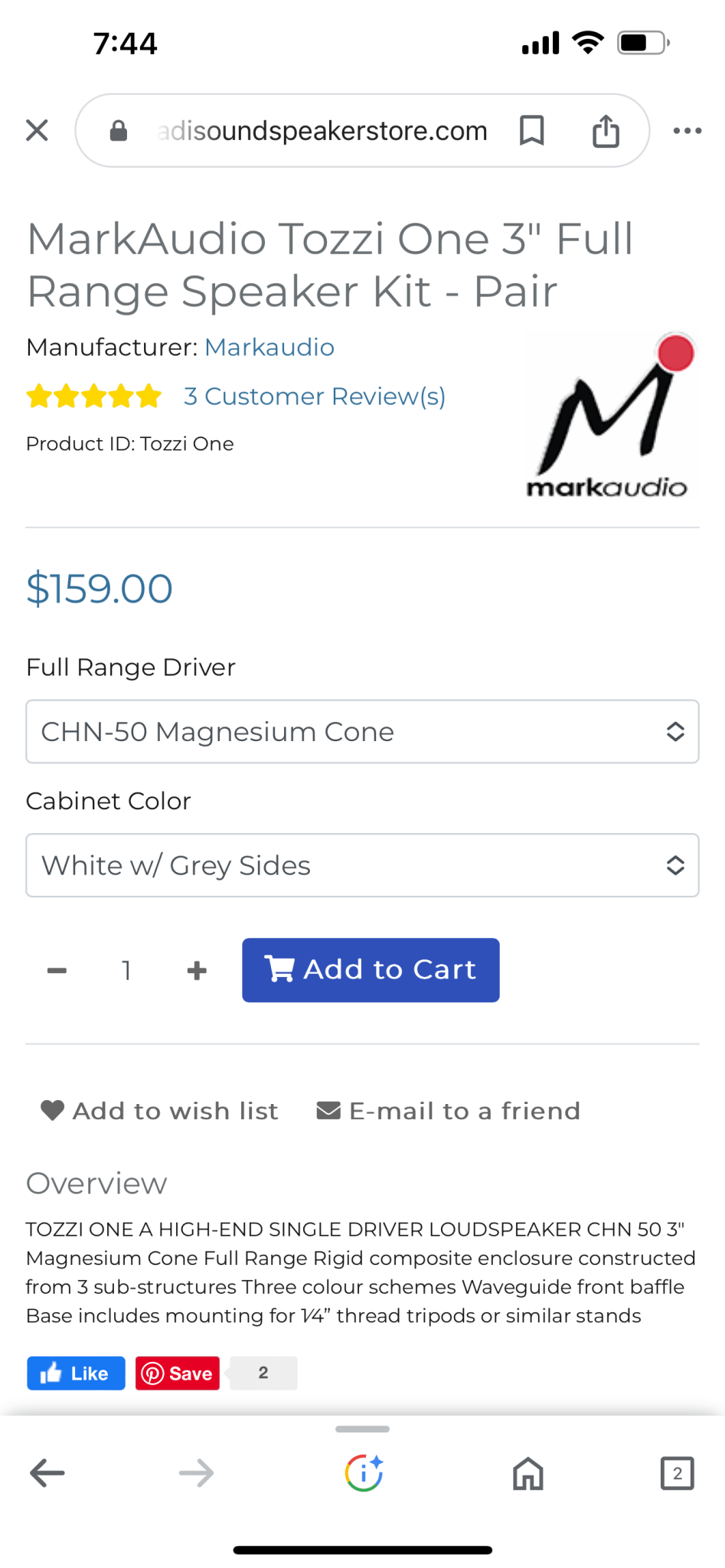

I am in EU, so madisound doesn't work for me, but I've found the Tozzi One kit in EU. The form-factor (wider but shallower) also fits my environment better. And it has a black color option (which is good).
The number of parts scares me, but it doesn't require gluing wood and woodworking tools and skills, so I should be able to handle that
The only thing that concerns me is the driver itself. The CHN-50 is a 4Ω aluminum (as opposed to 8Ω paper fostex) - will it work well with a flea watt SE tube amp? I have a variety of amps from 2W EL84 to potentially an 8W 300B. I've found a paper CHN-50p but still 4Ω. CHN-50 is included in the kit, but I think I've seen the kit witthout the drivers as well, so might use the paper version with that?
Another thing is the size - it's 3" vs 4" fostex (which I thought was not much at all) - is it not going to sound like a mosquito singing or something like that?

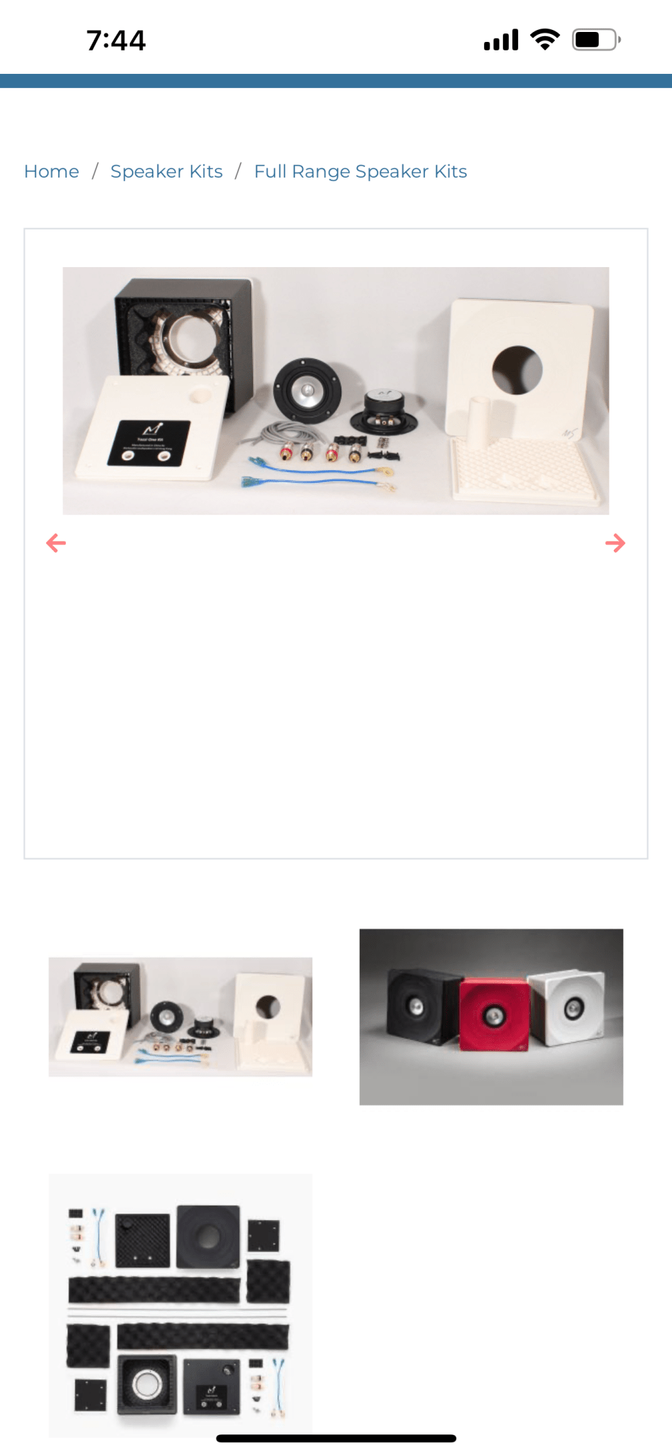

Just had a a closer look at the Tozzi One kit, including the assembly video. Got some further concerns: the P1000-E albeit thin and cheap, is made of something resembling wood, while the Tozzi - just a piece of plastic
The other one is that it comes nearly assembled, and the assembly steps would cost like $5 in China where the kits come from, taking up the same space, so why make this a kit, rather than a finished product?
Don't have DIY experience, but all speakers I've seen come in some sort of wood-related enclosures - plywood, MDF etc.
The reviews are raving however, I think I should hear this thing. Just wondering if switching to a paper cone would be beneficial?
Tozzi is not Mark Fenlon's best effort. In terms of quality not any better than the Fostex box. But assembly (or disassembly) is a piece of cake);
All the 3” Markaudio are 4Ω, even on an 8Ω tap they will likely work fine. But if you hgave multiple transformer taps try them all, use the one that sounds best. The CHN-50 is a great driver, and wheh one considers price, absolutly outstanding. There are better boxes for them but you’d have to build them. This an example (Alpair 5.3, but CHN-50 drops in.

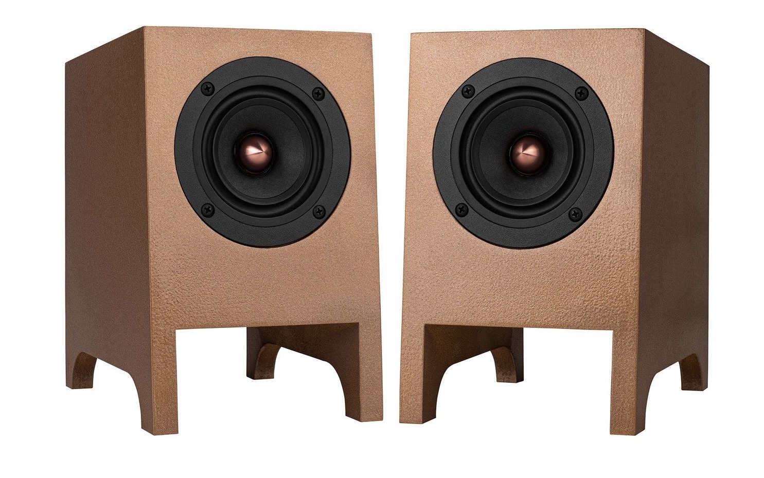

Bird’s eye something. @chrisb Over 15mm murphy ply.
A small leftover bit of veneer left over from some other project Chris’ workplace.
dave
