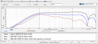

If internal cabinet energy radiates back through the cone in a way which is detrimental, it should be easily measurable with a near field measurement of the woofer or mid driver. Others have said it is visible with empty undamped boxes, and I am sure it is. But with a reasonably damped box, I have never seen any evidence of reflection, echo, or time smearing.

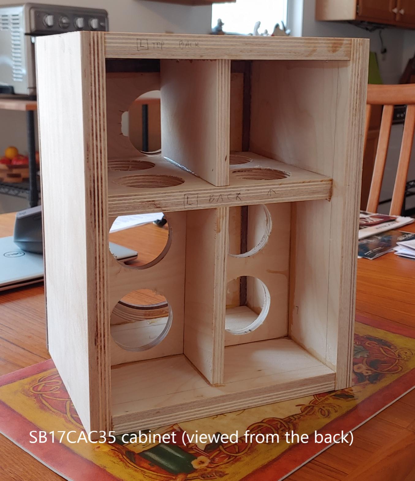

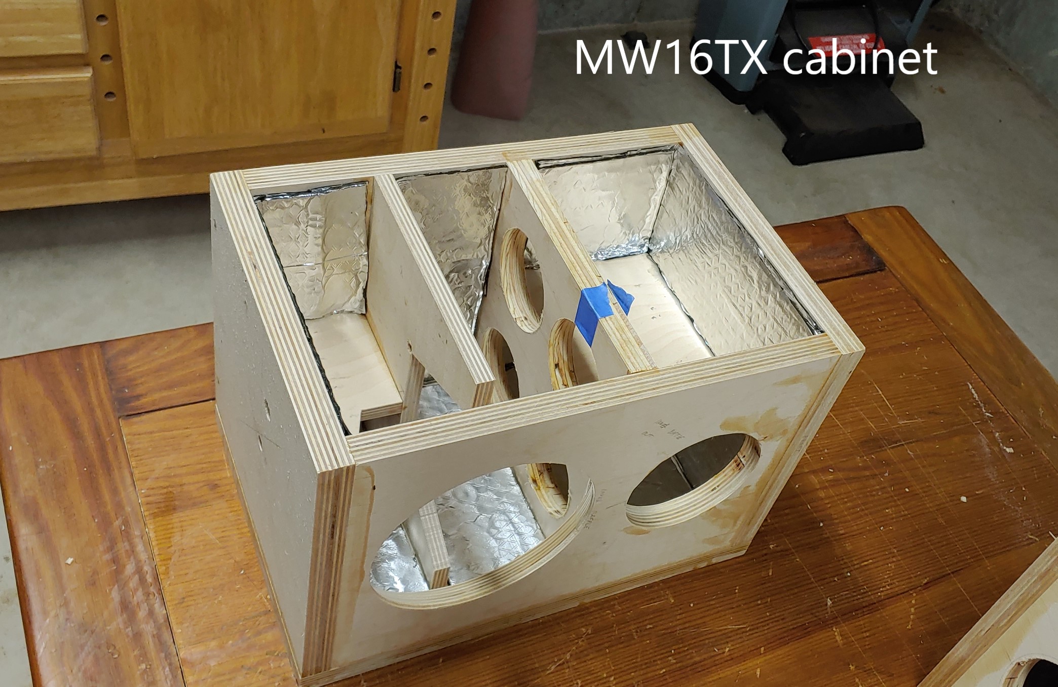

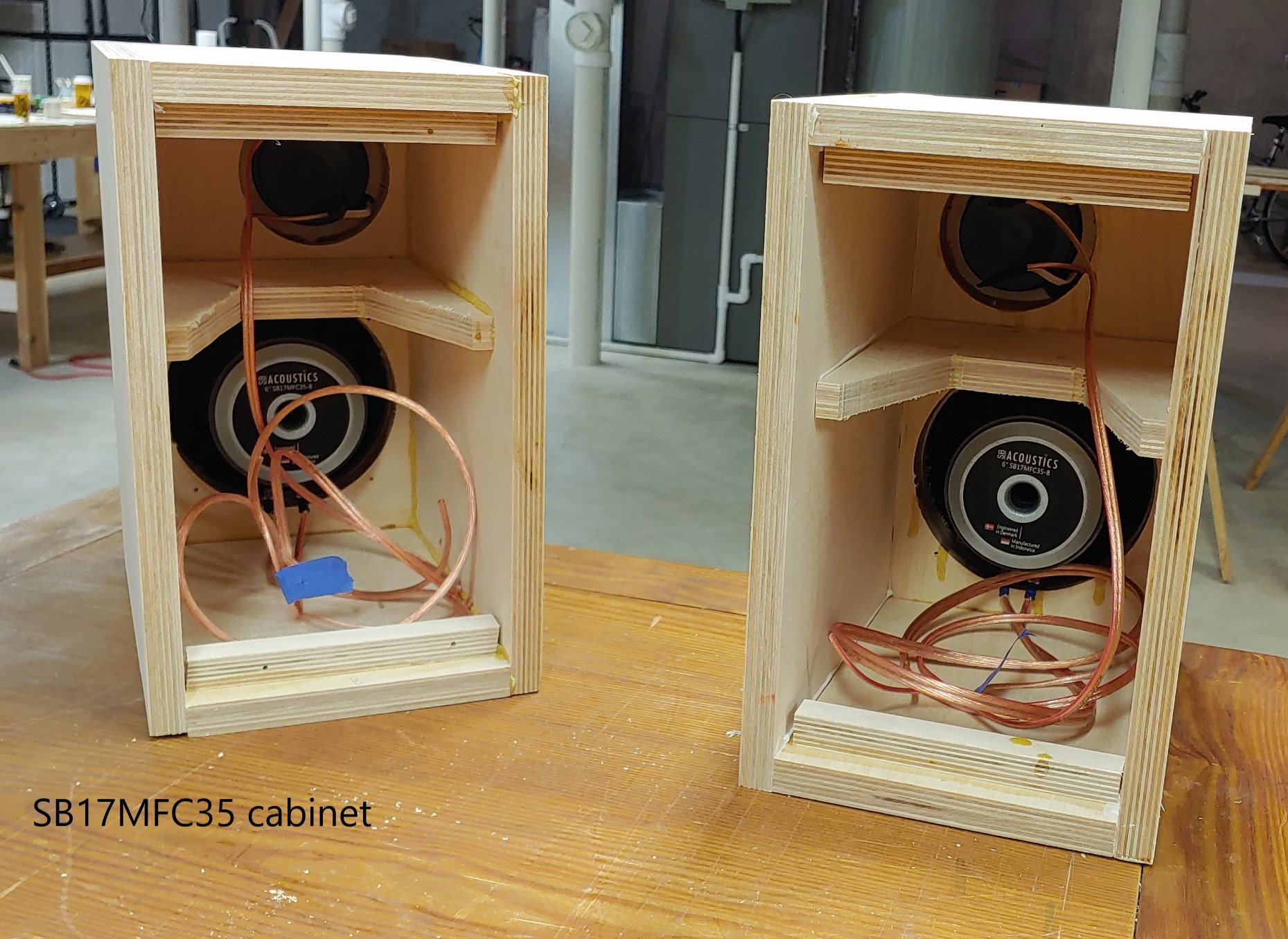

Shown in the first pic is near field responses of 3 different 6 inch drivers in 3 different cabinets. A polycone woofer, an aluminum/ceramic cone, and a carbon epoxy cone. All 3 cabinets are simple box shapes, with lots of reflective surfaces near the woofers, and everything is built with 90 degree angles. All 3 cabinets were loosely filled with fibrous damping material. Other than being very structurally stiff, these cabinets are very conventional.
I just do not see evidence of badness...

Those look very, very smooth. But they don't look anything like published frequency responses from the manufacturers or hificompass
Most OEM published curves are far field anechoic. Most of the driver review sites, such as the excellent hificompass site, show gated far field responses, which are quasi-anechoic. These response curves always have a certain amount of "fuzziness" to them, mine included.
Near field responses, which is measured with the mic about 7 mm from the cone, look different. They are ideal infinite baffle responses and show no diffraction effects. They are typically very smooth, especially if the mic is well calibrated. OEM's and driver review sites rarely show near field responses. When they do show them, they are usually merged into the anechoic response at a few hundred Hz.
