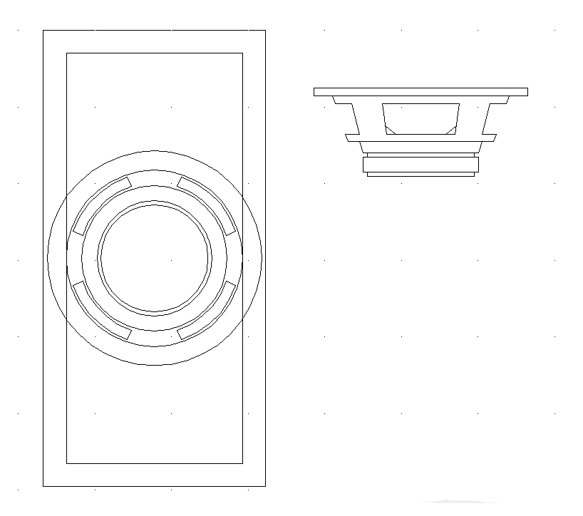

I'm not thinking this looks too crowded.

I don't know why there is the impression that the driver's cone is somehow magically opaque to sound waves. No matter how rigidly the voicecoil holds the cone, it might as well be made of fresh air, as far as all but the lowest frequencies are concerned. Hence the need to obviate internal reflections and standing waves.
Different matter at low frequencies of course.
- completely agree. A tried-and-true configuration that has been valid for 40 years is still valid. Now is not the time to go wobbly [a very wise woman once said].
A cone does not need to be "magically opaque" to sound waves. The energy radiated into the cabinet is exactly the same as the energy radiated to space. Naturally some of the internal cabinet sound is transmitted through the cone, just as it is also transmitted through the cabinet walls. The sound coming out of the cabinet is not corrupted or "un-pure". Unless there is an acoustical resonance (uncontrolled standing wave), there is not difference between the sound inside and outside the cabinet. Acoustical resonance is easy to control with acoustical damping.
