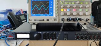

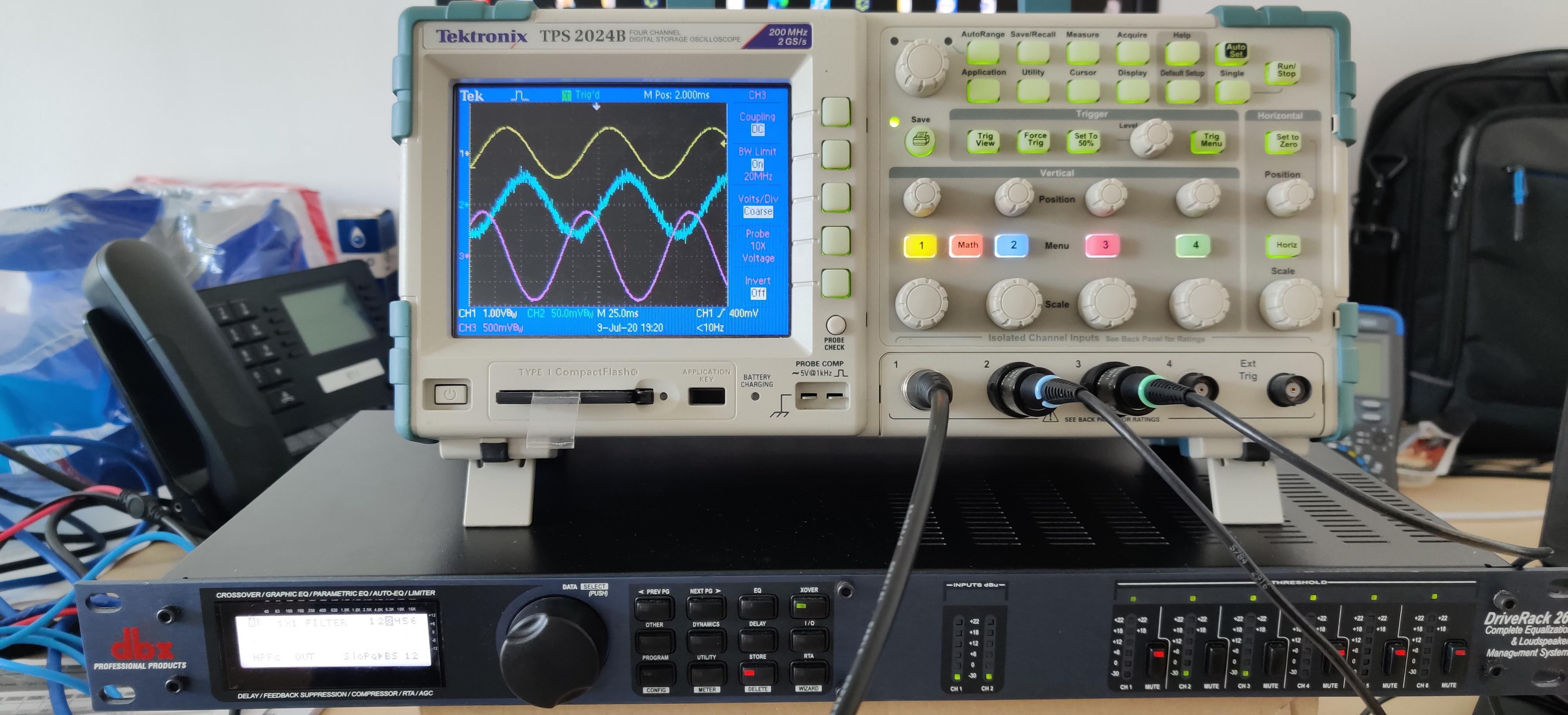

Driverack 260 seems to completetly mess with the phase if the high pass filter is disabled. What do you expect when you change the characteristic of a high pass filter that is set to "OUT"? I expect no effect on phase and magnitude. Next post is 2 photos, taken with exactly the same setup, input signal YELLOW (10Hz), trigger on input signal, output 3 signal in PURPLE,
First pic is output 3 HPF set to "OUT" and "BS6", 2nd photo exactly same with output 3 HPF set to "OUT" and BS12".
What is your opinion?
fotos....

Looks like the output phase is inverted in the second picture. Looks like 90 degrees of phase shift even in the first picture. I’m not familiar with the Driverack, I have only dealt with the Behringer products. I’m not sure what BS12 and BS6 mean.
I’m not sure any of this would be audible at 10hz. At such a low frequency there could still be a basic HPF in the circuit that is affecting phase. It is not Normal for PA or band equipment to be wanting 10hz in the mix, quite the opposite actually.
Of course, I am close to the LF rolloff. Of course, there is big phase shift. There is also AD - DA delay, etc.... All true, but my message is, that a filter CHANGES the phase shift significantly, dependent on it's steepness setting, although the filter is set to be out of the loop.
I am not talking if I "want 10Hz in the mix" or not, I am talking phase shift that is affecting the lower audio band, like 8Hz up to ~30Hz, maybe even 40Hz. It may not be an issue in typical applications, but the firmware implementation is not "clean" in the sense of showing a different signal flow chain than actually providing.
P.S.: BS6 and BS12 is Bessel 6dB and Bessel 12dB. BS6 is same as BW6.

To sum up, since no one seems to understand:
There should be no difference between the 2 screenshots I posted, since the difference is ONLY an order setting on a filter that is OUT OF THE LOOP! Or is labeled as "Out". If they renamed "Out" to "10Hz" or whatever it actually is, I d be happy with how it performs. It is just that "OUT" does not explain what I have experienced.
