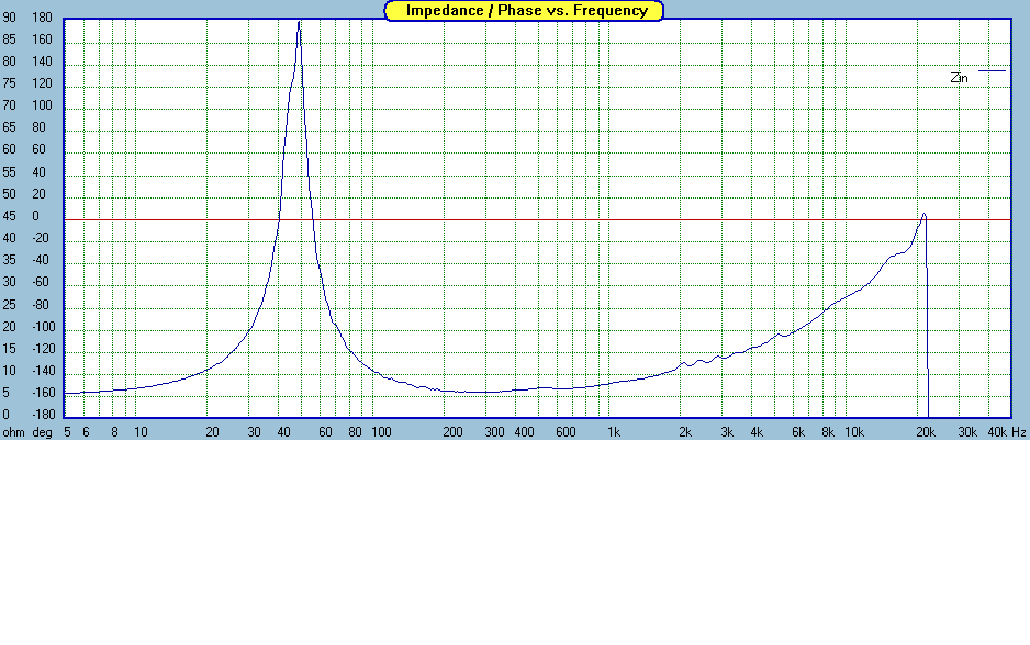

- Here's a pic ( actually a collage made using your data ) of the GPA 414 . This was "assembled" using "Paint" & "PowerPoint" .
- This is the size of pic I like to view using a 40 - 50 db vertical scale. It does offer better resolution .
>< cheers 🙂
ps; I don't find your "gated/MLS" results very worthwhile since it is obvious to my eyes that they have a lot of smoothing below 1K ( regardless of the formulas ) .
The gate does introduce a smoothing type effect for the typical gates diy'ers must use. So yeah, that's why nearfields are useful for <1khz. Above that though I think the gated farfield are more accurate.
