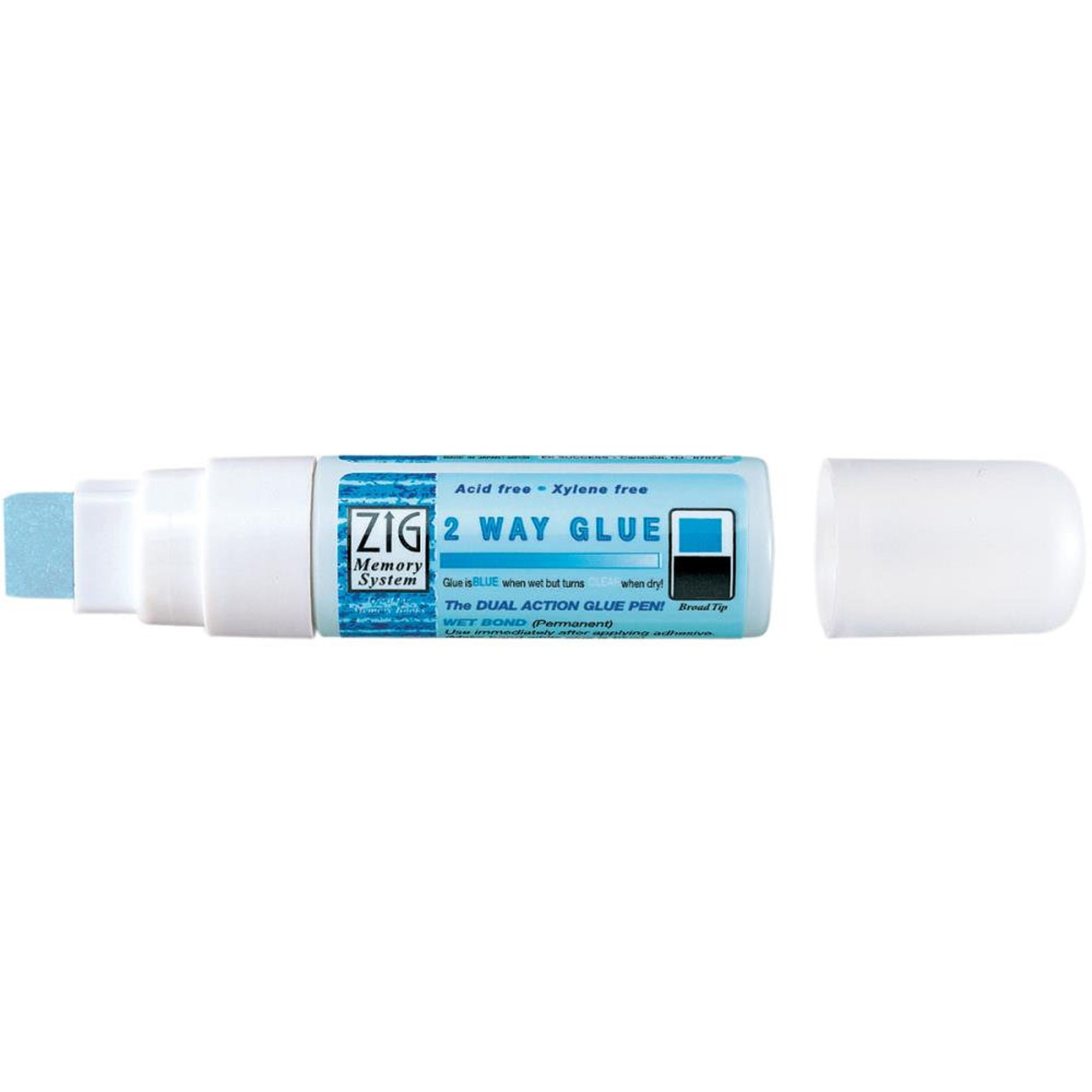

If you read the link you would see it's an edge-coating to the cone and part of the roll-surround. Many soft-cone midbass drivers have an issue with edge resonance around the 800Hz - 1.5KHz region, give or take. It's not actually the surround that's the issue, but the flexible cone edge going out of phase with the main output and causing cancellation, plus, as you would expect, a spike in HD2 at the same frequency. By applying edge-damping to some units, you can control that and improve the linearity of the midband, as Troels does.
Aleene’s=!
2-way ZIG glue.
It is useful. I don’t use it on the surround, bu tit is good at the cone, surround interface on the backside of the cone on the FFxx5wk series, and helps on the outer edge of a whizzer cone.

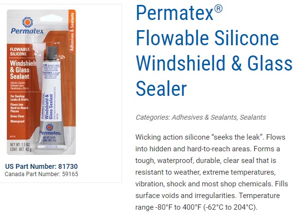

One some smaller speakers, and larger woofers, I've used a thin coating of Permatex Windshield Sealer on the surrounds, which helps tame resonances, and on woofers with cloth surrounds it re-seals them when used in air suspension systems.
Works quite well with the accordian type surrounds too.
You lay down a small 1/8" bead around the speaker, then work it with a small brush to spread it across the surround.
Keeping the speaker face up for a few hours, once it drys, it works minor miracles.
Stays nice and pliable as well.
