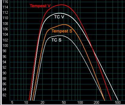

This is a quickie ... Tempest vs TC2+, sealed vs vented, each with rumble filter and low pass @ 70 Hz.
Tempest sealed 100L
Tempest vented 200L @ 20 Hz
TC sealed 75L
TC vented 120L @ 20 Hz
Not necessarily optimal designs, but an indication. Eq used for the sealed subs to get a similar response.
Two TC12" subs are almost identical with this setup to a single Tempest.
Chart shows max SPL as limited either by xmax or amp power. Aargh, just remembered that the TC is 4 ohms hence for one driver there will be 3db less output for the vented version, but the sealed version won't be affected.
It's a beauty and the best comparison. Clearly from a bang for buck comparison point of view, the Tempest wins easily. The TC has shorting rings and almost certainly lower distortion, although this is offset by the Tempest being a larger driver. The TC is going to be a lot prettier to watch move.

You miss my point Paul. I'm not talking about desired amplifier power, voltage or current limits, nor non-linear distortion characteristics near clipping. I'm not talking about a specific driver's Pe (voice coil's thermal power handling) rating.
I'm talking about a driver's maximum in-box, excursion limited maximum SPL.
Linkwitz provided a better explanation than I could ever do, when he describe his Thor subwoofer design.
http://www.linkwitzlab.com/thor_splmax.htm
There is a way that you can maximise your SPL with your current available amplifier. You don't always need a bigger driver, more xmax or more amplifier power.
Here's an example of choosing a 10" over a 12" to get MORE maximum SPL, when using a fixed amplifier and desired box size- http://www.linkwitzlab.com/Pluto/subwoofer.htm
Since Big Kev already has chosen his amplifiers, I strongly recommend he use Unibox or Closedbox.xls to explore this further.

Linkwitz was talking about a sealed box which would tend to limit power required and SPL capability. For a fixed box size, sealed box and a given amplifier, the bigger driver won't necessarily have more SPL.
However, the only fixed entity is the amplifier. He may choose sealed or vented, one or two drivers, a small or large box. A vented box will most likely benefit from more power, not that this is relevant now since amp is already chosen. For a given amount of power, a bigger driver and bigger box will most likely mean more SPL, although of course, it depends ...
So am I since this is what counts - the only max SPL that counts is what you have considering thermal and xmax limited power, as well as amplifier power.

For max SPL and depth, a Tempest 200L vented box does it well. Use a 6" vent (PVC) and it will keep turbulence down without being too long. The box could be approx 450 x 450mm footprint and 1.4m or so tall. Yes quite large, but it doesn't occupy too much floorspace.
With the rumble filter the air velocity peaks at around 19m/s - ok if you have decent vent flares.
You can achieve 115db in the midbass and exceed 110db @ 20 Hz, 113 db @ 25 Hz.
If you go with the TC2+ in a 100L vented box, you can reach 109 db in the midbass and 103 db @ 20 Hz, 107 db @ 25 Hz.
Vent velocity is quite low with a 6" vent, lower than the Tempest which requires more attention to the aerodynamics to avoid chuffing. 6" vent must be 1m which is long, but possible.
If you go with two of the TC2+, then the size will be the same as the Tumult, and you will reach 115 db in the midbass, 109 db @ 100 Hz and 113 dB @ 25 Hz - essentially identical to the Tempest response (almost).
