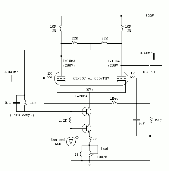

Attached is a phase splitter with CMFB I've adapted for a 6V6 amp, based on Fred Nachbaur's (RIP) tube version at: http://dogstar.dantimax.dk/tubestuf/driver02.htm

Geek, the circuit you posted looks like a hybrid version of something I was interested in from Glass Audio. They used a tube to read the balance error of the dif stage and feed it back to correct it. The way it looked, I think it could do two things, provide whatever level of balance you want for the next stage and make sure the two phase signals are exact mirrors of each other.
Hi Tubesman,
That is exactly how this works.
I put it through it's paces on the bench, using various tubes with matched and unmatched sections and the highest imbalance was 20mV with 60V P-P output swings per tube. Without the CMFB, the imbalance was 5V at that output level.
Another advantage of this circuit is you do not need to buy tubes with perfectly matched sections 😉
Finally, the current setting is a lot more stable and far less touchy to adjust.
Cheers!

Hey Geek, I guess I'm not as stupid as they say I am! Seriosly, the GA circuit put a trim pot in place of your pair of 22K resistors so that balance can be set to whatever is needed to null out the full amp. I like this hybrid better. Any data on the distortion and SNR of this design?
Sure, drop a 1 to 5K variable between the two 22K resistors and see what you can do 🙂
Didn't bring the breadboard to the computer that night, so no figures there.
But I can tell you that noise perceptibly dropped to around 1/4 compared to a resistor in the tail and dropped noticeably compared to without the CMFB.

Works for me. I wanted to use a circut like this in my amp. I think I'd like to try it with either a 6SN7 or a 6DJ8 and decide on the one I like better. I found my Lynx One sound card so I can do a distortion /SNR test on it.
If you go 6DJ8, just drop the B+ from 300V to 200V, have 100V on the plate, adjust the plate resistors accordingly and away you go 🙂
Yeah, that's why I used a hybrid, as my maximum available V- used for the output bias was -27V 😉
You might want to try various transistors of highish beta too. I tried various 2SC from scavenge and used 2N4401 in the final design. Low hfe (less than 100) didn't work as well.
