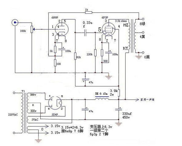

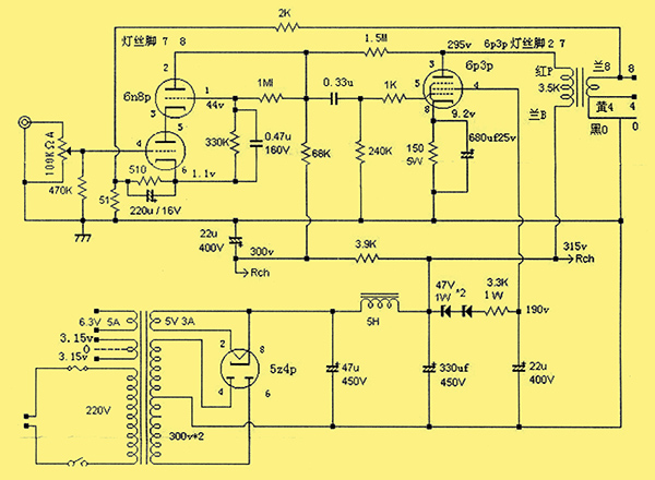

Yes you can get about 7W in pentode mode and 3.5k OT. I like 6SN7/6N8P driver sound and I can almost hear the same sound signature with other output tube or topology, either cascode 6SN7 or single section 6SL7 or similar can drive it to full power. You notice the screen supply voltage has been lower from plate supply(315) with zener or resistor by about 100V to 190V.

The second circuit seems to be more interesting, the screen of the 6p3p is well regulated with a series of zeners even though I'd have put maybe a MKP capacitor to ground.

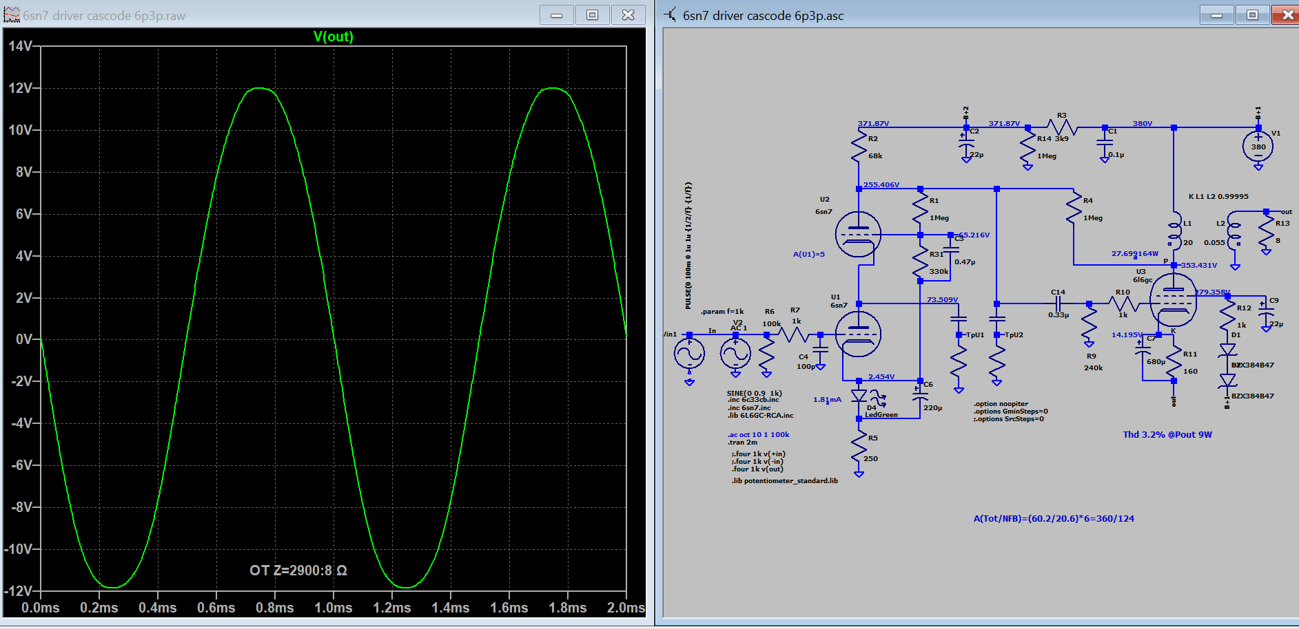

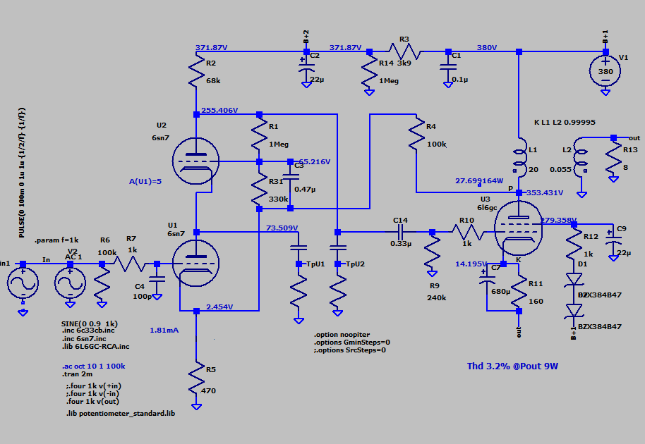

You can use a lower OT Z of 2.5k with additional modifications, but preferable use a tube with high dissipation say 30W 6L6GC/6LGT :
1. Increase Schade or shunt feedback (Change R4 from 1.5Meg to 1Meg)
2. Add Cathode feedback (wire output tube cathode to output instead of ground). Doing this reversed the output phase and you can not use NFB but that is ok as I modified the driver to use more local feedback instead to reduce distortion. You can read more about Schade feedback in this thread:
Schade Feedback
I can post the simulation file is you want it.
I didn't consider yet about a cascode circuit, but as shown in your graph it seems to work well with 6SN7, 9W is a good power notwithstandig the feedback.
It reminds me in someway the Abdellah/Gendrano schematic, except the driver stage.
Clearly a higher voltage is needed, but I have to see if my OT's are enough for this and the power tubes 6L6GC 30W. I think in that case with almost 100mA (87+10) of current flowing through the tube a 20W OT would be better than actual 15W.
I noticed also a hundred pF input cap for compensating Miller's effect and the use of a led in the driver cathode (lower noise I guess), so I'll put "in the to-do list" this circuit...
I think that in the schematic of Mona the current through the 6SN7 has to be 1.53 mA, so the indicated 1.81 mA must be a 'left over' from the schematic of Koonw.
I(R5) = V(R5) / R5 = 2.454 / 470 = 5.22 mA
I(R1 + R31) = V(R1 + R31) / (R1 + R31) = (255.406 – 2.454) / 1330000 = 0.19 mA
I(R4) = V(R4) / R4 = (353.431 – 2.454) / 100000 = 3.5 mA
I(6SN7) = I(R5) – I(R1 + R31) – I(R4) = 5.22 – 0.19 – 3.5 = 1.53 mA
This outcome fits with
I(R2) = I(6SN7) + I(R1 + R31) = 1.53 + 0.19 = 1.72 mA
and
I(R2) = V(R2) / R2 = (371.87 – 255.406) / 68000 = 1.71 mA
