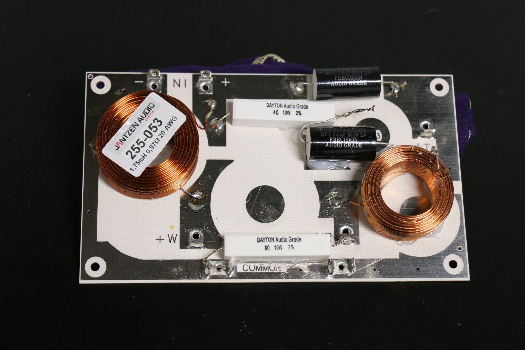

I would be interested in seeing a sketch of the schematic of your simple 1st order crossover, as well as the picture you have promised.
Let's also have a picture of the "really well made" cabinets that you say make this venture worthwhile. 😎
You cannot see the picture in post #33?? https://audiokarma.org/forums/index...-crossover-advice.968615/page-2#post-14996908I would be interested in seeing a sketch of the schematic of your simple 1st order crossover, as well as the picture you have promised.
Looking at that picture there are two coils. They are different sizes so this must be one channel. The two resistors seem to be standard values for an L-pad for a tweeter. The two most likely possibilities are either a coil on the woofer and C-L-C for the tweeter... or L-C and C-L.

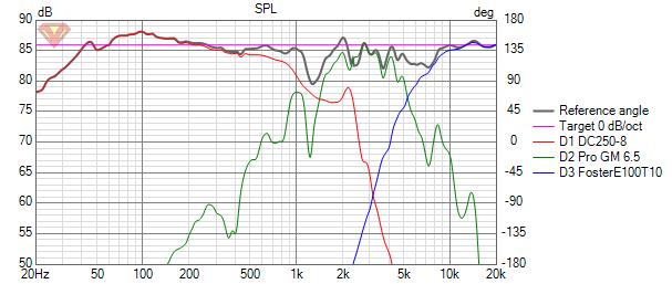

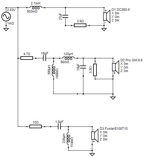

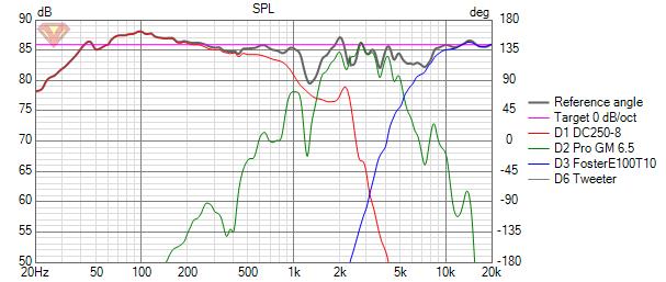

I would try a cross over simulator
The Dayton has a significant peak in upper response
Not a super big deal, but likely 2nd order is needed.
I found the data sheet for the 6.5 inch mid and have a trace FRD response
its a good solid 93 to 95 dB driver.
So will be a fun one
Its my friday night so im playing around with a crossover design
I will post the FRD and ZMA files for the drivers in another post
