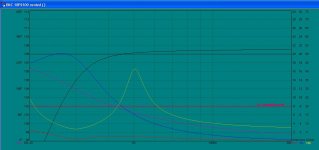

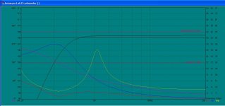

What I was trying to say is illustrated by comparing the Eminence LAB15 with the B&C 18PS100. The LAB15 is in a 2.5 cu ft vented box and the 18PS100 is in a 7.5 cu ft vented box. Both have -3dB points of about 32 Hz. The LAB15 has a sensitivity of about 88dB and the 18PS100 is about 94dB. In the simulations, both are producing about 108 dB output. The LAB15 requires 100 watts to do this whereas the 18PS100 requires only 18. Cone excursion on the LAB15 is twice that of 18PS100. So, it seems to me that the 18PS100 (together with using the same amplifier as the LAB15) is going to produce a lot less distortion than the LAB15. Distortion in subwoofers is very important in my opinion because of the Fletcher-Munson curve. Our ears are far more sensitive to the higher frequency harmonics of subwoofers than of tweeters, for example.
are we seeing the effect of differing cone areas (Sd) or is it due to different box volumes (Vb)
Doesn't this contradict what GM has said regarding frequency response and distortion?
How so?
GM
I suppose I should have used another 15" driver for a more clear comparison. All I'm saying is that the lower cone movement and less amplifier power required by highly sensitive drivers means that the subwoofer should produce sound at a lower distortion for the same SPL.
