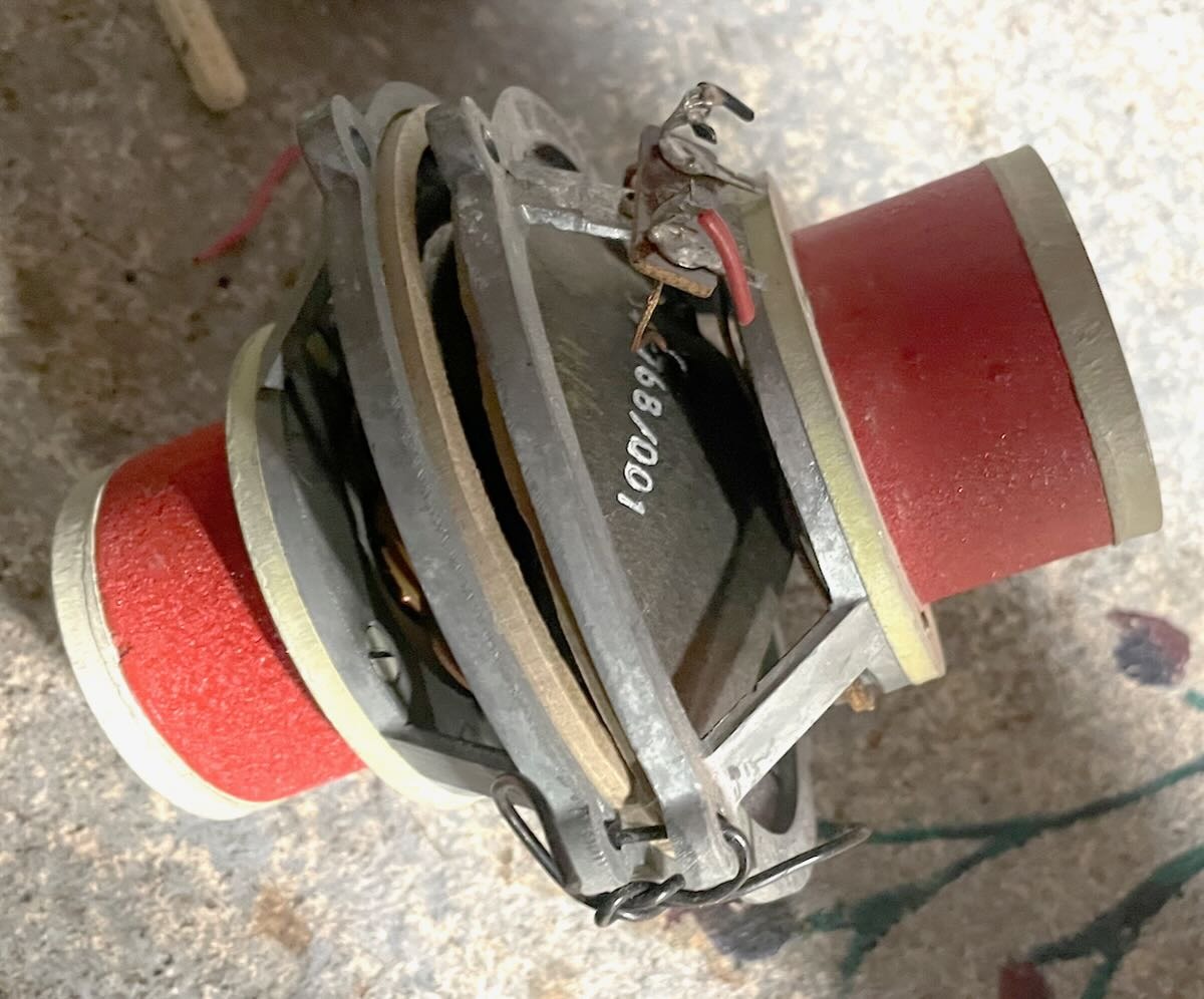

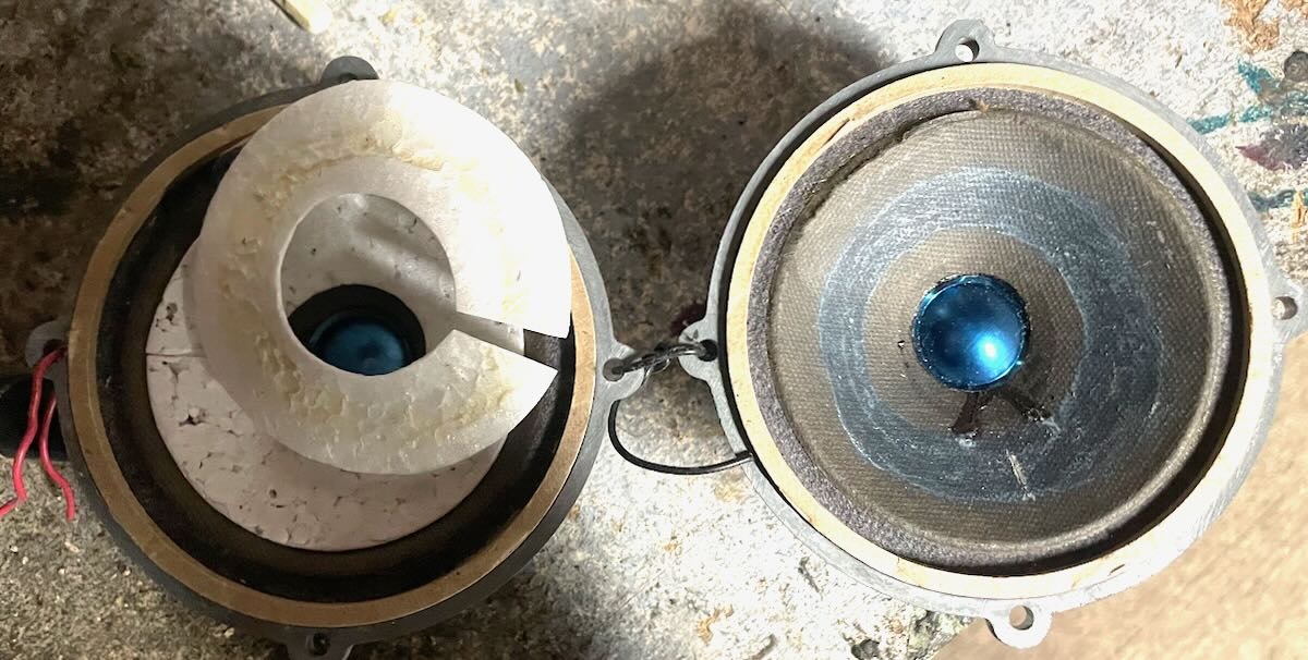

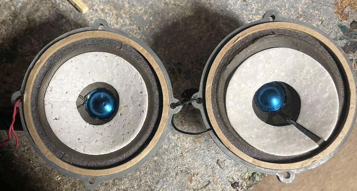

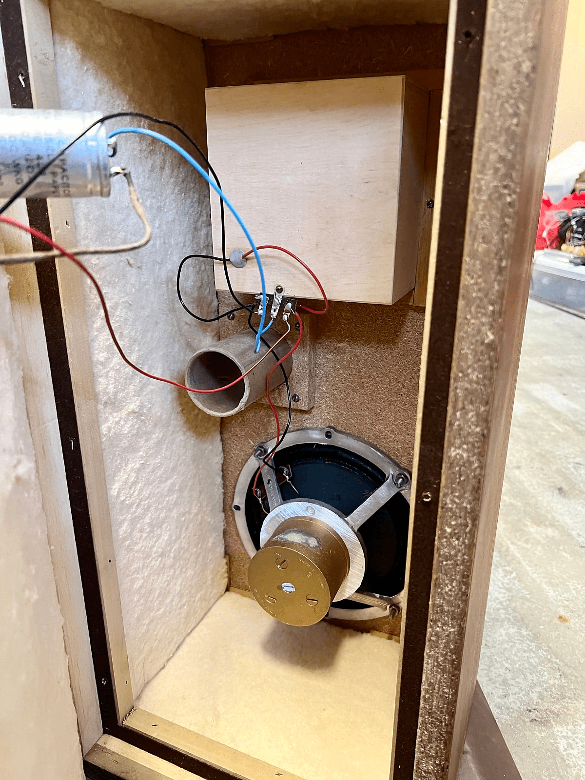

I picked up a pair of Wharfedale speakers from my local recycling center recently. Upon hooking them up I realized one is completely missing any mid-range/bass. After taking it apart I found the mid-range driver to have no resistance across the terminals. The cone is also completely seized.
After doing some research I've come to the conclusion the voice coil probably overheated and is now completely dead. I've found a couple resources on replacing a voice coil, and I think I can pull it off.
I was hoping I could get some advice on where to find a replacement coil for the drivers. I also need help identifying the model of the driver and the speaker it came from. I looked everywhere, but there are no markings besides the brand name. I've attached pictures of the dead driver and the speaker it came from below.
If anyone has any recommendations for a guide I should follow, or any other ideas on what I could do to repair this I would greatly appreciate it.

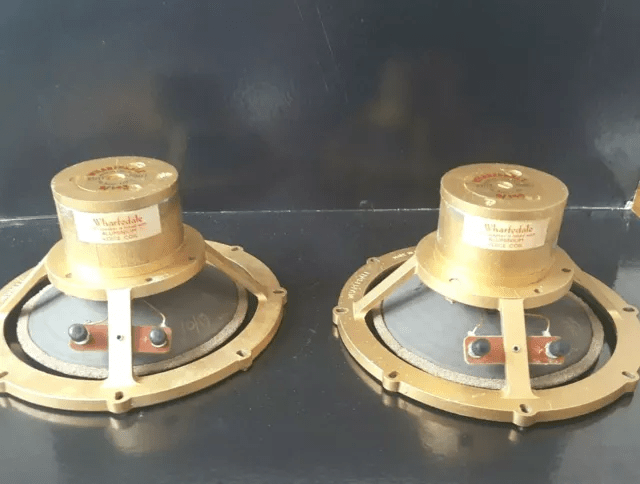

Peering through the grill cloth it looks like there are two drivers, in which case this could be a Wharfedale W2 loudspeaker.
The W2 has a 12" woofer, the WLS/12, and a modified Super 5 treble unit (crossover at 1 kHz) with the golden magnet.
If it is a W2 then the enclosure dimensions are 23.5 x 12 x 14" and there's a treble control at the back.

The speaker appears to be a variant of the Column 8/145 speaker. It has the same cone but not the flat plastic foam surround and aluminium dome of that model. Wharfedale speakers that were assembled in North America often differed from the British originals. The faulty coil would most likely have been wound with aluminium wire (15 ohm impedance). The internal diameter of the voice coil should be 1.025''.
Loosen the magnet assemby screws, be carefull for your fingers. Take it apart and see what's wrong first. If you are lucky you can rewind it by hand that way, measure wire thickness and count turns while unwinding. Use a little glue fixing new windings.

Do not do this as the screws at the rear hold the magnet together.

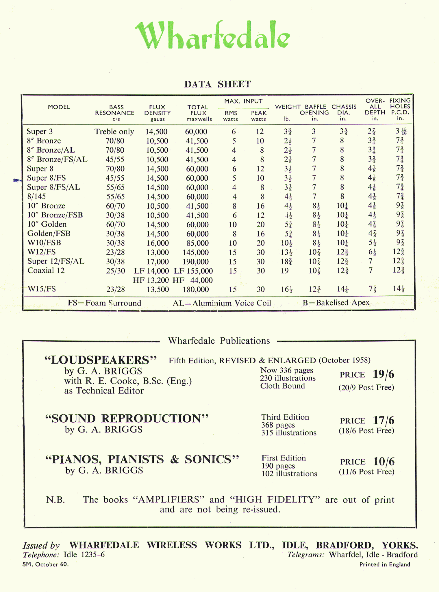

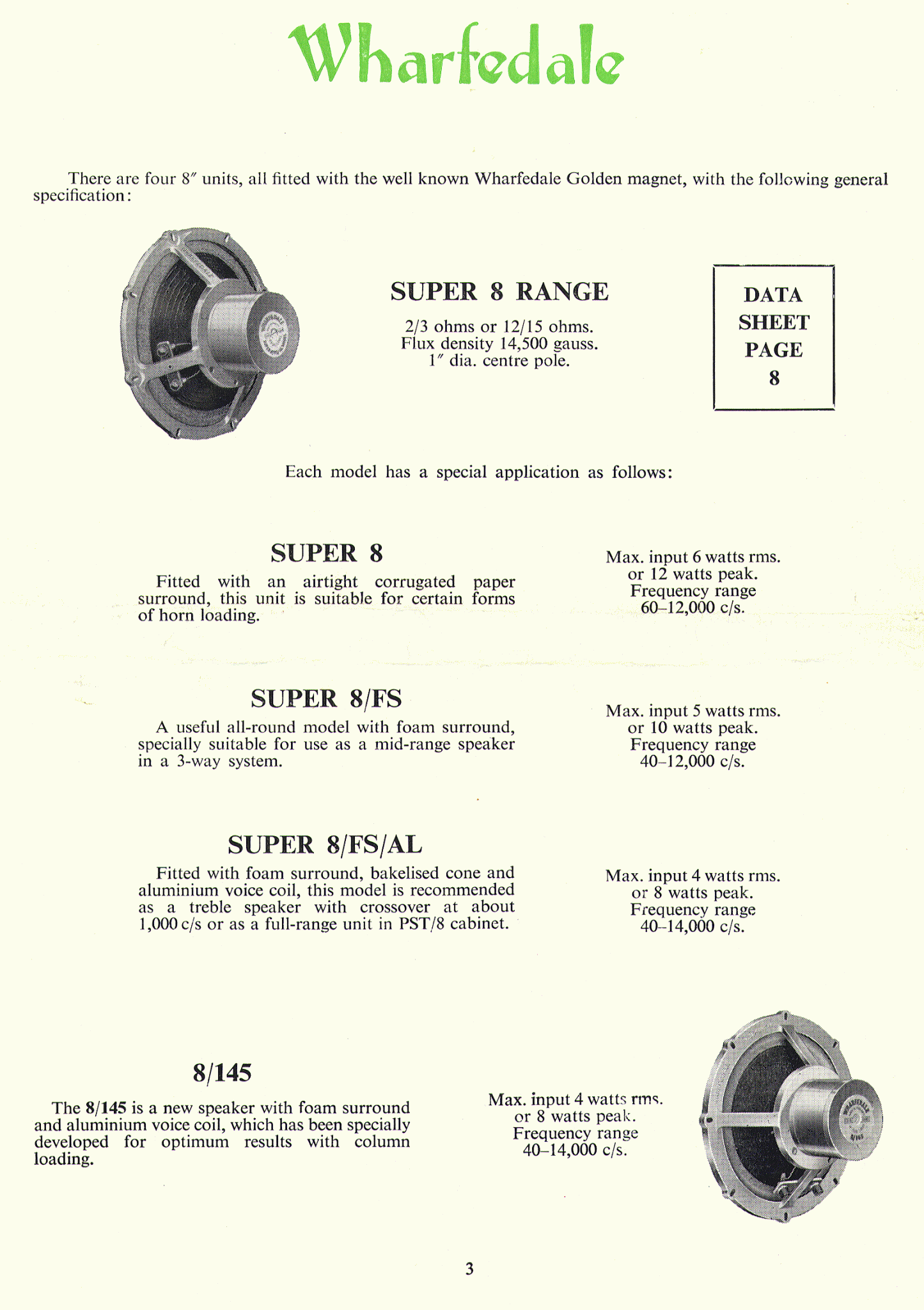

We await dimensions of the mid/bass driver from @rosetheld, but it looks to be one of the early Super 8 Range which are all fitted with the Wharfedale Golden Magnet - see the first (large) attachment. The range includes the 8/145 driver to which @VaNarn referred, and which is pictured below.
Observing the respective cone surround materials and intended applications of each of the drivers in the Super 8 Range, it seems possible that The OP's driver may be an 8/145 that has had a surround replacement in the past, or is a variant of that model.
The second (large) attachment shows the Data Sheet.
