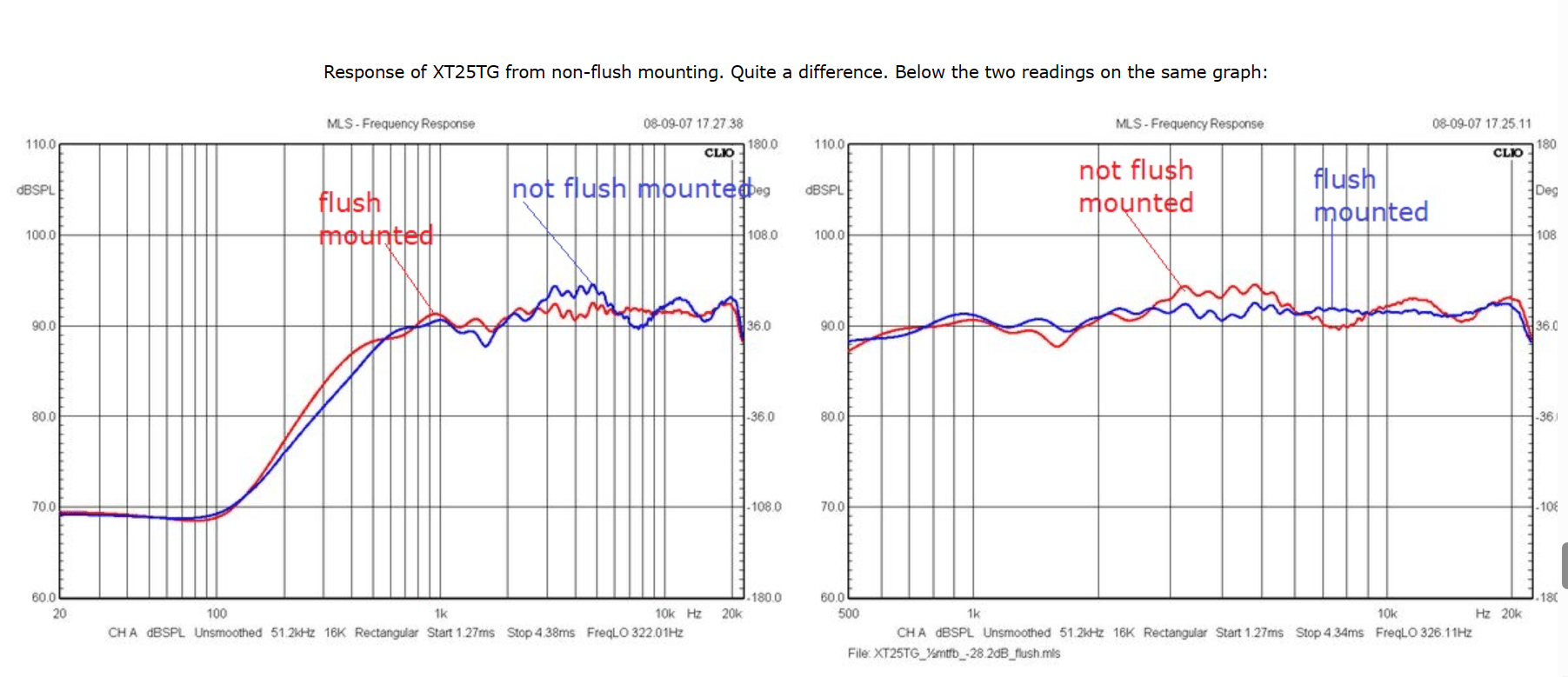

A surface mounted tweeter with a circular flange will usually have a diffraction induced response variation of +/- 2 dB from 3k - 10k. This may or may not make much difference. If a design has other diffraction reducing features, such as large radius baffle edges, or deep bevels, the surface mounting of the tweeter may wreck all these benefits. On the other hand, if the design has sharp edges on the baffle, or a grill frame with reflective surfaces, then a surface mount tweeter may not be very detrimental at all.

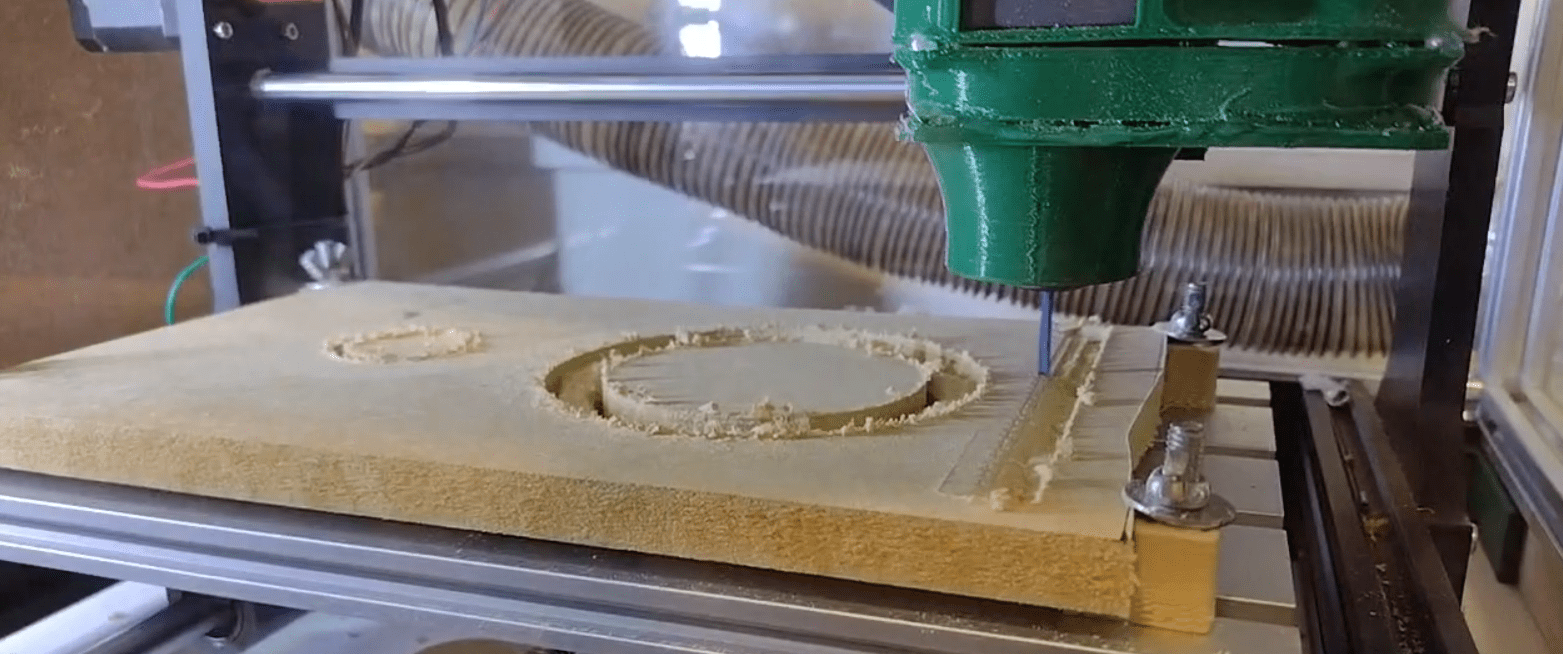

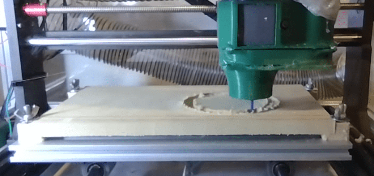

I got a small 3018 CNC so that I could build small speaker boxes. Recessing was a motivation. I live in an apartment and it's hard to use the router without making a mes.
Then I got a 3040 that I have in a big box for soundproofing and dust management. Daughter for scale.
And I got a used one that is bigger that I need to install when I get the time and make the space.
It's a lot of work but it's great to be able to design and then get the pieces you need.
Downsides:
  • Need to learn CAD
  • Need to learn the tricks. For instance, you need to cut fast and make chips and not dust. It's easier for the machine to go fast.
  • Needs space
  • Produces noise, dangerous dust and fumes that you need to deal with
  • You need to be able to fix and build stuff for the CNC. Like the people who own an old car and know how to fix it. If you don't know basic electronics it's hard to service a CNC.
  • You need to sand a bit and also paint, you need to be careful.
  • What I paint is not pretty.
  • Get distracted. Another rabbit hole that distracts.
Advantages:
  • Build fast when you have an idea, build what you want. I had a few boxes made and it took them a lot of time to make. They do a great paint job but it's too much time. Woodworkers usually have a lot in their plates.
  • It's nice to have repeatable precision.
  • Design once, cut many times.
  • Learn interesting stuff.
I hope to find a place where they help me sand and paint what I cut. Not there yet. Maybe not hard but I haven't checked.
Do you have a reference for that?
I'd change that to 'crossover to beaming' given that many 25-30mm tweeters can cross somewhat lower and may start to beam before that. My reading of what you are saying is that this is based on diffraction at the rim of the tweeter's flange, and is not considering the nearby (mid)woofer, which will provide a source of difraction and reflection even if it is flush mounted.
My understanding is that what people do in practice does not actually meet the reality of 'large radius', though I'd have to have a good session with a search engine to find evidence, I suspect. A small one might be cosmetic depending on the finish - it is going to make veneering harder. And painting.
If we accept that cabinet edge diffraction is a thing - and then we get a crapload of reflections in room as well - it may be that the +-2dB is a minor effect and the smoothed response for trend line is more important. After all, if you look at high frequency plots from conical structures, whether coax, horns, or full range drivers, they all show significant deviation from flat on axis and I believe these are early reflection artifacts and they don't actually matter in the big picture, given the evidence that these can be very satisfying.
