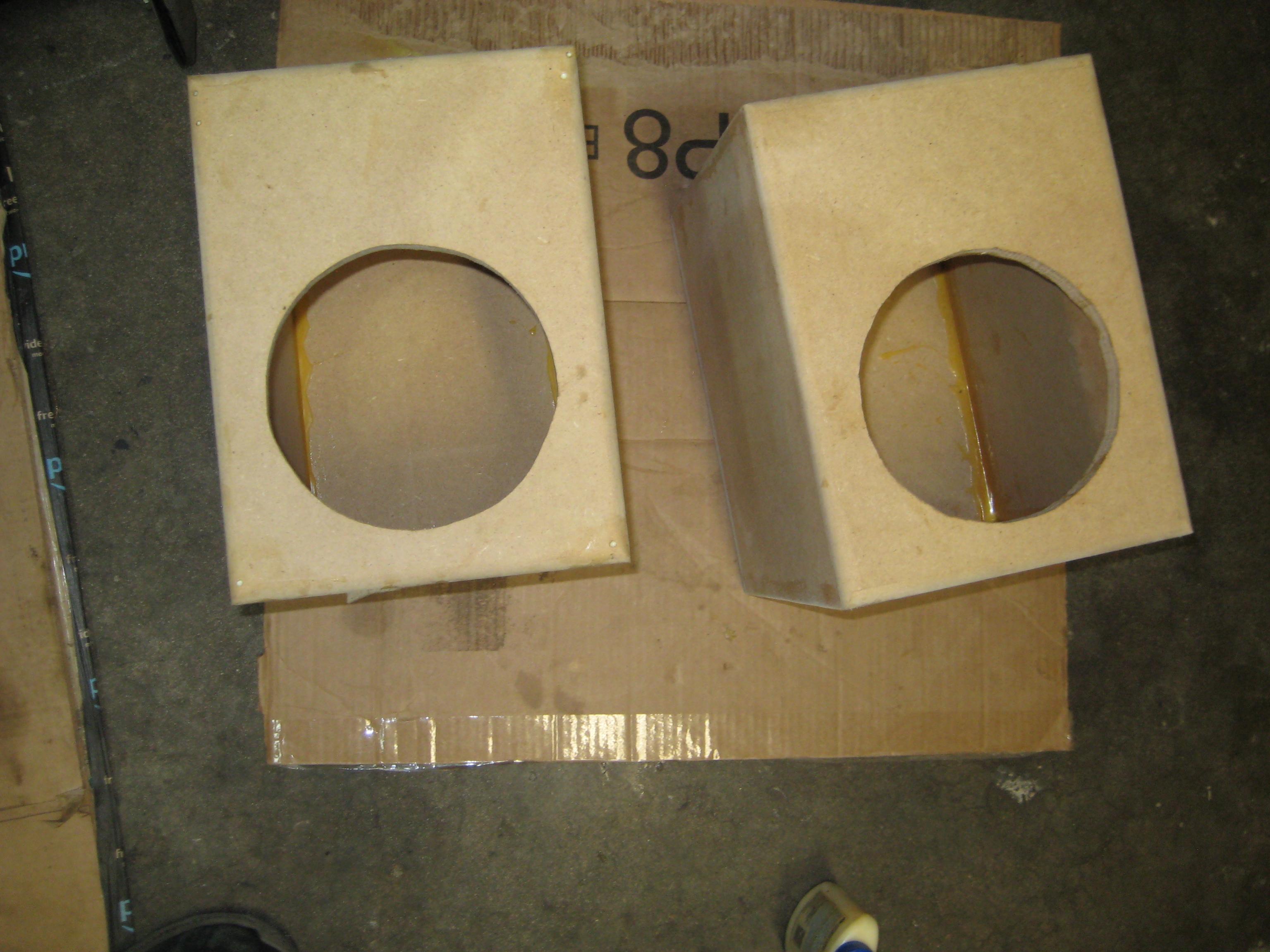

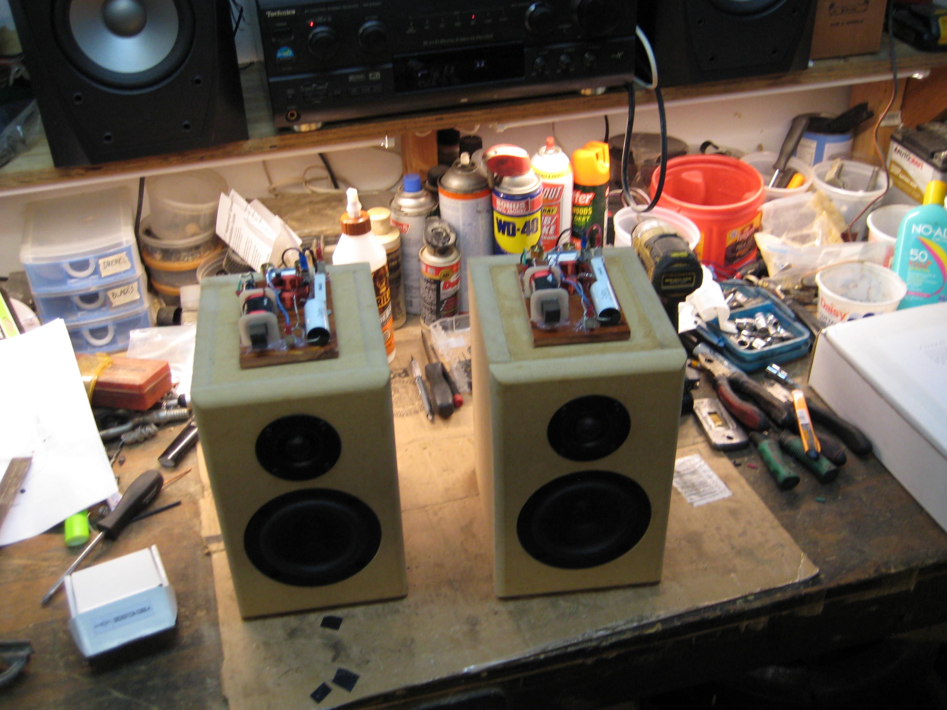

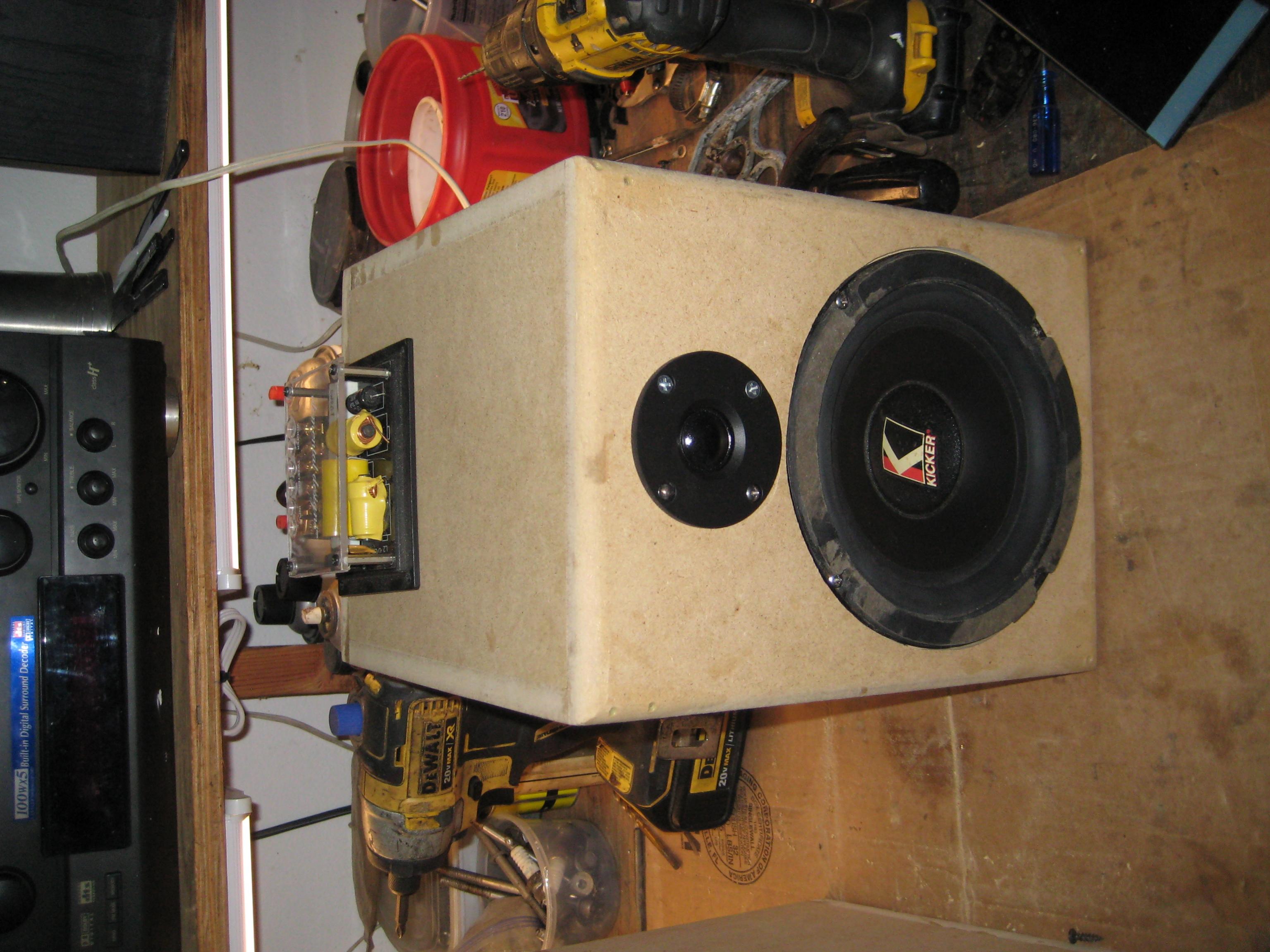

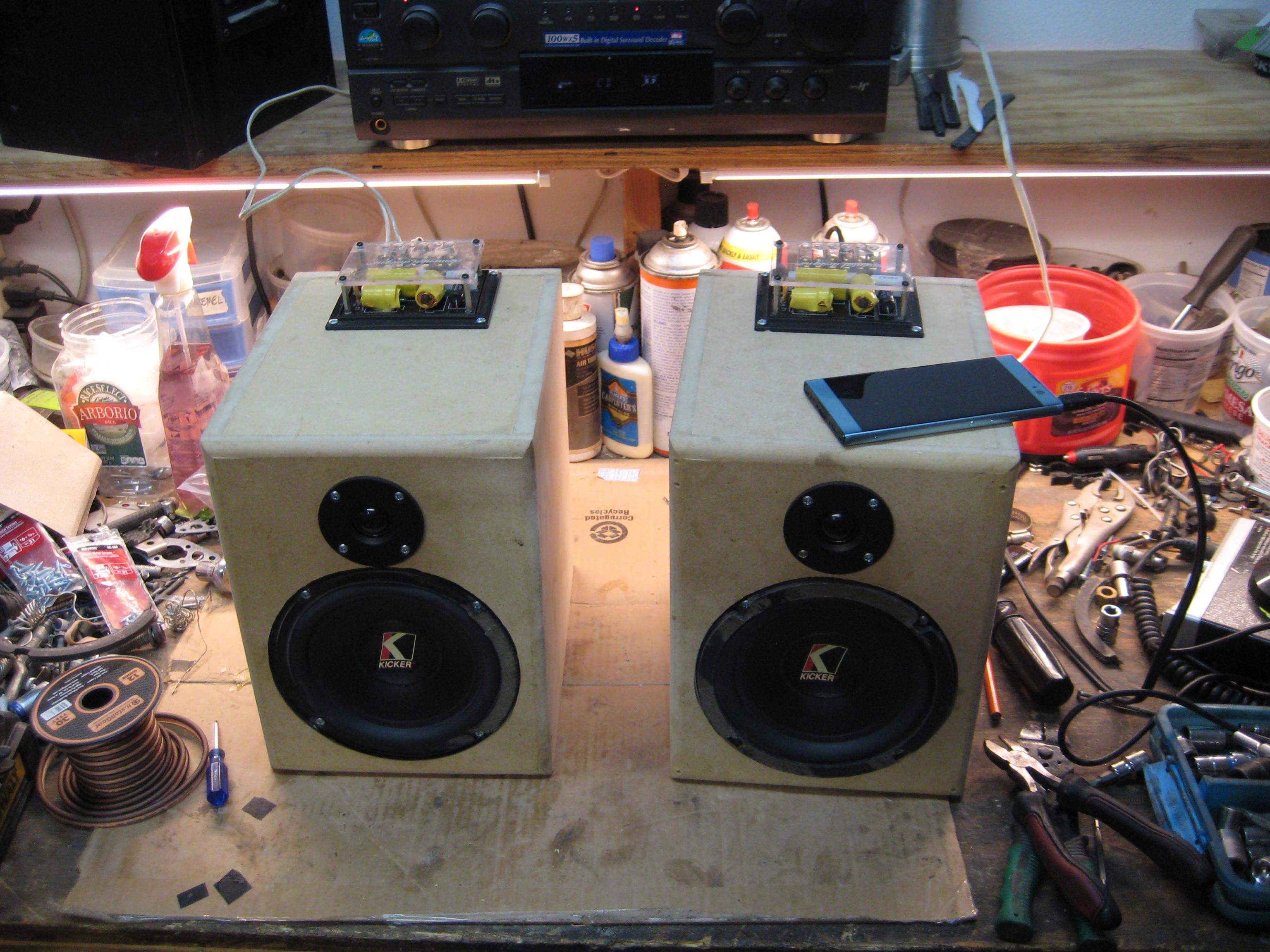

In the meantime, I got bored the other night, and made these. Really just for practice. Finally got the router out, and did this nice roundover. Im waiting on some router bits to come in so I can flush mount etc. This is the third set of speakers I've built and they've come along way, lol. Going to throw in some old Kicker Resolution mids, and some other random stuff laying around.

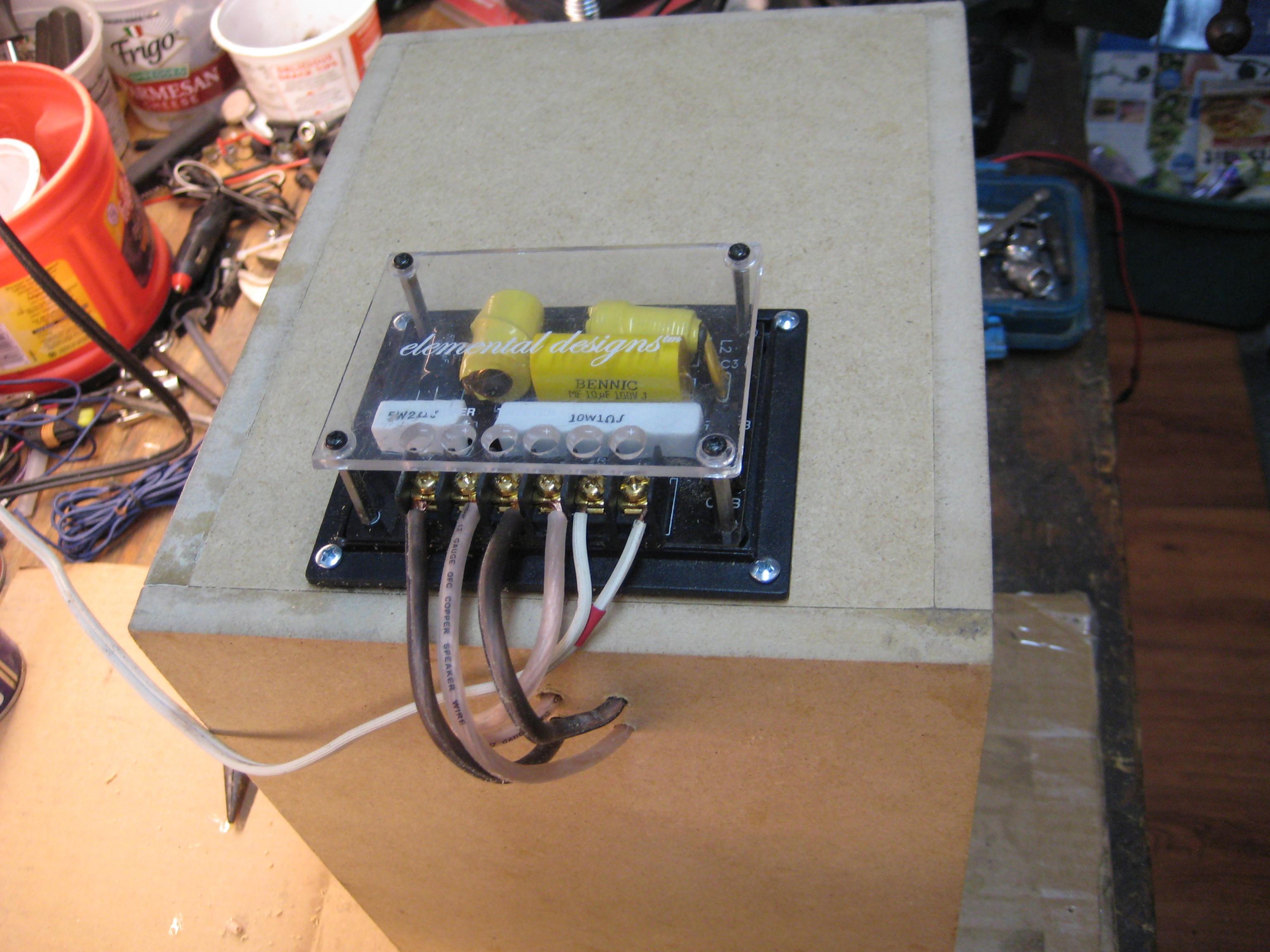

External crossovers

Hey, do you have a jasper jig for your router, or a home-brewed one for the speaker cut-out? Very handy.

I mean, who doesn't love external crossovers?

I did not have a Jasper Jig at the time I cut them, used a jig saw 😱 . Learning / practice was a big part of this build, and l have since learned about the Jasper Jig, ordered it, and received. Have not yet had the chance to try out, but I'm going to practice on some scraps this evening.

A little tricky to get the hole diameter exactly right. Make sure you read the directions very carefully. You'll probably want to have two router bits. One with at least 1/2" dia to cut the recess for the speaker frame, and another with a 1/4" dia to cut out the hole.
I don't own a 1/2 inch bit, the flush mount here was done with a rabbit bit. I've seen about both methods.
You don't have to have a 1/2" bit to cut the recess. You could also do it with two passes at different diameter settings with a 1/4" bit. The 1/2" bit just makes it easier to do in a single pass, and they are not that expensive.
Rabbet bits might not let you get to the exact diameter needed for a close fit of the speaker rim into the bezel. It just depends on what size bearings you have with the bit. You might have to leave a small gap. With the Jasper jig you can usually make it pretty tight.

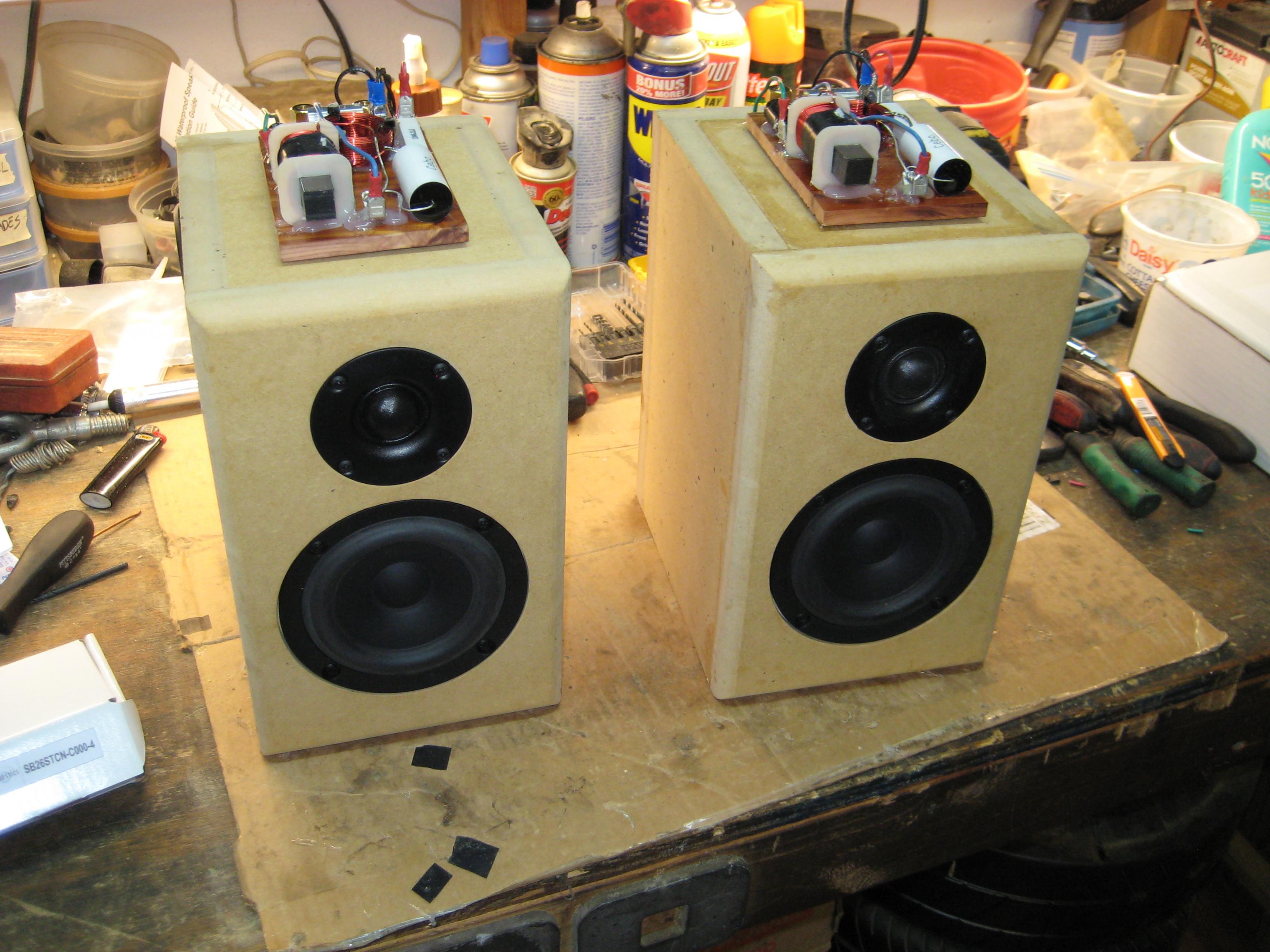

This turned out to be the winning comment. I have since purchased and built a pair of Sopranos. Listening to them for the first time right now, Pink Floyd. Im blown away. Really, thrilled!

I assume you are planning to just veneer the case and not the baffle. With the rounded over edges the baffle can't be veneered. It will have to be painted.
You can veneer the fronts if you use a steamer to heat/steam the veneers
Pretty easy if you have a handheld steamer, like the ones use for clothes
Might be doable if just the side edges of the baffle were rounded over. But with the top and bottom edges rounded over as well the four corners are going to be very difficult to get right.
Painting is a much better option for the baffle. Then the rest of the box can be either painted or veneered to match the baffle.
