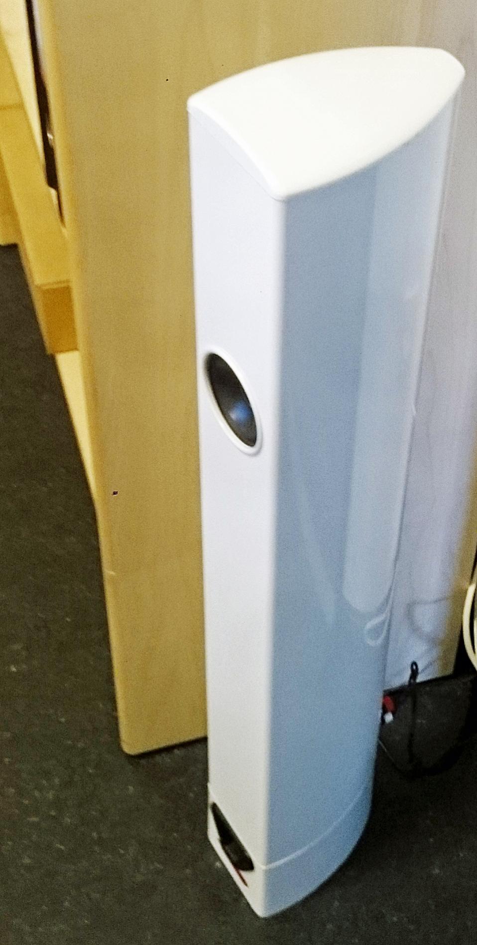

The commercial version of TABAQ has the shape you see in the picture. We found this had an advantage over the original design with straight walls.
Hi
Bjørn
