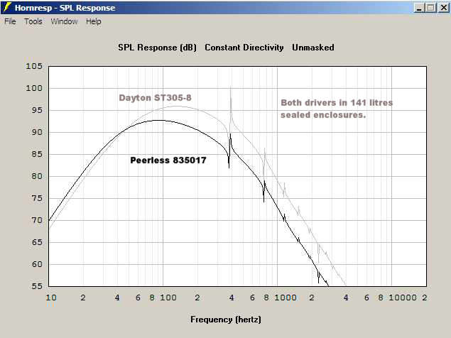

Just for the fun of it, a quick comparison between the Dayton ST305-8 and the Peerless 835017 in the same dual/sealed 141 litres box. With the additional bass boost the Peerless should provide excellent quality bass. The peak output of the Dayton is a bit high, it would have to be reduced to arrive at a level response.

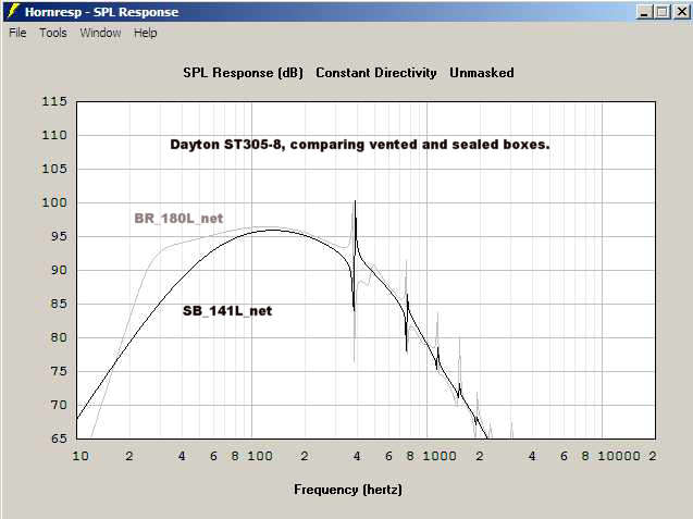

FWIW I'd recommend for best sound quality two separate boxes,
each with two drivers in force cancelling mode. Not necessarily
push/pull, but this can also be done if wanted.
Put the plate amp in one box, add a socket for the other box.
Place the subs somewhere between a 1/3 and a 1/4 along
the back wall and the same along the opposite side wall.
(Assuming they will not be moved out into the room.)
Something filtered at 100Hz has no speed whatsoever. To get that
is nearly all about integration to the mains + using a low Q sealed
alignment (especially as your adding some bass boost).
As excursion quadruples each octave you drop, and the loudness
curves add further excursion requirements, for very low bass the
important parameter (given others are OK) is volume displacement.
Cone area x excursion should be maximised - PA drivers are specifically
not designed to do this, its not in their proper job description, which
is maximising SPL in the power limited region, not the excursion region.
For going at very low bass sensitivity should be chosen such that the
amplifier power can max out the excursion at your chosen lf target.
Very likely this will not be the drivers thermal power handling.
Given the above, driver choice then depends on the box size chosen.
rgds, sreten.

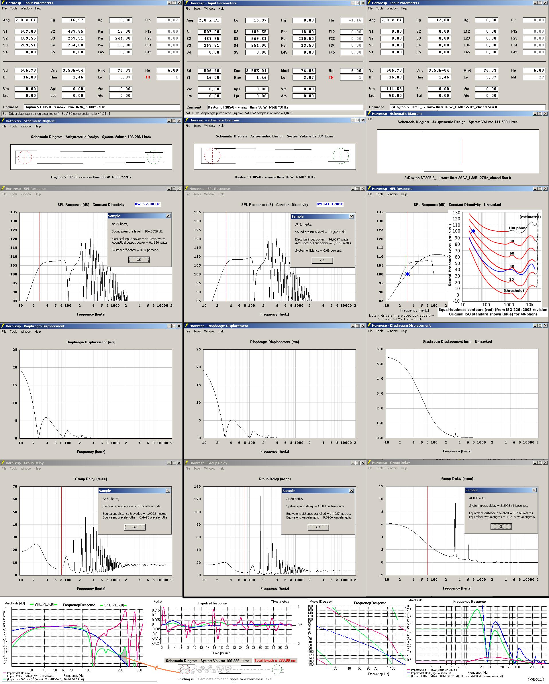

I think your choice of drivers is good., sreten made the consequences quite clear. Some of the parameters could been chosen differently:
That is if a smaller box with a lower cutoff frequency would be of more important than what your driver parameters implies.
My investigation of your driver choice point toward a Ported box,very large TH a T-TQWP or my own preference for a sub: a T-TQWT.
You probably know that a high Qm value is a measure of low mechanical losses,i.e. low stored energy.
Drivers with values above 10 are considered to be very good.
A push-pull arrangement of 4 drivers in a 10 cu.ft closed box(i.e. tinnitus choice of Qtc) is both level/distortion suppression-wise comparable with one in a ~3.75 cu.ft T-TQWT that is ~62% smaller than the closed one and ~ similar performance at ~30 Hz if tested in a very large room(high ceiling height) and away from room corners and other objects that could influence the FR.
IME If the subs are compared placed anywhere in an ordinary furnished room,the FR/impression performance of the T-TQWT would outperform the closed box.
The fact(IME) it's very insensitive for picking up any load influence that would change the sound character' as a big closed box and most other box types do.
A forth order BP box is an exception. Hint :Do a pressure source
to boundary interaction analysis.
See the picture:
