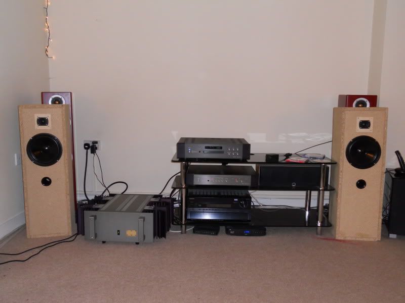

If yes; then I bought some as part of his speaker kit 3. I ditched the tweeters as they weren't to my taste and I'm now starting to put together a crossover to match them to some little truncated Vifa tweeters.
Sound wise for the money they are OK. I've not much experience with DIY speakers so this was a cheap way to fiddle about but they go loud, you can hear vocals clearly and they can generate some hefty bass. It had been years since I'd heard an 8 inch driver - last time was my old Heybrook HB1's).
I asked Willy what cabinet size to recommend and 35 to 55 litre in a ported design gives good results. I've thrown together some 35 lire test cabinets from old loftboards and I am quite fond of them.
The wife appeal of these is not so good and they can only come out at night when my wife has gone to bed so I've christenend them the Dracula.
Here's a picture of them singing their hearts out on the end of my mate's all Krell system. A real eye opener what £60 worth of parts can achieve.
