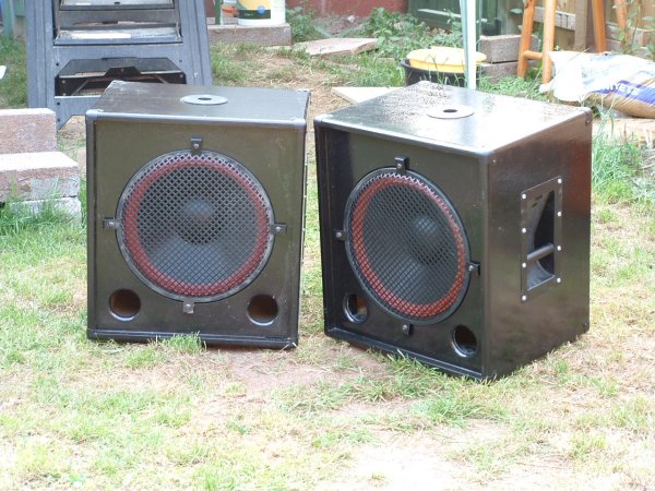

My overal project is a PA system for discos, this will consist of 4 vented sub enclosures with 15" subs and 4 flyers containing 1 12" mid-bass and 1 wide despersion horn tweeter. The subs will have a top-hat in the top and the flyers will have a top-hat in the bottom with a pole between them.
I will build 4 of these amps, two will run at 78-0-78dc and will power the 4 subs and two will run at 58-0-58dc and run the flyers.
The system will be bi-amped using the 2way LR crossover design on westcoastsound.
The speakers are sat in my shed at the moment having been roughed out, this weekend is sub finishing time!!
When all is finished I will post pics of the entire system, until then 3 more amps to be built and 2 more flyers.

I said that this weekend was Sub finishing time so here are half the results. Just need to add the hardware to the other two cases.
I know this isn't the forum for these , so I will start a new thread when all are finished .
Just a sneek preview.
