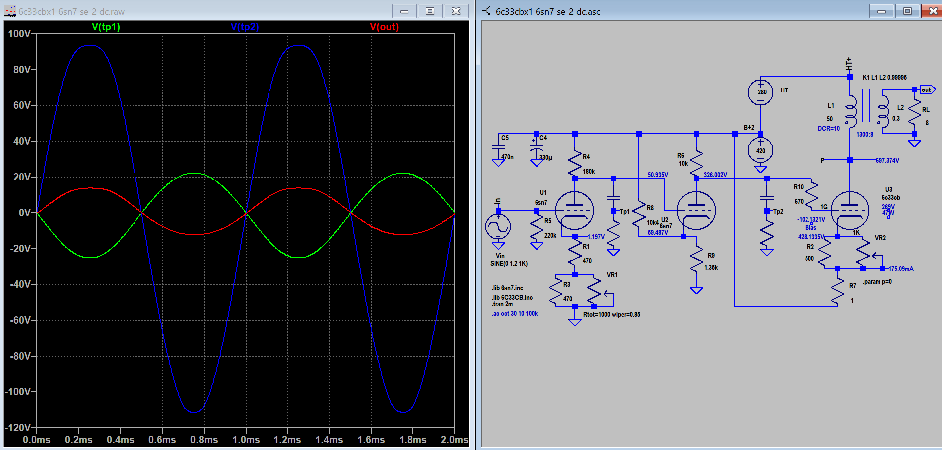

Have a look here! I spent a good bit of time optimizing my 6C33 design, you'll find few designs with such excellent measured performance:
Vervormingsarme 6C33 SE versterker! - Pagina 26 - forum.zelfbouwaudio.nl
