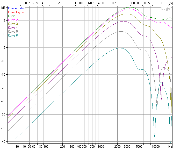

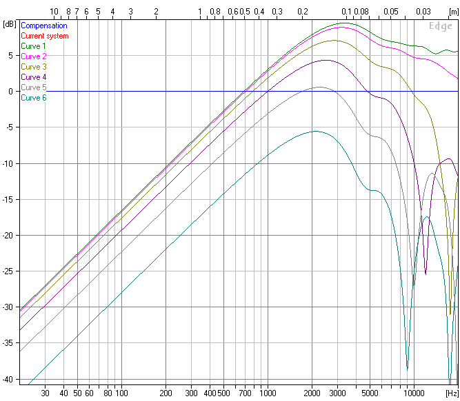

I won't claim my Edge model of the Neo3 is perfect. But a rectangular baffle the size of the Neo3 with a rectangular driver the size of the Neo3's holes should be close enough to capture the basic response. But the agreement of the model with both my measurements and wowo's is quite poor. The attached is with 3500 point sources and 15 degree separation between curves; I've taken it up to 16000 without seeing much change. So, while Edge has been found to be good at predicting the dipole peaks of nude woofers---and perhaps by extension the compact dynamic tweeters you've been studying---it seems there's things going on with the Neo3 that the source and edge diffraction model doesn't capture. That might imply a difference between a back wave and an edge source. Or perhaps it's just that a 3D model is required.
What did you use to generate the figures in the paper? From the look and feel I'd guess Edge.

I thought it had modeled the Neo3-PDR response fairly well (at least, to the extent of predicting the 7kHz on-axis dip). I think I'd used the dimensions of the inner 2 rows of holes as the 'driver' size, and the dimensions of the Neo3 as the 'baffle'. Did you try that too by any chance? I don't think I have the graphs saved.

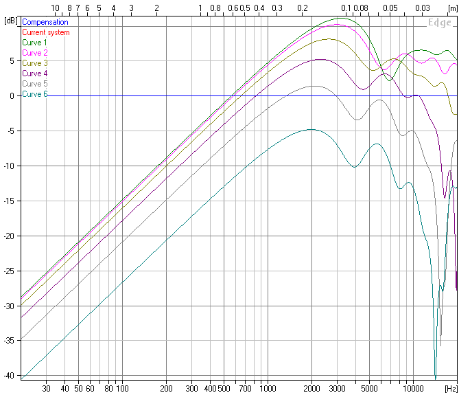

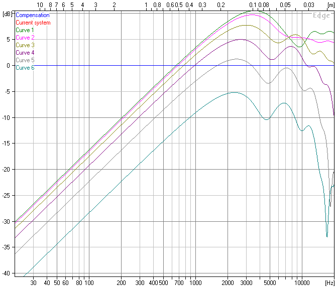

No, but it's quick to generate the data. 😛 Center two columns is a better approximation for the non-PDR, which might suggest even without the PDR foam most of the SPL comes from the middle of the diaphragm. Seems sensible enough, but the model's still poor (left attachment). Excluding the top and bottom row and taking only the center six openings improves the accuracy somewhat (right attachment), which supports the hypothesis. One could probably tinker around with the source distribution and shape and eventually get a reasonable approximation of measured results above the influence of the Neo3's Fs, which seems to be about 650Hz and fairly high Qts. However, I'm unsure how one would determine what to simulate a priori of measurements.
If BG Radia ever calls me back I'll have some more informed questions to ask, though.
In the introduction to my paper I caution that all sims are for pistonic drivers only. And I explain why I don't want to simulate for real world drivers.
The Neo3 MUST move more in the middle than at the four sides. So you have to assume a smaller radiating area. Apart from that: Did you look at the 11 mm depth of the housing? You need to add at least 5 mm width to each of the four sides of the Neo3 to account for the missing depth of the model.
I could easily accept that my models are not refined enough to do full justice to real world drivers. But you will have a hard time to convince me that a back wave and an edge source follow different physics. 😉
If we really want to know we need to resort to some sort of FEM analysis - 3D alone won't suffice imho.

It's not clear to me the Neo3 diaphragm is secured on all four sides; the long sides are hidden behind bar magnets. So one would either have to find out from BG Radia or crack one open. My non-PDR 3Ws are in active use, so I'm not about to drill out the rivets.
Similarly, I'm unsure there's an open and shut case for depth accounting. Saurav's link above mentions greater than 11mm increases in width but the source configuration is unclear. For the woofers I've run dipole Edge has predicted the dipole peak within the limits of measurement precision without an allowance being made for the thickness of the mounting flange. Which, in some cases, is up to 8mm. The woofers are, of course, bigger than the Neo3. So errors from incorrect depth allowances will be smaller and harder to detect.

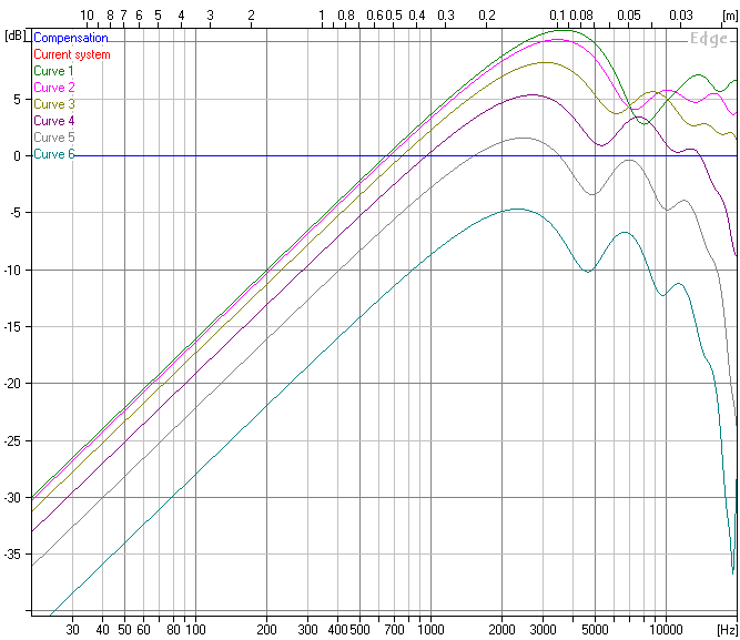

The figures above are based on the physical measurements of my 3Ws and don't add any baffle extent for depth. The figure below uses the center six openings and a baffle expanded by 5.5mm on each side to account for depth. It's different from the others but I can't say I see it being in better agreement with measurement.
See, to me, that seems to match my Neo3 PDR measurements fairly well, once you account for non-linearities in the driver's basic response. Here's the most recent measurement I could find:
HTGuide Forum - View Single Post - Getting back to my OB design...
Last image in that post. The image is fairly jumbled in the range of interest, but you can see that the on-axis plot has the deepest null at ~7Khz (purple), while the off-axis curves don't have that null. Also, the peak is at ~3kHz. For my measurements the Neo3 is mounted on top of an 8" wide baffle, so that will skew the results.
Another thing I thought of - for the PDR, I think the effect of the felt along the outer edges would be to narrow the radiating area for the higher frequencies, but not for the lower frequencies. While I'm pretty sure EDGE models driver directivity at some level, I don't think it can directly model that. So one would have to map out both driver diameters, then blend the responses over some frequency range.
And by that point it's easier to just measure 🙂
