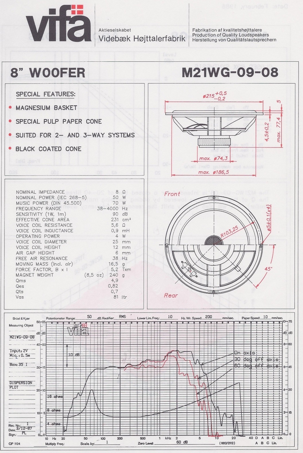

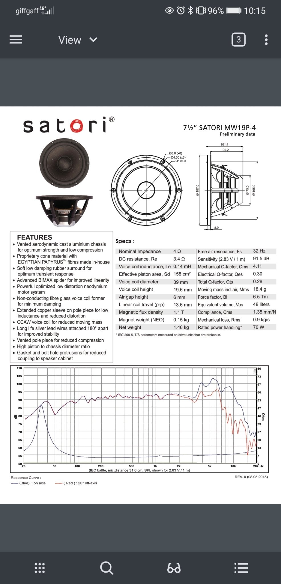

I've been looking into the spec of the original Vifa 8" midbass drivers vs 7.5" SB Satori items and the Satori's seem to better the Vifas in every respect, they also appear (on paper, at least) to be better suited to the 45L cabinets.
The Satori drivers remove the upper mid lift of the Vifas and perform better off-axis, they are also 1.5dB more efficient!
Other than the need for an adaptor ring to mount them, what have I missed?

I've been very pleased with the Satori drivers in my Sonabs, so I do want to use those.
I'm really just looking for a sanity check that the above drivers are suitable or not
Qts = much lower
Vas = much lower, and sensibly just greater than the cab volume.
Efficiency = higher
Response = flatter/ better off axis
What have I missed?
Qts = much lower
Efficiency = higher
What have I missed?

The vifa driver info in the first post and also the link from from Mototok are for the the same driver.
Which as Willys Hifi states as being suitable for the Snell K. Which makes me wonder what is the right driver for the Snell J series of speakers. If they were a second hand buy maybe somebody has replaced the original item ?

Looks like no changes are necessary (unless I've missed something).
The Satori can hold itself together both lower and higher than the Vifa, and off axis. It appears to be good up to 3kHz!

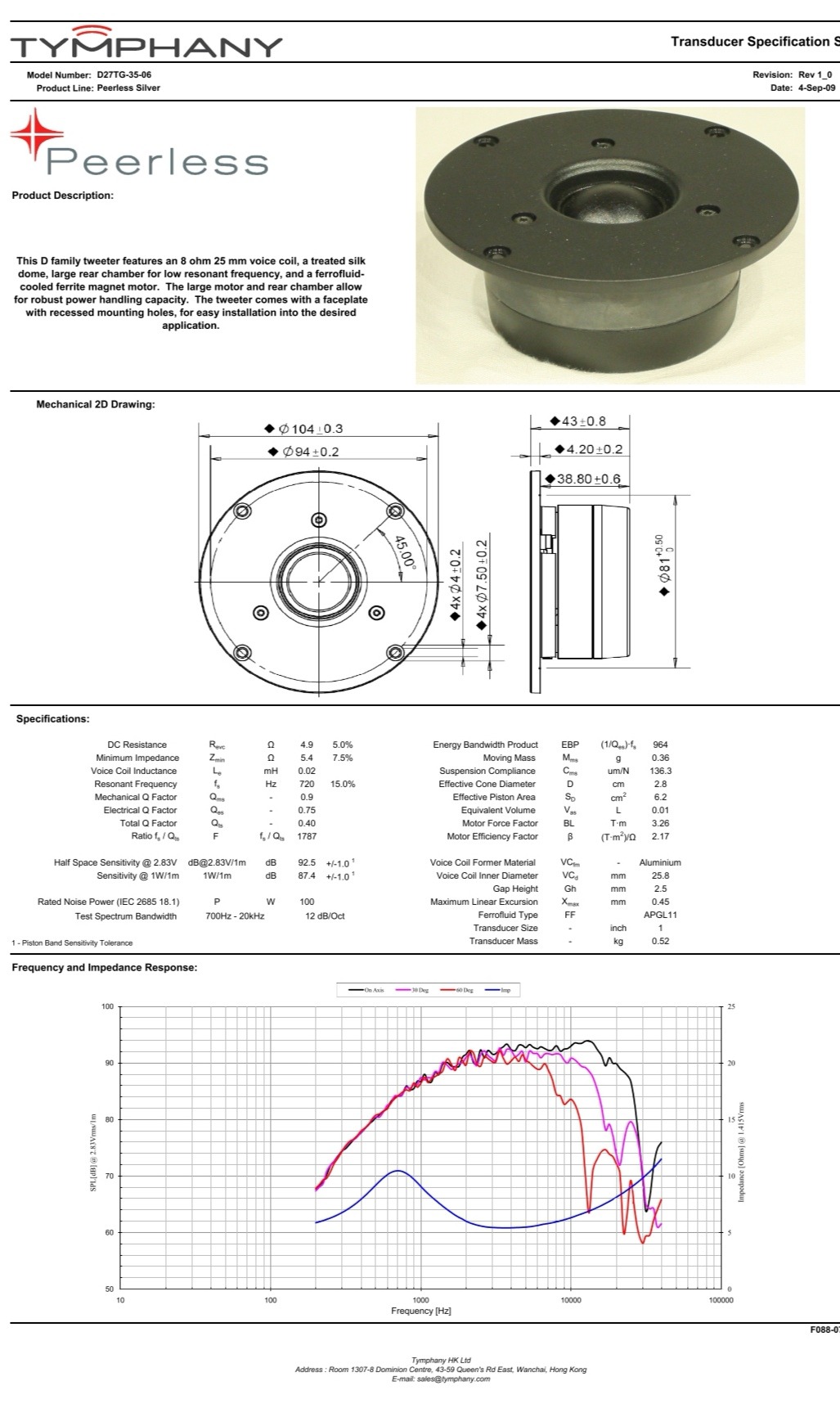

The tweeters have 94C7ODS written on their backs
Cabs are 13"x 9.25"x 23". Likely 0.5" or 10mm chipboard.
That's a vintage Seas woofer that I can't find the datasheet for, and the tweeter is apparently made by Tonnegan; again no specs.

Your tweeters are not Vifa as per your sticker.
Does the branding mean anything? Vifa/ Seas, Tonegen/ Peerless. They appear (to my eyes) to be identical, did they not all come from the same factory?
Yes, of course. However, I'm not thinking about changing the tweeters. It's the Seas/ Vifa mid-bass driver that I'm proposing can be bettered by a modern design (the 7.5" Satori).

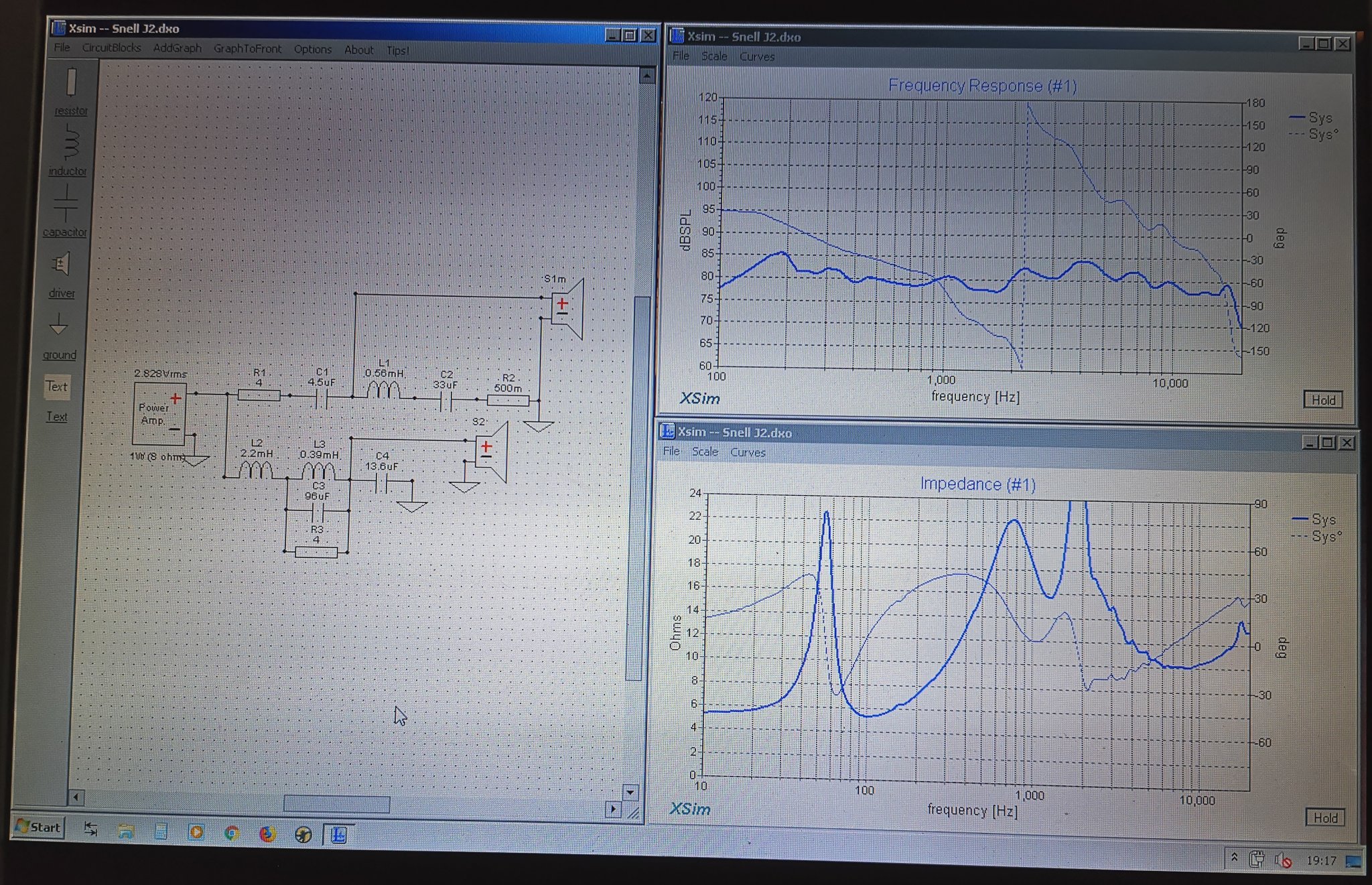

The Xsim info is that that you have posted, is that using the existing Xover or is it your design and you have imported the frd and zma files from manufacturers data sheet or measurement's.
Out of interest what is the impedance of your original woofer when you measure it with a DVM an 8 ohm unit may indicate between 5- 8 ohms a 4 ohm unit maybe 3 - 5 ohms
In terms of the frequency response the tweeter output shown looks a little high, and the impedance peak at 2Khz looks strange to me.
The frequency bump at 3Khz may well be another audible issue.
