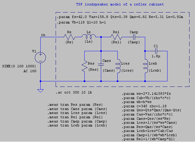

It just hit me today because of another post on another thread that the part or the voice coil in the gap is the motor in a model and the part of the voice coil not in the gap is an inductor. The voice coil not in the gap does not produce significant back EMF. Because no back EMF is produced that part of the voice coil is an inductor in the model and not part of the reflected impedance
My understanding is that the inductance of the voice coil is that of the complete coil, both the "air cored" parts outside the gap and the "iron cored" part inside the gap. (Think of a driver with the voice coil glued into the gap.) The back EMF is a separate entity, generated from movement of the coil in the gap, which is in turn influenced by the driven mass, compliance etc.
I've seen it argued that a driver can't be accurately (SPICE) modeled because it doesn't allow for external influences on the driver - for example, reflections from the walls of an enclosure making the diaphragm move, generating an EMF. In fact, these can be modeled with delays and filters. Other non-correlated influences, such as environmental noise, can be modeled with voltage sources. It depends on how accurate you want the model to be.

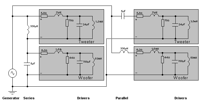

In August 2005 I had sat down and modeled the voice coil as a transformer with shorted secondary windings with leakage induction (the part not in the gap, more precisely the part that is not fully coupled to the rest of the transformer etc..) I had written a lengthy document on this and posted and uploaded this to a couple of audio forum sites at that time.
The document is still available from here:
http://members.fortunecity.com/pirimoglu/
(Click on the link "Faraday (shorting) rings and their effect on voice coil impedance and benefits in terms of reduction of nonlinearities"...)
As far as I know, this was a novel idea (at least for me) at the time, had not seen anywhere before used this way: to model the loudspeaker motor as a transformer with leakage inductance etc. that accounts for eddy currents and if used shorting rings.
Coming back to context of the thread, in the SPICe models, the inductance part of the loudpspeaker can be changed into three mutually coupled inductors (3 windings of transformer) with two windings having a resistance shorting them, and having less than a coupling ratio of 1, and the effects off loss inductance of real loudspeakers can be simulated in SPICE.
Towards the end of the document I mentioned above I give examples of these in SPICE and how they can be used to model real world inductance of loudspeakers.
Attach is a screen shot from a page from the document, Lvc3 is the voice coild inductance in free air, Lsr3 is shorting rings inductance, Lpole3 is pole and other surrunding iron's inductance to account for eddy currents. Rsr3 is the resistance of shorting ring and Rpole3 is representative of the resistance of the eddy currents on iron parts. K30, K31 and K32 are the coupling ratios used. To find the correct values for all these parameters for a real loudspeaker, a curve fitting needs to be done between calculated and measured impedance.
This model doesn't take into account "skin effect".
