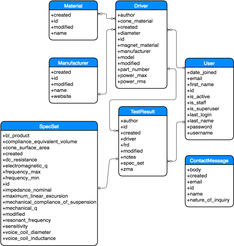

I'd like to start a discussion on creating an open-source driver database that exposes a public RESTful API. My primary reasons for doing so are:
  • Platform-specific native apps raise the barrier to entry for users and developers
  • Madisound and PE each provide different search interfaces with different functionality, and hopping between them is inefficient and insufficient
  • A system that allowed users to compare manufacturer specs to user specs(derived from tests) would be useful
  • I would find such a tool useful, and am willing to build it
I have quite a bit of experience with Python(Django) and JavaScript(Angular, Backbone, D3) and need something new to work on. My initial ideas are to have a web-based API, a web client and a CLI client that presents data models including Driver, Manufacturer and Spec. All code would be public available as Github repos.
With that said, I'm all ears for user feedback.

Thanks for the feedback, Neil. You and Ron have been in this game wayyy longer than me, and it's great to get your perspectives.
Getting other developers on the bandwagon is definitely one of my goals here. There are a lot of disparate speakers resources scattered around the web, many of which are outdated or require a very specific operating system to function. Each resources that embeds its own database is ripe for inconsistencies with other similar resources.
I'd like to come at this from a microservices point of view. Box modeling and crossover design software both need driver data, so to me it makes sense to start there. With a driver database service that does one job and does it well, it can act as a foundation for other services via integration. I think this approach also aids in the viability of the project.
Good point on including the FRD and ZMA files in addition to standard parameters. Advanced search functionality coupled with having all three pieces (params, FRD and ZMA) in one place for each driver would be very valuable, imo.
I came across PSD-Lite last year when I first jumped in, but I haven't had a chance to play with it because I don't have a Windows installed anywhere, or Excel. I'm on a Mac at work and run Ubuntu at home, which is also part of my motivation for this undertaking.

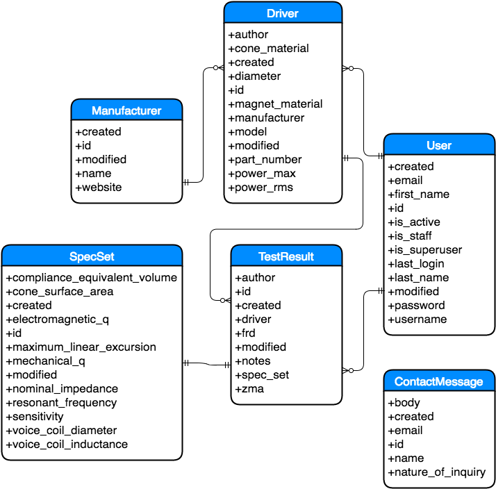

Thanks for the guidance, and I'll start reading the "Measured T/S Parameter Thread Sticky" thread soon enough. As for open sourcing your work, let's chat about that once a database is up and running 😉 I'm going on vacation soon, but I'll update this thread once I have made some progress with planning.
Hmmm the image URL in my post is having errors, so I've gone ahead and attached the image to this post.

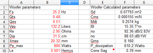

In the picture are the parameters I use...
This is the minimum set useful, IMO. Many drivers do not come with Qes, Qms values and a method to enter these drivers would be useful. I just used Qts and Qes, but you could use Qts and Qms - fairly simple to just guess a value for Qes or Qms and it doesn't affect calculations a huge amount, as Qts is the most important parameter.
ignore pdissipation as that depends on a user input for power.

Attached is the updated ERD. I've expanded the fields contained in SpecSet considerably, and also added a Material model.
What do the following from your attachment represent?
  • Pe_max
  • Mdt
